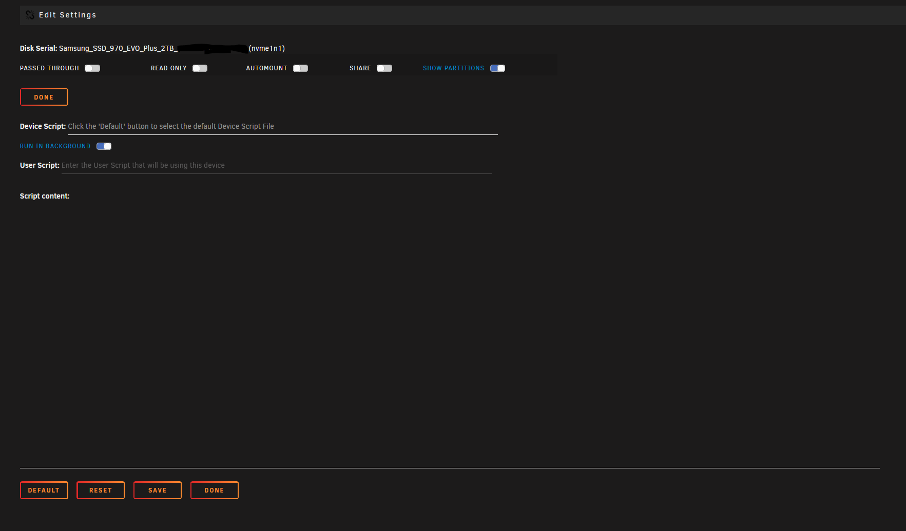

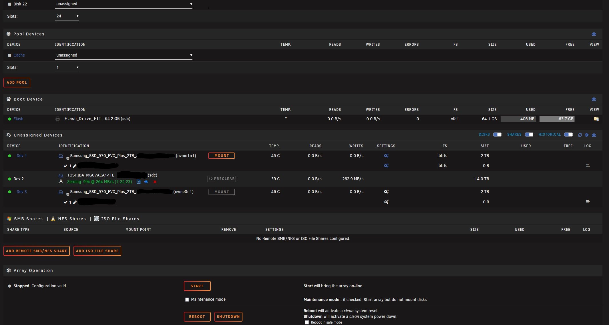

January 12, 20224 yr I have just installed a new hard drive which is currently running a preclear operation and a second samsung 970 evo plus 2tb nvme for extra nvme space. So i added the new nvme drive to my cache pool and realised it was set to raid1 when i did that. I stopped the array and removed the the new nvme drive from the cache pool and restarted the array with the new nvme drive unassigned. Then i started getting error messages about the docker.img file, stopped the array and changed the number of devices in the pool back to 1, started array again and now docker won't start. When array is running the original nvme drive now says: cache Unmountable: not mounted. I have tried clicking on mount but it doesn't seem to help when array is stopped. Assigning the drive and starting array made no difference. What should i do?

January 12, 20224 yr Community Expert When the second device was first added filesystem crashed and went read-only, that would be a good time to make a backup if one didn't exist, since the device never finished adding pool is now in a messy state, there are some recovery options you can try here.
January 12, 20224 yr Author 38 minutes ago, JorgeB said: When the second device was first added filesystem crashed and went read-only, that would be a good time to make a backup if one didn't exist, since the device never finished adding pool is now in a messy state, there are some recovery options you can try here. With the first option i get this with the array stopped: wrong fs type, bad option, bad superblock on /dev/nvme1n1, missing codepage or helper program, or other error. What about these options? :
January 13, 20224 yr Community Expert 11 hours ago, Reva said: /dev/nvme1n1 You didn't specify the partition, it needs to be /dev/nvme1n1p1 11 hours ago, Reva said: What about these options? : These are irrelevant for recovery.
