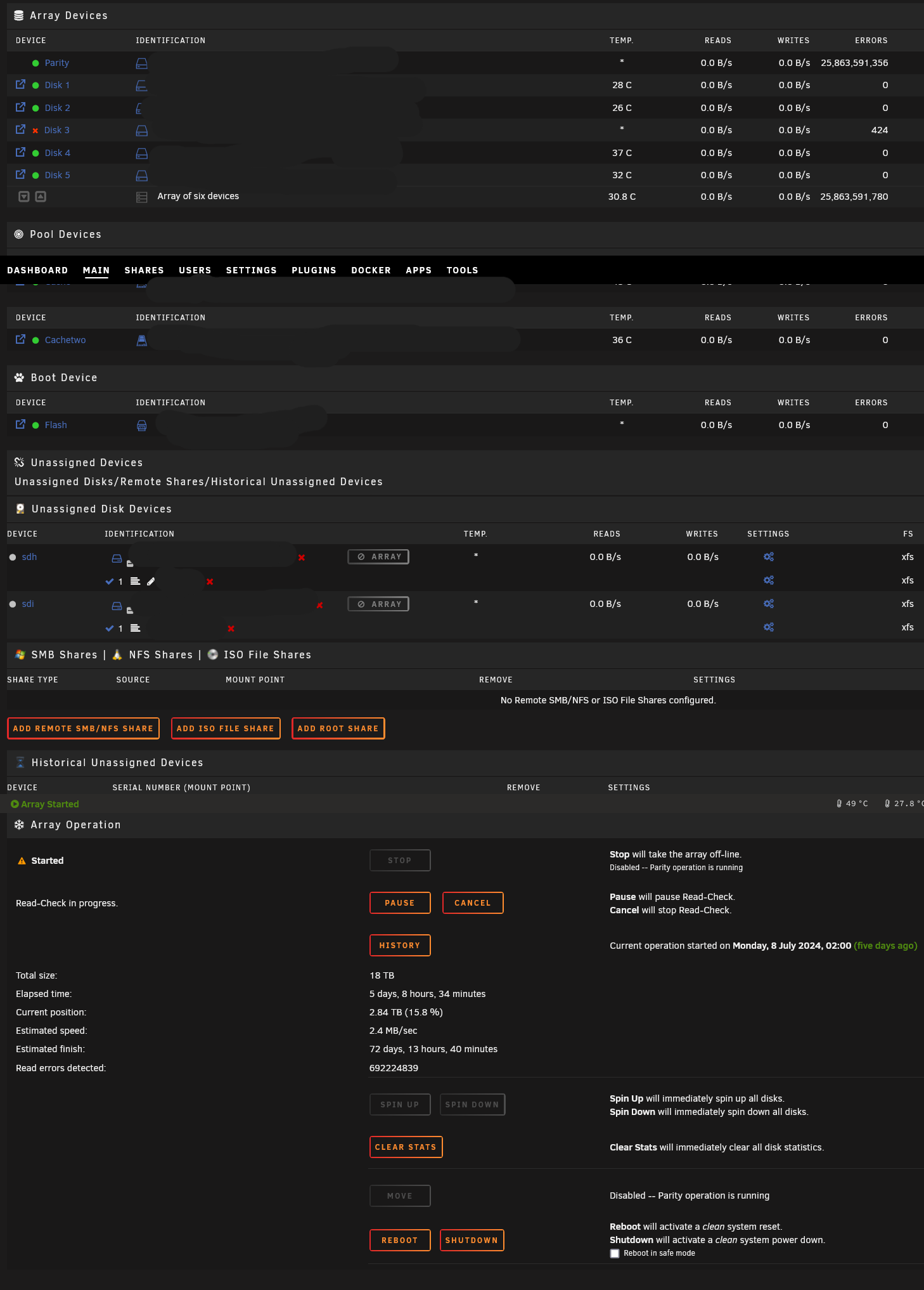

  1. Ok, that's unfortunate. Is there no way to kill the read-check process?
  2. By force do you mean I have to press the power button? I tried reboot -f but it seems to have no effect.
  3. The syslog is empty so nothing was copied. And the reboot command doesn't seem to have any effect. Would "/sbin/shutdown -r now" or something similar work?
  4. I have tried to download the diagnostics but the download will not finish, along with many other problems. I was running a parity check when there were two notification that an array disk was in error state and that it had read errors. 15 minutes later I got "Array has 2 disks with read errors" and that was the parity disk. They are both in the array in the picture but now also under unassigned devices. Since then the read-check is frozen and there have been other issues due to that. The restart button doesnt restart the server and I also cannot cancel or pause the read-check. I don't have physical access to the server to reboot it. Some containers won't stop and as mentioned the download of diagnostics won't finish. Something similar has happened to the server before and it was caused by a loose cable which I'm pretty sure is the case again. I'm thinking that I need to force cancel the read-check somehow in order to be able to restart the server. Is there a command to do that? Also, most containers could be stopped but a few won't even stop with the kill command.

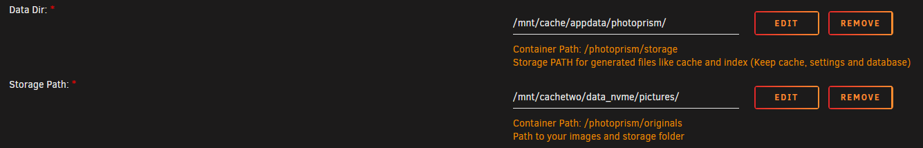

  8. I tested it out with a few files and it seems to be working perfectly. Thanks a lot!
  9. Oh i see. I'll stick with "/mnt/cachetwo/data_nvme/photoprism/" then! I've seen that thread as well as this one but i don't really know i i understand it correctly. Let's say i want to ignore folder "abc", folder "abc123" as well as all raw, tiff and dng files in all folders. Can i do that with one ppignore file in the originals folder? So i create a text file called 1.ppignore and add these lines: abc abc123 *.arw *.tif *.dng Would this work?
  10. Thank you but i meant that i only want the cache files in "/mnt/cachetwo/data_nvme/photoprism/", and the config files/settings in "/mnt/cache/appdata/photoprism/". But i guess i can back up those files separately and now the appdata folder won't have all those images so i'm happy with this. I do have one other problem though. My "originals folder" contains 10 folders, and 2 of those i want photoprism to completely ignore. What's the easiest and most reliable way to do that?

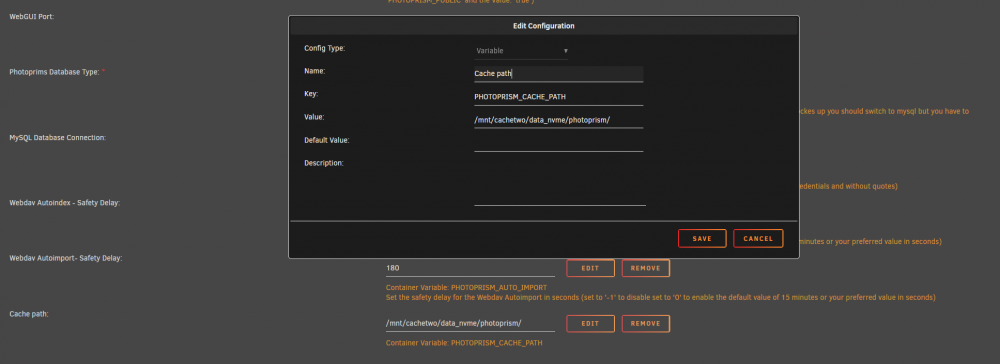

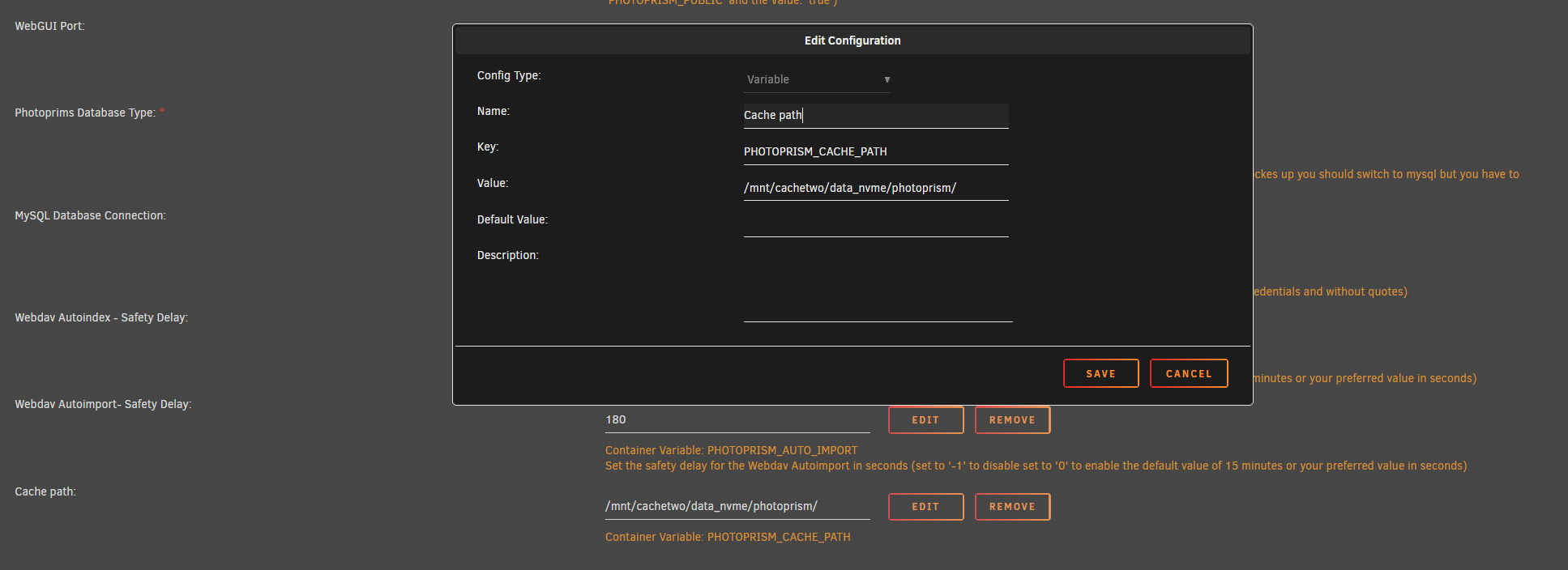

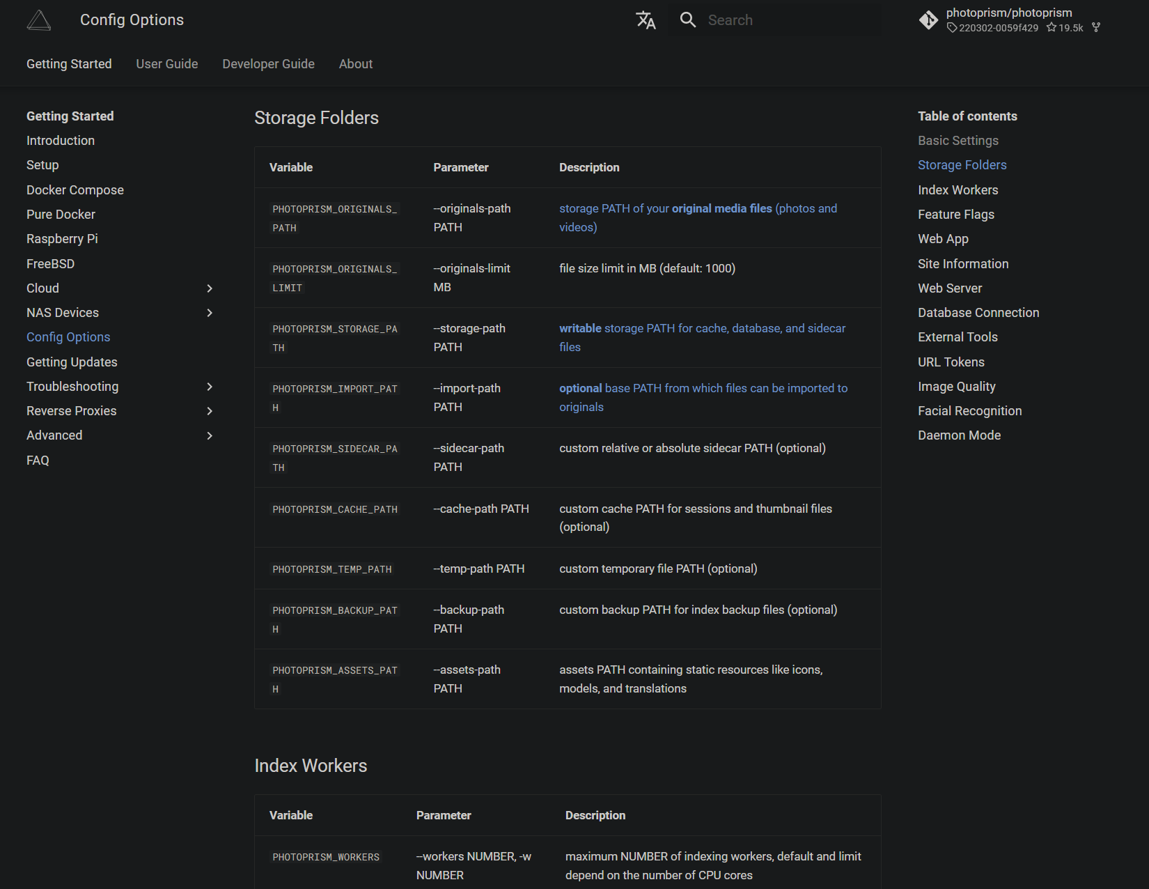

  11. Hi! I need help with path mappings for photoprism. I'm trying to set it up so that the thumbnails are stored at /mnt/cachetwo/data_nvme/photoprism/ and the config files and settings at /mnt/cache/appdata/photoprism/. I found this page (screenshot) and this thread: https://issuehunt.io/r/photoprism/photoprism/issues/1124 but when i try it the webui becomes inaccessible. The log closes itself every few seconds but the error is: level=fatal msg="cannot create /mnt/cachetwo/data_nvme/photoprism, check config and permissions"
  12. Paths look like this:

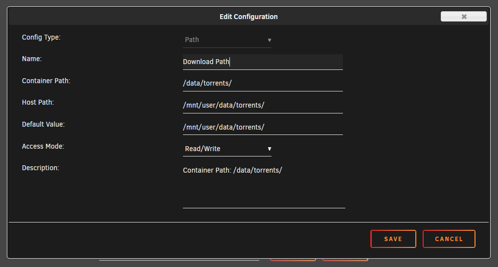

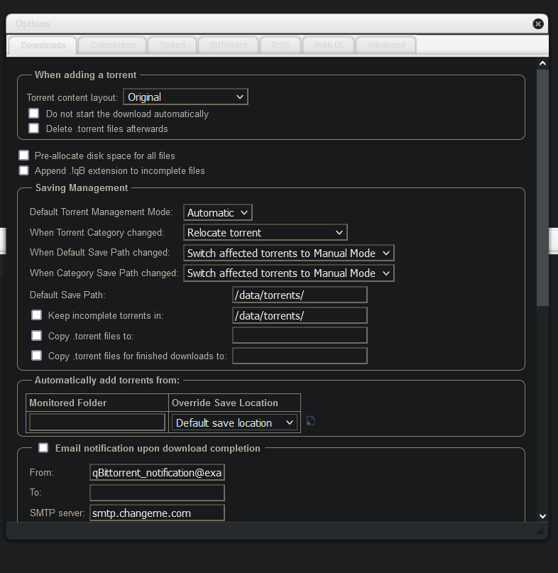

  13. Hi! Every torrent i add to qbittorrent gets status "errored" or "stalled" as soon as they get added. What could be causing this, maybe some permissions issue? The ip looks right. Edit: I am also having troubles with the categories. Whatever path i put in doesn't seem to get saved when i add or edit the categories.

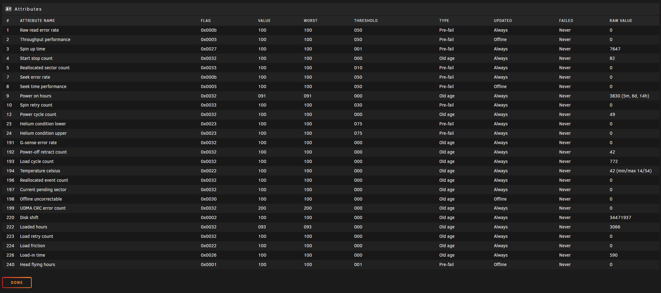

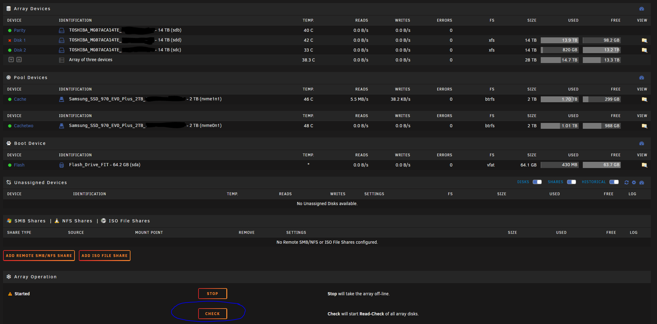

  14. Finished the rebuild and everything looks to be in order again. If it happens again I'll be switching out the cables. Thanks for the help!
  15. I shut the server down, checked the cables and started it again. The SMART data attributes look good, i think, and it says SMART overall-health:Passed. I also got a notification saying "array turned good" and it now shows 0 errors in the main tab. What do i do now? With the array started the disk is still disabled, do i have to initiate a rebuild to get the data back? Or should i start a "Check" as seen in the second image?
