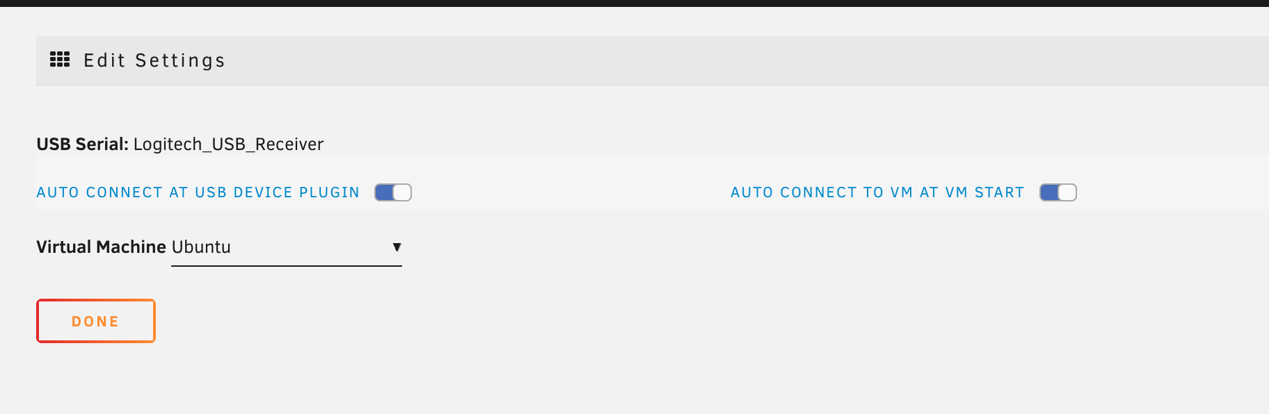

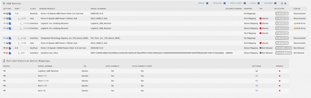

Hi @Ainsley
How are you mapping the devices in USB Manager. Could you post your diagnostics so I can have a look.
Also a screen shot of USB Manager,
Edited by SimonF

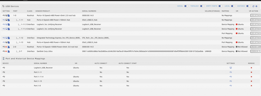

2 hours ago, Ainsley said:
Thanks for getting back to me so quickly.
Looks like the diagnostics is after the reboot so cannot see any messages for Mapping USB devices etc. So when you have started VM can you provide syslogs for the rc.usb_manager events or just the whole syslog if that is easier.
I think the issue is that the Serial numbers are identical and that is my key. Setting both to port may help but I think I may need to look at a fix for the status.
I suggest using the XML option for now if the port processing doesnt work. But as I am now picking up devices mapped outside of USB Manager it may show both connected but one as outside of my plugin.
Screen shot after the VM has been started would be useful.
Edited by SimonF

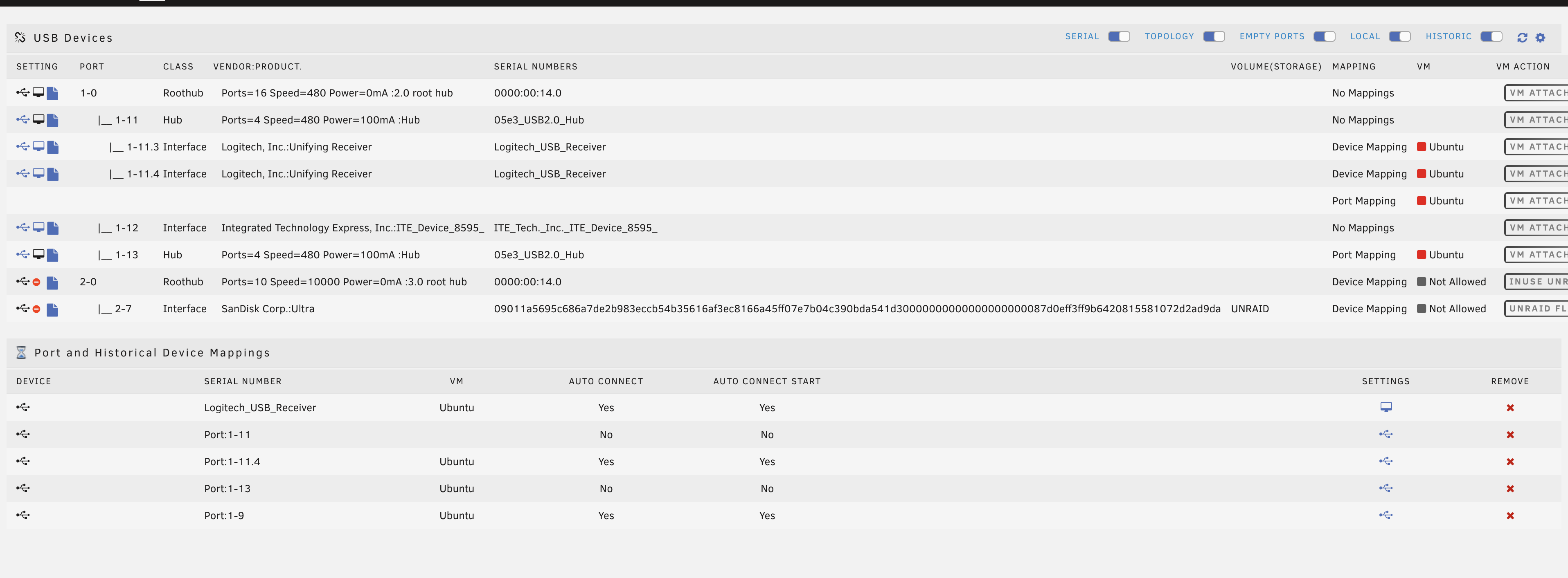

I have atatched diagnostics & screenshot below.
I have found two mice that have the same serial number so can replicate. If you enable hub process in settings and remove the mappings for the ports and add a port mapping for your hub on 1-11 that may also fix your issue in the short term.
Edited by SimonF

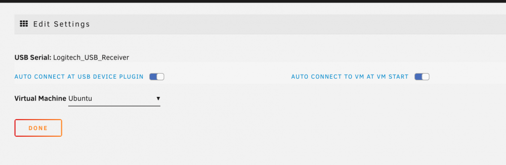

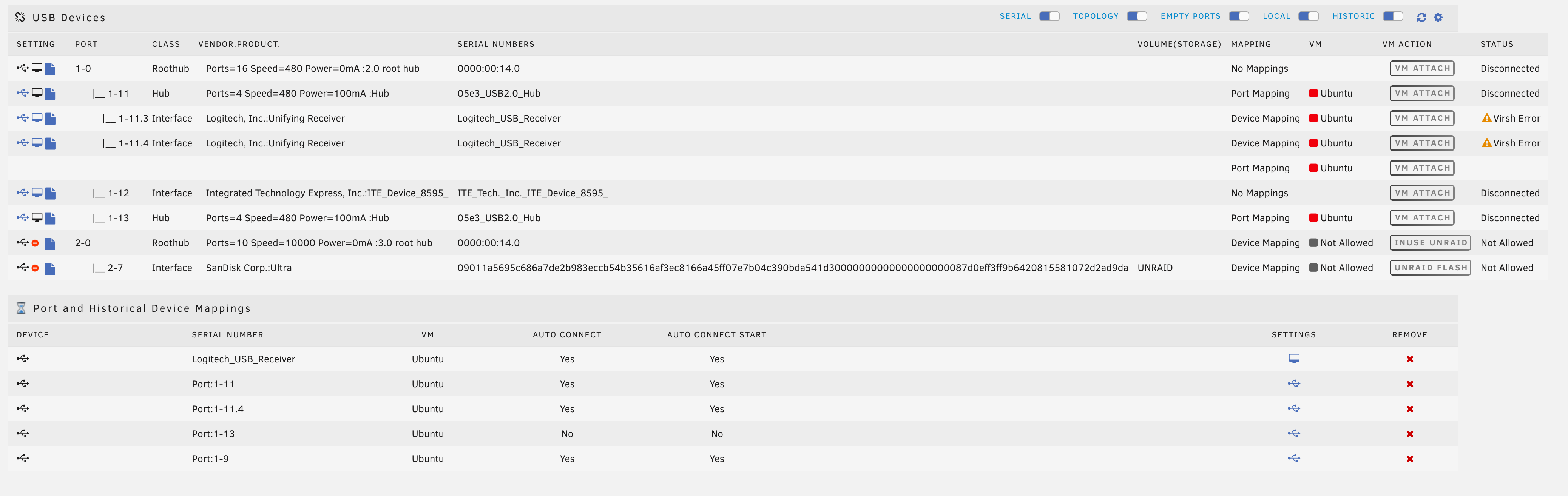

Hi @SimonF
Thanks for your support.
It seems the mouse works out of the box when booting the VM. But I have to go and manually disconnect the ports and attach them again so that I am able to use the keyboard. I guess it doesn't help with the serials being exactly the same as they are both by Logitech. Somtimes I get a virsh error when trying to attach.
Would you be able to provide how I can add a port mapping? Not so sure what you mean there.
I have attached update screenshots, diagnostics and system log.
tower-diagnostics-20220115-1345.zip tower-syslog-20220115-1346.zip
If it has the name of the device it is a device mapping as per the edit settings you have attached. If you have the device defined in the XML the plugin will not be able to map hence the maybe virsh error.  but if you hover over it will show the error.
Delete the device mapping in the historical settings by the red X for the device. A Device mappings are setup via the terminal icon and port mapping by the usb icon.

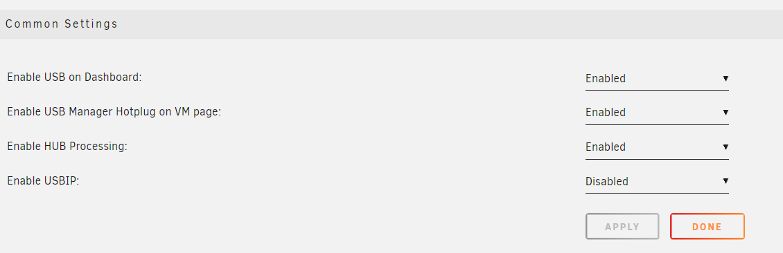

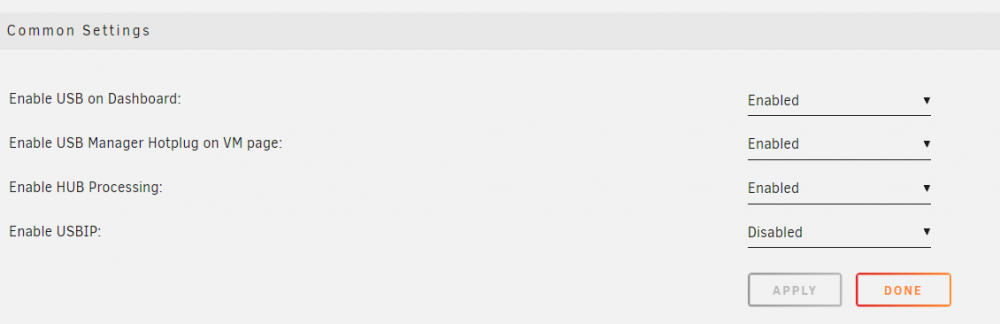

Goto settings and enable HUB processing. if you haven't already.
With hub process you should only need a single port 1-11 defined, So also delete the 1-11.4 port mapping also.
Make sure to enable the Auto connect options on the port 1-11 mapping.
See if this works.
