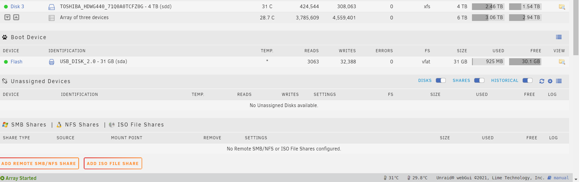

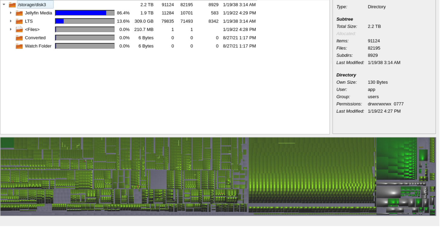

Might seem like a daft question but i am running 4TB HDD and it says i've used 2.46tb but when you look at it through QDirStat i've used 2.2tb.
is there any reason why one says one thing and the other says something else?
I've added pictures to show.

Is it possible that it is a TB vs TiB "issue" ?
In addition to TB vs TiB, there is also filesystem overhead, which is accounted for in the Unraid screenshot, but since it isn't part of the actual folder/file space, isn't included QDirStat.

That's possibly what it is then. Didn't think the file system overhead should need nearly 200gb

32 minutes ago, Wrightzombie said:
Is there much of a difference between both
2.2TiB = 2.42TB
33 minutes ago, Wrightzombie said:
Wouldn't it Tib if it was the other one?
Not necessarily:
https://github.com/shundhammer/qdirstat/blob/master/README.md
All size units are 1024-based, i.e. 1 kB = 1024 Bytes; 1 MB = 1024 kB; 1 GB = 1024 MB.
