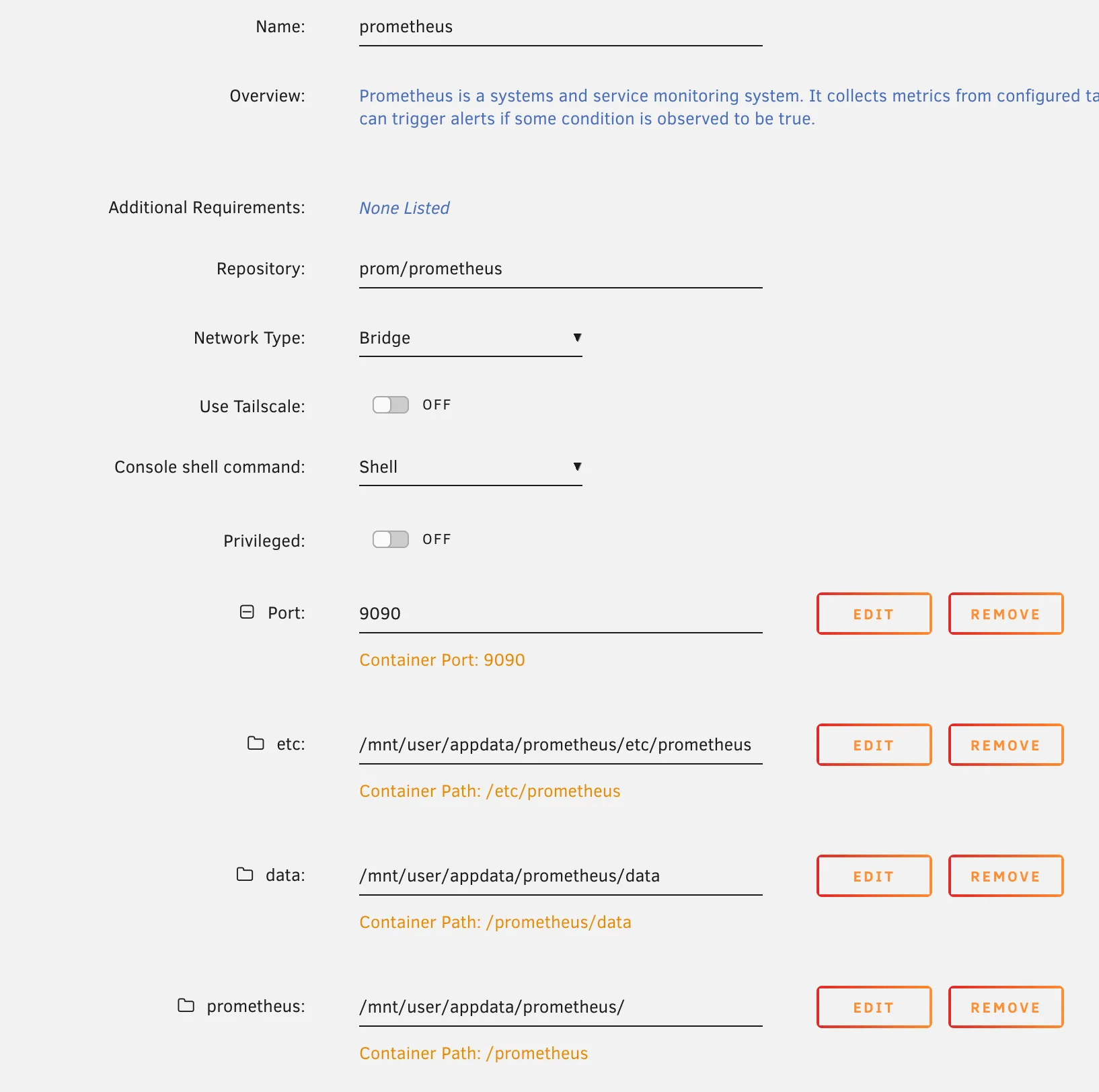

May 29, 20224 yr I just figured this out I had to change the volume mappings to: /etc/prometheus/ <-> /mnt/user/appdata/prometheus/etc/prometheus /prometheus/data <-> /mnt/user/appdata/prometheus/data

July 18, 20251 yr I had this exact error, here are my volume mappings that worked! I had to also do the prometheus volume mapping itself:/etc/promethus -> /mnt/user/appdata/promethus/etc/promethus /prometheus/data -> /mnt/user/appdata/prometehus/data /prometheus -> /mnt/user/appdata/prometheus/
