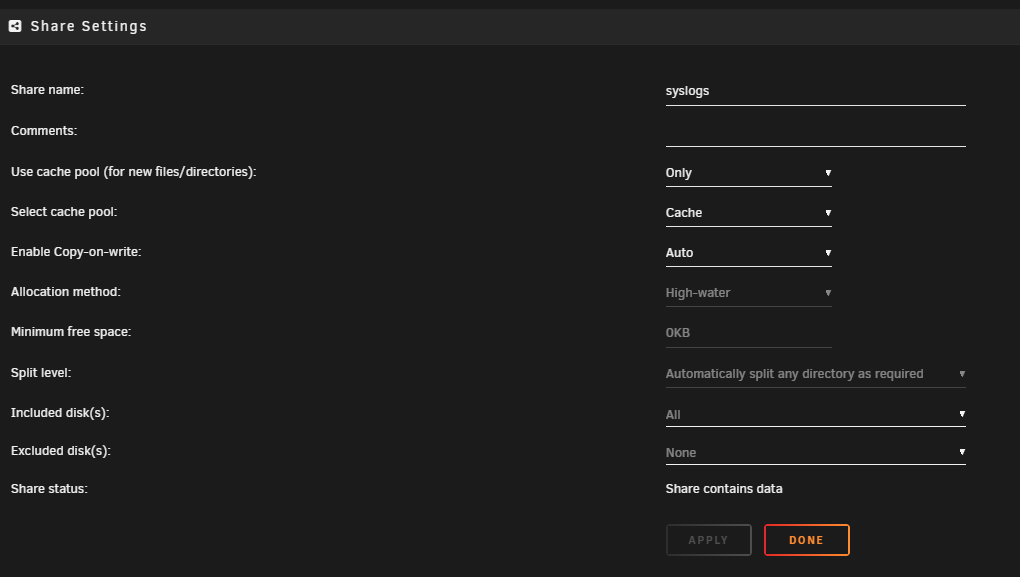

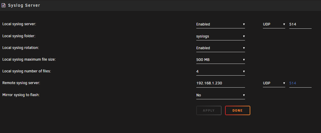

I've set up syslog server to capture server logs, but they are written to a share.  When the server crashes, the syslog shows no logging around the time of the crash, it shows the community apps backup run at 3am, then nothing until the hard reset at 1:16am.  The server crashed at about 12:45am.

So my question is how can I capture system logs to a directory on the array rather than a share? Maybe the crash isn't capturing logs because the crash is killing the shares?

That's why mirror to flash is an option.  Your flash drive can be removed and read in another computer even when the array won't start or is not accessible.  This should not be left on long-term due to wear and tear on the boot flash drive but it is there for temporary troubleshooting.
Only shares or <custom> can be selected as destinations in the syslog config GUI.  <custom> let's you edit the syslog config and point to another location.  I have mine going to an unassigned device called SYSLOG which is a removable NTFS formatted flash disk.  This is what I did:
Modify the syslog config files on the boot flash drive to point to the UD location:
Change the server_folder line in /boot/config/rsyslog.cfg to point to the UD location:
      server_folder="/mnt/disks/SYSLOG/"
In rsyslog.conf, change the $template remote variable to point to the UD location:
  $template remote,"/mnt/disks/SYSLOG//syslog-%FROMHOST-IP%.log"
The entire process for my use case (very specific and not generally applicable) is documented here.  It can be modified for other similar situations.
