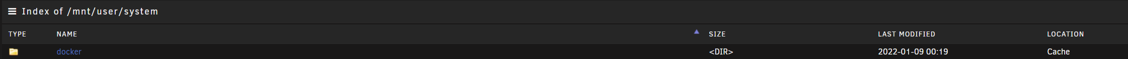

Thanks. It looks like the docker image and appdata is already in cache?
If you already have apps installed (Docker Tab), then you didn't recreate the docker image.
Settings - Docker - Disable the service.  Delete the image (there's a check box and button).  Re-enable the service
Apps - Previous Apps, check off what you want and hit install
