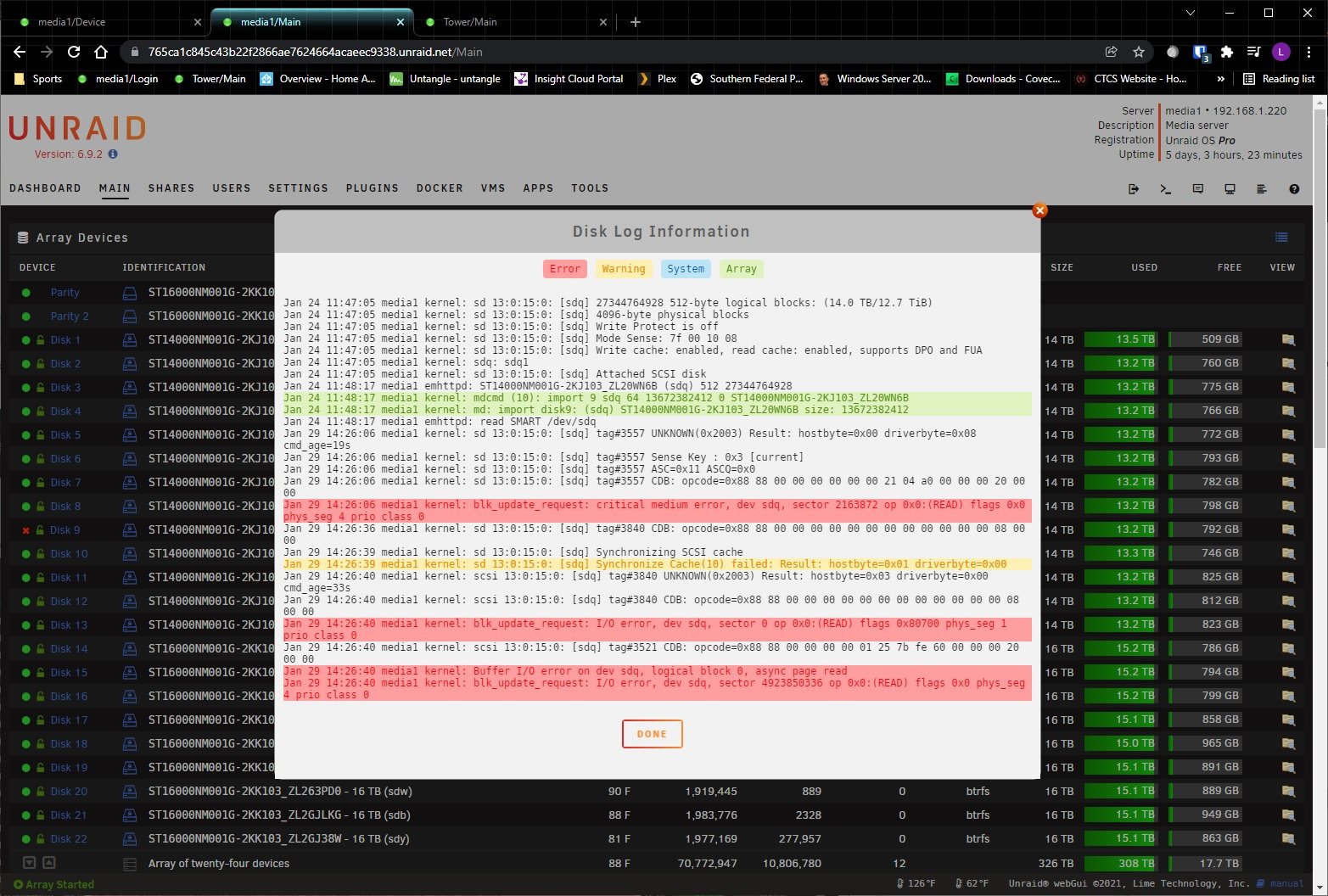

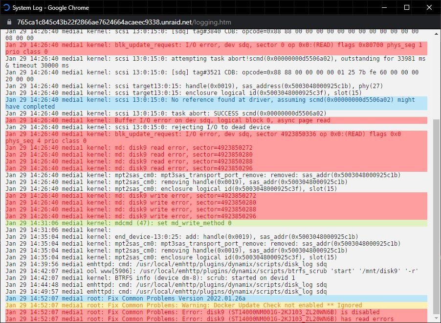

Just started receiving drive errors and currently running the btrfs scrub process.t  I'm assuming that won't resolve the issue and am trying to figure out proper next steps.   Hoping someone can help decipher the log and point me in the right direction.
I'm attaching diagnostics and a couple of screen shots, one showing the syslog errors and the other showing the errors in the disk log.

You have to rebuild the disk. Scrub won't hurt, but it is only working on the emulated disk at this point since the disk has been kicked out of the array.
No SMART for disk9 in diagnostics, looks like it has disconnected.
Check all connections, both ends, SATA and power, including splitters. Then post new diagnostics.
