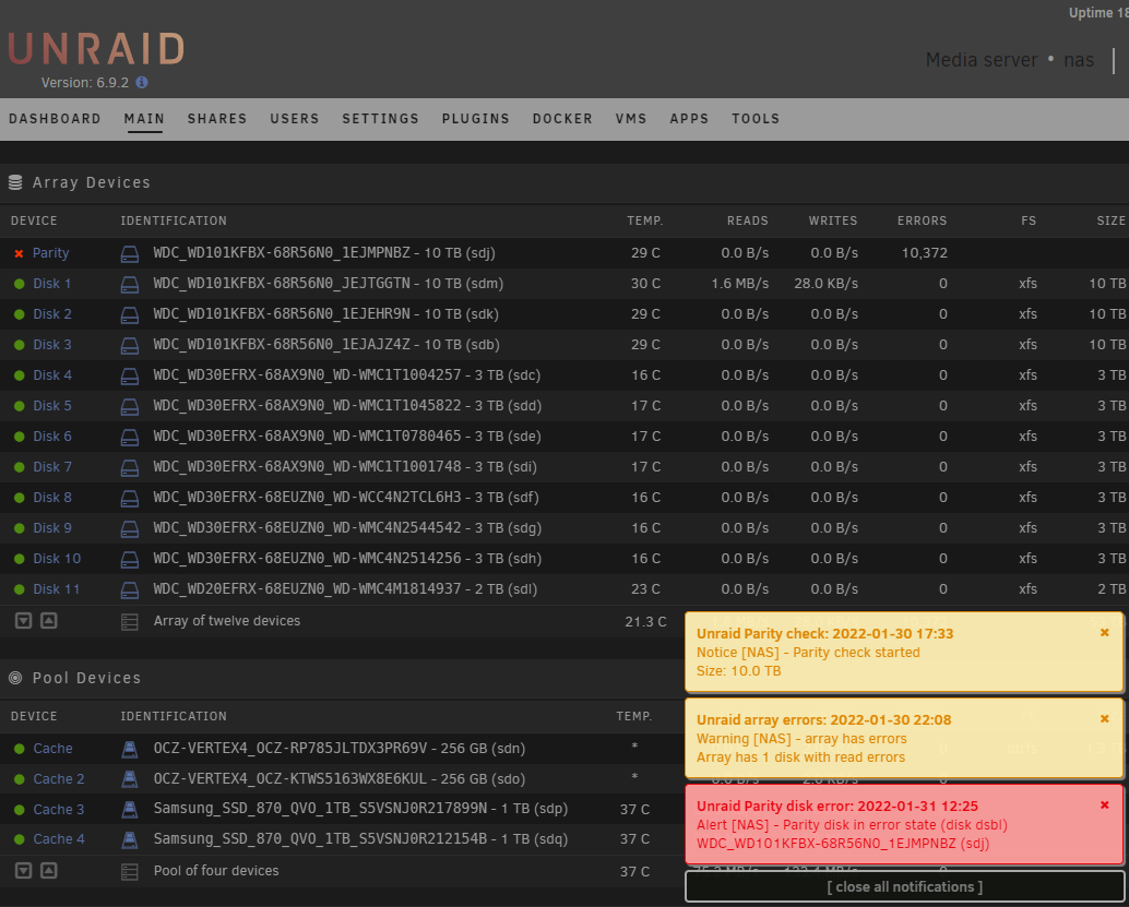

Hello,
I just recently started having a recurring issue where my NAS becomes unresponsive after 1 to 2 days of uptime. Looking through the syslogs I can see lots of read errors on disk0 (which I'm guessing is my parity drive). I also have started to hear a HDD grinding noise coming from the server, but was not able to identify the disk that was causing it, but I am pretty sure it is this disk.
As soon as I heard a disk going bad I purchased a new 10TB WD RED Pro drive which is what i have been replacing my older disk with and is the exact same model as my current parity disk. What would be your recommended approach to this? Swap the parity drive and let it rebuild or add my new drive as a second parity drive and then remove the bad one?
If I can get some advice on if this is really what is wrong and the best approach to fix the problem I would be very grateful! I have included my SMART error log for my parity disk and attached my systems diagnostic logs.
Thanks!
Chris

You should run an extended SMART test on parity then act according to the result, but unlikely that's crashing the server, could be this issue:
I woke up this morning to this error. That thread does look promising too, but I definitely feel like something is up with my parity disk :P
Over the weekend I swapped my parity disk and let parity rebuild. That part of the issue seems to be resolved and my data is safe again! :)
As for the issue with my server becoming unresponsive every 24h or so, unfortunately the issue is still happening. I went through the forum thread you posted and did what they said (added "blacklist i915" to "i915.conf") and the issue still happens.
Any other thoughts what could be causing this?
Thanks!
Chris
