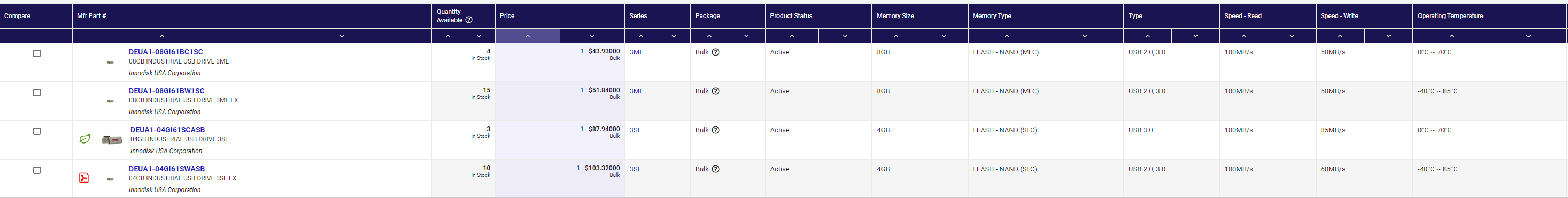

I bought the Innodisk 3ME (https://www.innodisk.com/en/products/flash-storage/usb-and-usb-edc/usb_drive_3me) digikey had it for "just" $51 for the "EX" which is the extreme temperature version. I figured when already paying 2-10x for a flash drive might as well spend that extra $8 to gain -40C and +15C (to 85C).
I could've gone SLC, but on paper it looks like the main advantage is 3 more years of warranty. Innodisk warranties SLC to 5 years, MLC to 2. I know SLC is better, but in today's age of 3D QLC garbage MLC is pretty good and at half the cost of the SLC version I'll just pocket the difference and pony up for a new one if it makes it at least 5 years (my arbitrary cutoff to make this drive worth it).

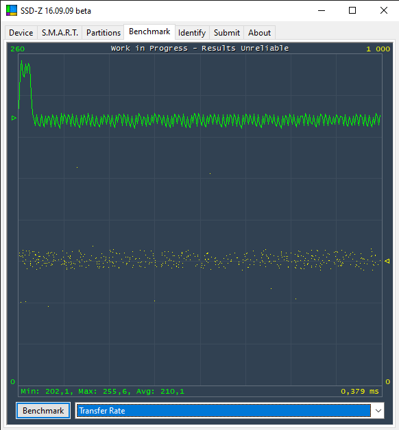

16GB Transcend JetFlash 180I screenshots:
2055358488_TranscendJetFlash180Issd-z-01.png.58d21677908707b67b0e2db05d7d4013.png813709999_TranscendJetFlash180Issd-z-05.png.2aee5c393d2c89dc361b3cdbcdcfe9f9.png859084347_TranscendJetFlash180Issd-z-04.png.807f100e2a87437c4b370fb708cb2fb2.png1431157786_TranscendJetFlash180Issd-z-03.png.95415b6cd8a8981493325ef144bda743.png ... 1250056909_UnraidUSBTranscendJetFlash180I.png.38e913de80d6fc5135d029137e3164eb.png

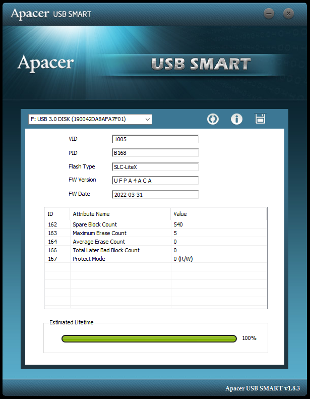

I see first time USB Flash drive with S.M.A.R.T.

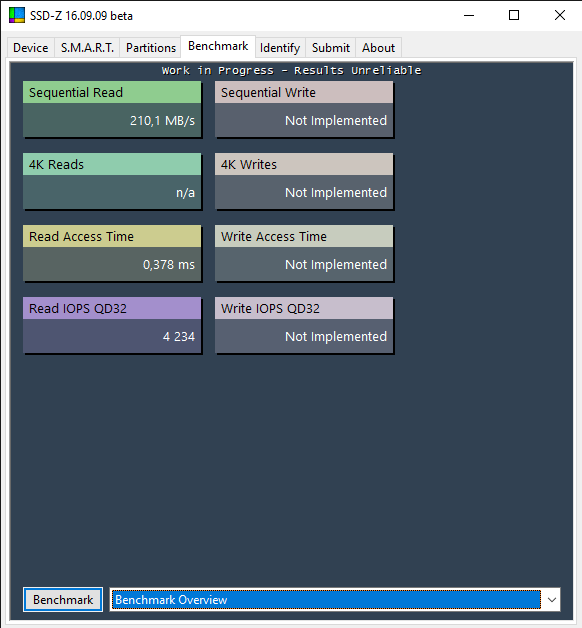

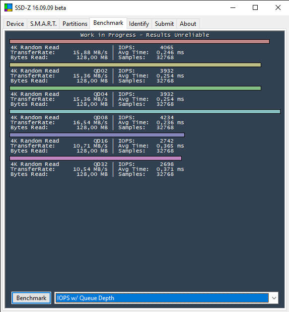

7 minutes ago, bagican said:

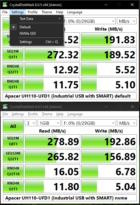

I have the Apacer UH110-UFD1 !
some details and benchmarks:

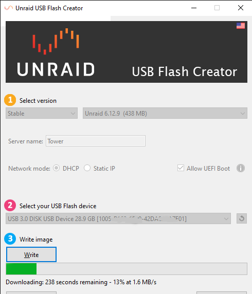

speed isn't important for the boot drive. Does it have a unique GUID?
seems it has unique GUID:
311247721_UnraidUSBFlashCreator28_03.202416_47_27__x.png.9a7b784e4d22d06638d0fb6f9f1e7aed.png

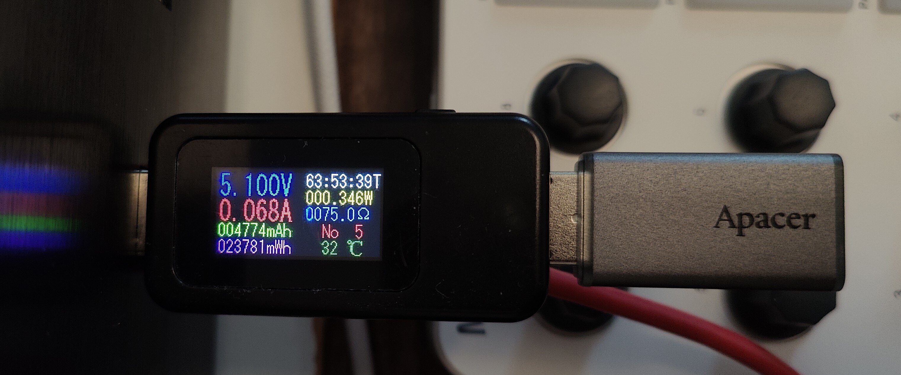

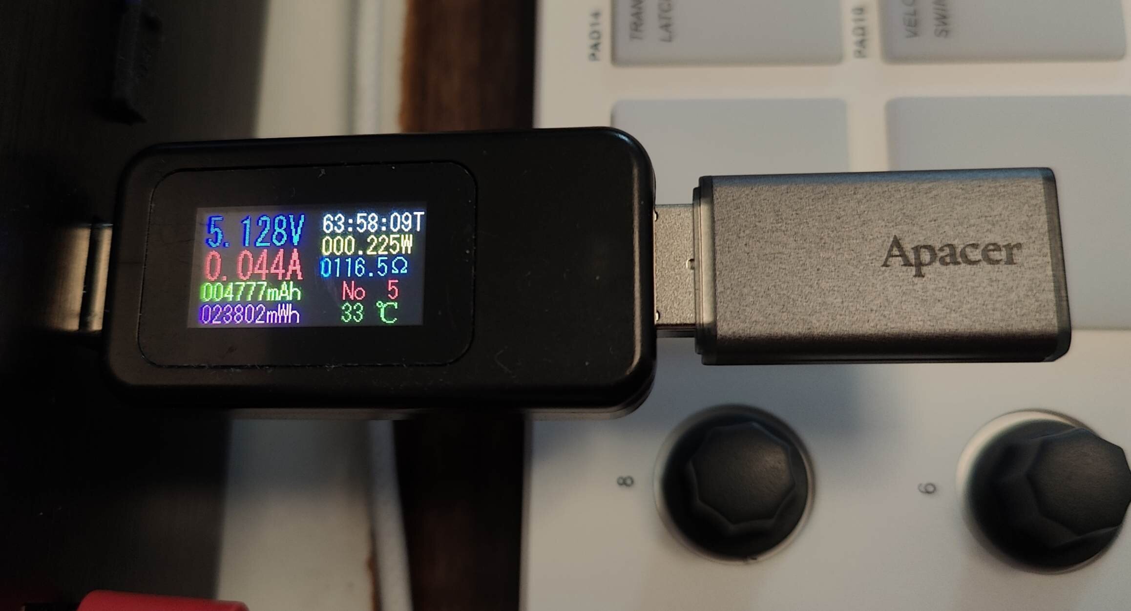

Did you happen to check power consumption on the Apacer as well?
Seldom accessed so probably not relevant.
@TOMillr @TOMillr-old yes, here are the results for the Apacer UH110-UFD1: 0,19 - 0,240 W in idle in USB 3 port, but in USB 2 port I measured a bit higher values (~0,3 - 0,4W) ⚡
in USB2 port:

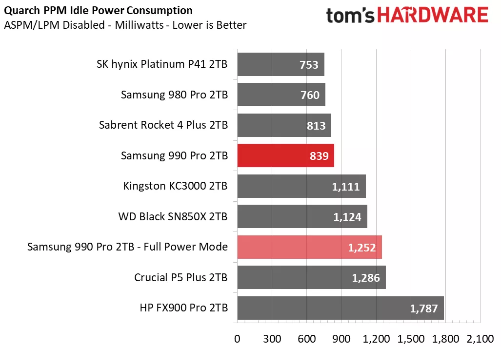

But I think measuring power consumption of such devices are questionable. Power consumption is negligible.
I would rather focus on efficiency of power supply or M.2 SSD disks in idle mode (for example Samsung 980 Pro or Samsung XYZ Pro are known they have good power management, even when ASPM disabled comparing to other SSDs:
  • Quote
