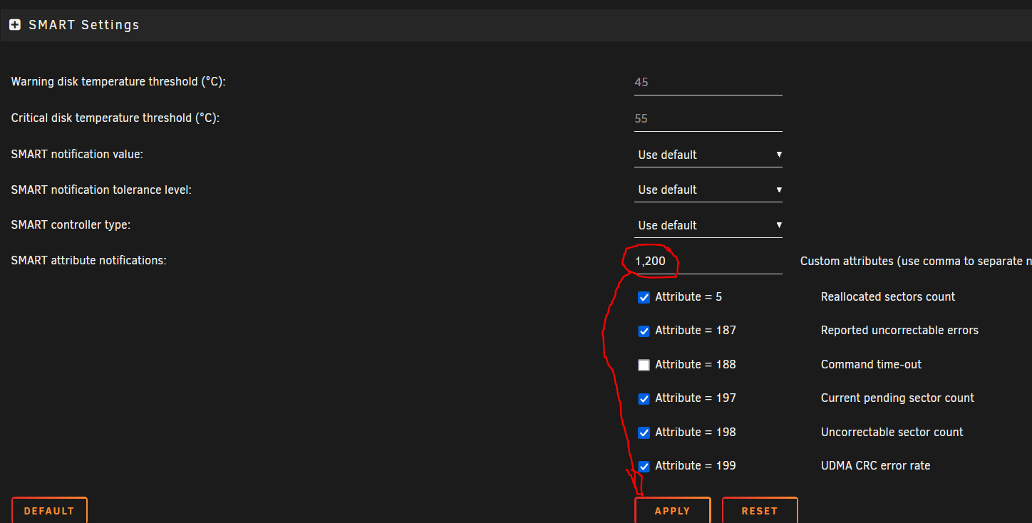

Do you have the notifications enabled to warn you as soon as possible of issues ?
Note that you have to manually add SMART Attributes 1 and 200 to the monitored attributes for WD drives.
I will add 1 and 200 to the list. Thank you. But as I said up until now

Trurl extracted the most relevant elements from your SMART report.

Different manufacturers use some attributes differently, so Unraid do not monitor all of them. This only represent the monitored attributes, so not entirely representative.
@ChatNoir ah I see. No by adding 1 and 200 unraid also shows a thumps down. Thank you.
