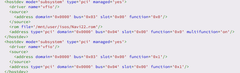

I also encountered the same problem, and the built-in sound card on my graphics card cannot be recognized. The graphics card can recognize but cannot drive normally, code 43.I tried my best to browse through as many solutions as possible.This problem has been bothering me for several days. I learned that only Nvidia graphics cards require VBiOS. However, since it still doesn't work properly, I extracted my graphics card's VBiOS through GPU-Z. But still ineffective.Hope to get a solution
1.VTD=enable
In addition, I found that the L1 cache is displayed as non-existent in the Task Manager of Windows 11
VM XML.txt 虚拟机 XML.txtVM Logs.txt 虚拟机日志.txttower-diagnostics-20241128-1411.zip
塔诊断-20241128-1411.zip
Edited by sunzhixan1009
new found
