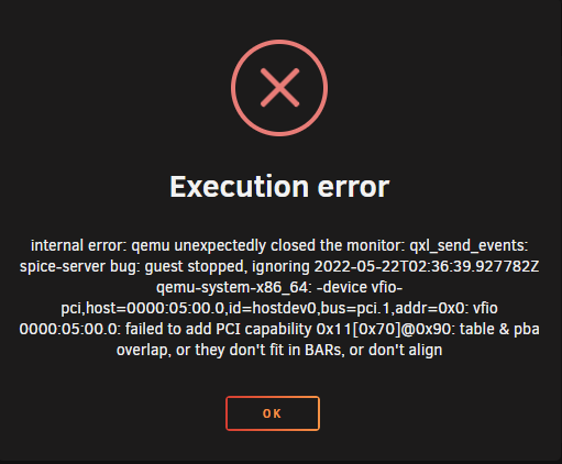

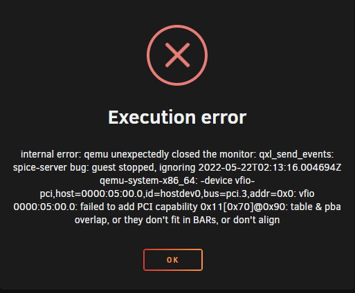

Thought I would give this a try now that I'm on 6.10 final... And no luck.
I attempted to start with the non working version of the xml (Added the cards and made the addition above (Manually adding the alias))
Here's the xml that I'm trying... it still appears to be removing Alias' though, so I manually inserted one.
pfsense try.xml
Then it spits out this error:
And then I get this when I go back in to look at the xml:
 pfsense result.xml

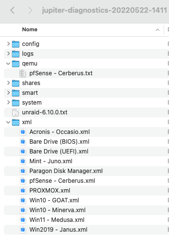

And Diagnostics:
jupiter-diagnostics-20220521-2218.zip
Thanks AGAIN,
only the "another try" seems to be correctly configured: however there's no diagnostics, so we cannot see why it fails.
The other xmls, including that inside diagnostics have no trace of the override block, and this cause the error.
Please attach diagnostics with the correctly modified override block.
