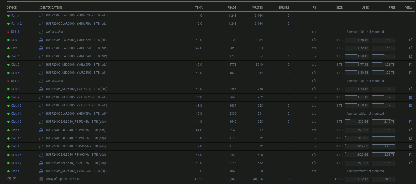

I have a UPS for my machine, which covers it for about 3 minutes during a power outage, which should give it enough time to power everything down. A few nights ago there was a power outage and the server went down and did not come back up on its own. I had to manually bring it up in the morning. When it came up I had two disks that were emulated, and after an attempt at rebuilding the same disks I swapped them out. I started a rebuild and figured everything would be fine... it was not.
Once the rebuild finished I still had disabled/emulated disks. I rebooted the server, thinking it may help bring things back to a stable state... after doing so... Instead what I had was four unmountable disks, including the two original disks which had issues. However the state of the disks was reporting healthy and online, which confused me...
Following the advice of some other posts on the forums, I tried running suggested xfs_repair with options, and that did not seem to help. It seems like the 'problem' disks keep jumping from one to another.
While I know this may wind up being an issue that results in some disks needing to be completely reconstructed, I'm hoping to avoid that if at all possible. I am running two LSI 2308 and an Expander card ( I don't know off the top of my head the model and I'm trying to avoid pulling anything apart again ).

Also, a screenshot of the array when started: image.thumb.png.ebd9b277d38902f575b0d3e008d52eea.png
There are constant errors with multiple devices, these suggests a power/connection problem, you should also upgrade the LSI firmware since it's very old.
Creating a smaller array is relatively easy, you just need to do a new config, unassign the disks you don't want in the new array and start it to begin a parity sync, but this should be done only after the above issues are solved.
