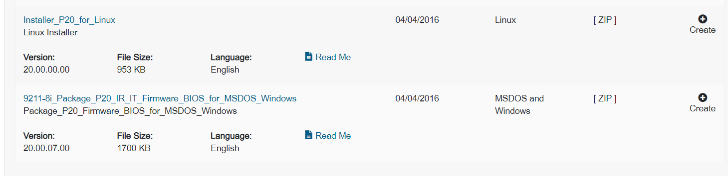

my controller should be is 9211-I8, and I understand that my firmware is 20.00.06.00 and the last firwmare is 20.00.07.00
But i cannot found the firwamre for linux, only for MSDOS or Windows.

Maybe i found it, it is correct that the installer P20 have a different release? on 20.00.07.00 is only for MSDOS
let me know if right.

Like mentioned in the link above the DOS/Windows package includes the firmware, Linux package is needed just for the flashing utility.
Also as mentioned do it with the array stopped, and it won't affect the data.
