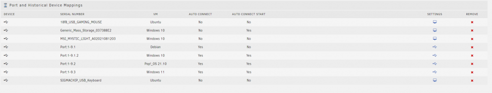

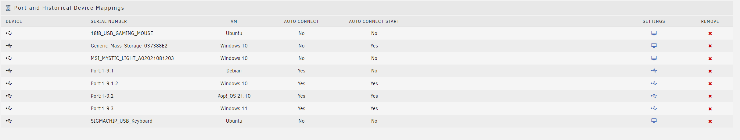

Connected outside means not connected by my plugin.
Do you have any historical devices?
