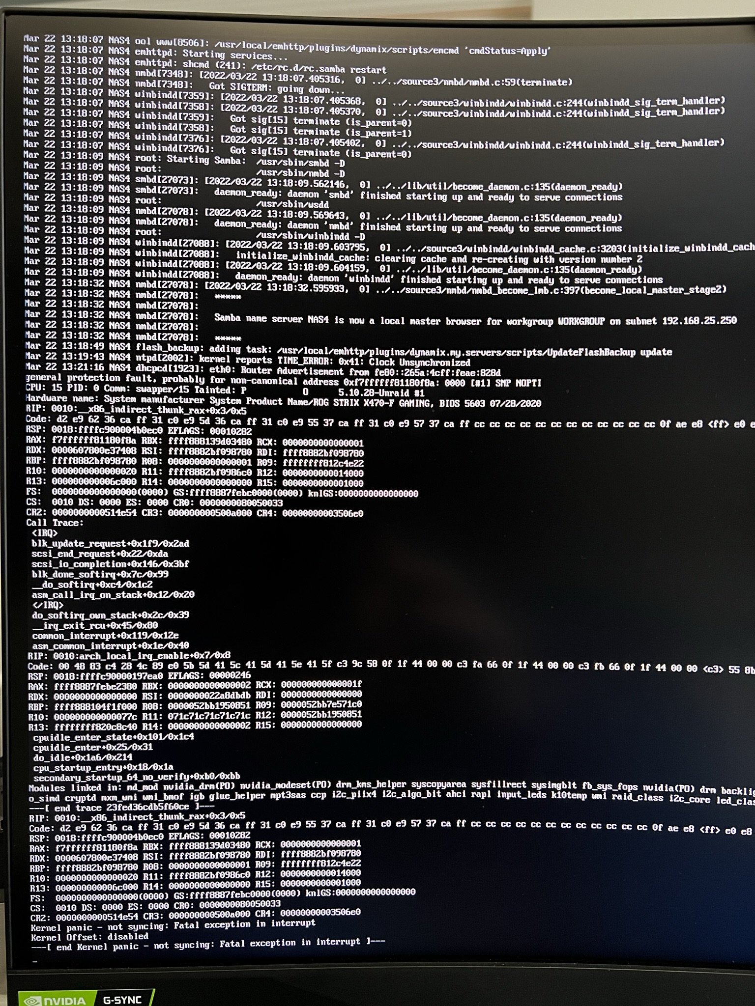

I set the CPU and Memory speeds to "auto" in the BIOS. The memory is now running at the speeds you linked to earlier. The BTRFS errors are gone from the logs now. Sadly, my server is acting more unstable now. I see errors showing read issues on SDA so maybe the flash drive hasn't liked having the lock ups and power cycles? I had the syslog viewer up on the screen when it crashed so I saved it and there is a screenshot from a monitor I've connected.

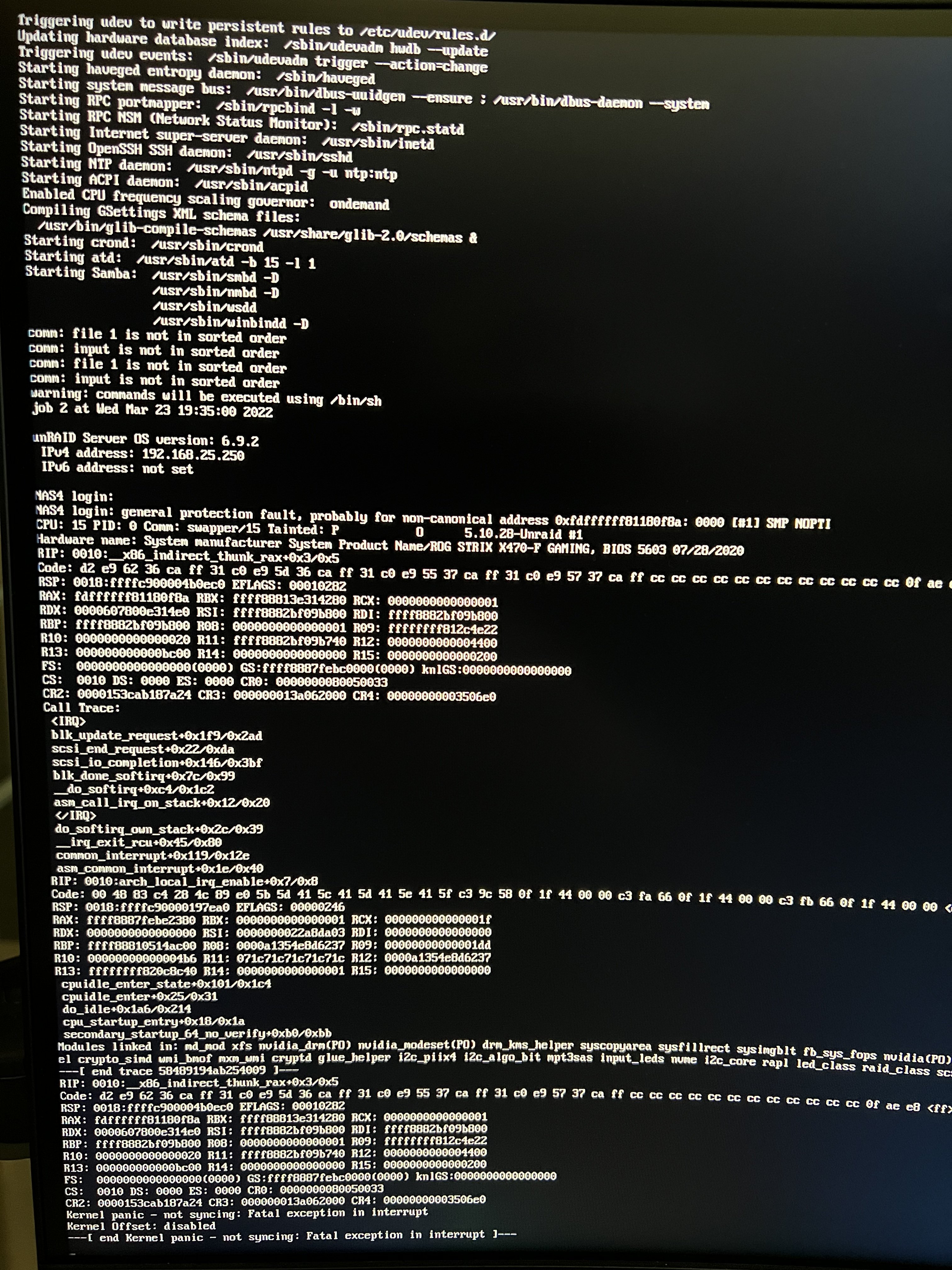

Well, I thought things were better, but the server crashed again last night. I was doing another parity copy. The last status I saw was at 96%. I’ve attached what was on the screen this morning. Any ideas?
You can enable the syslog server and then post that after a crash to see if there's anything logged, but if it's a hardware issue there probably won't be.
