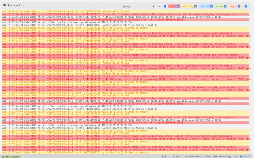

one more thing my server is running very slow and buggy so i looked at my logs and its filled with this
