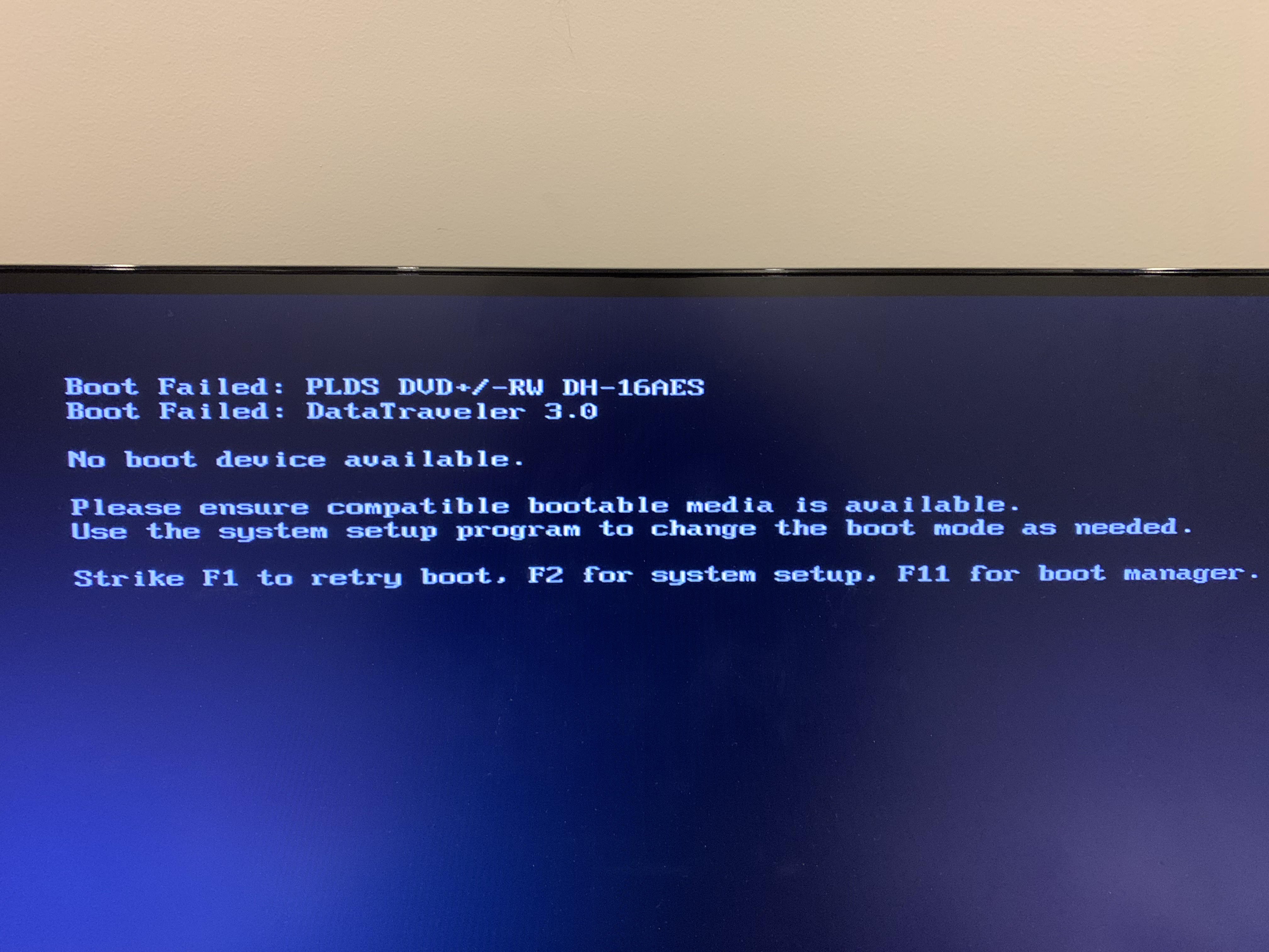

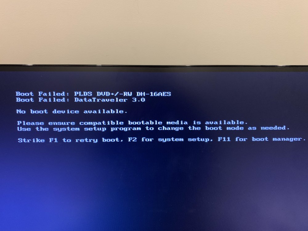

I have a DELL T320 and this is the first time I am trying out Unraid.
I have tried 2 USB 3.0 sticks. one is 32GB (USB3.2) and the other is a 16GB (USB3.0).
Both have failed to boot through the USB.
The BIOS is in UEFI mode. and error and it comes back as a not compatible bootable media.
I have tried a LINUX MINT bootable usb and it loads fine.
Please help
If there is a EFI- directory on the flashdrive, remove the trailing - and try booting again.

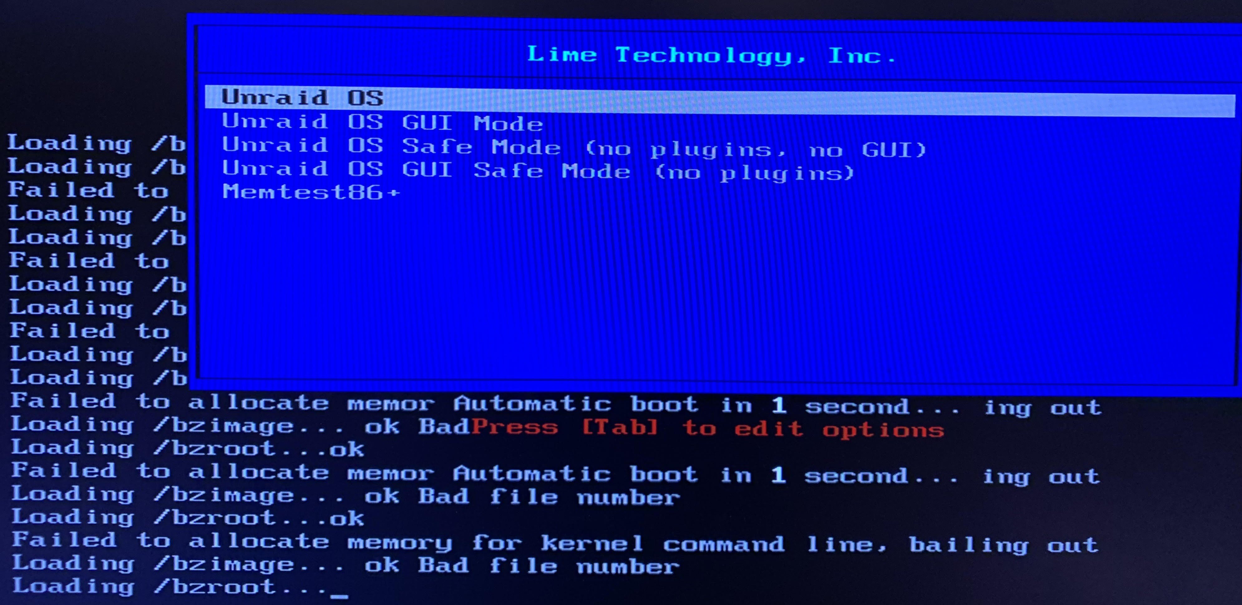

That worked and was able to boot into the UNRAID menu. But I get a command line error that says
Loading /bzimage...ok Bad file number
Loading /bzroot...ok
Failed to allocate memory for kernel command line, bailing oout

That can mean that the system is having problems reading one of the bz* type files on the flash drive.   Typically the fix is to download the .zip file for the release and then extract all the bz* type files overwriting the ones on the flash drive.

Exactly same error again with the extraction of all the bz files

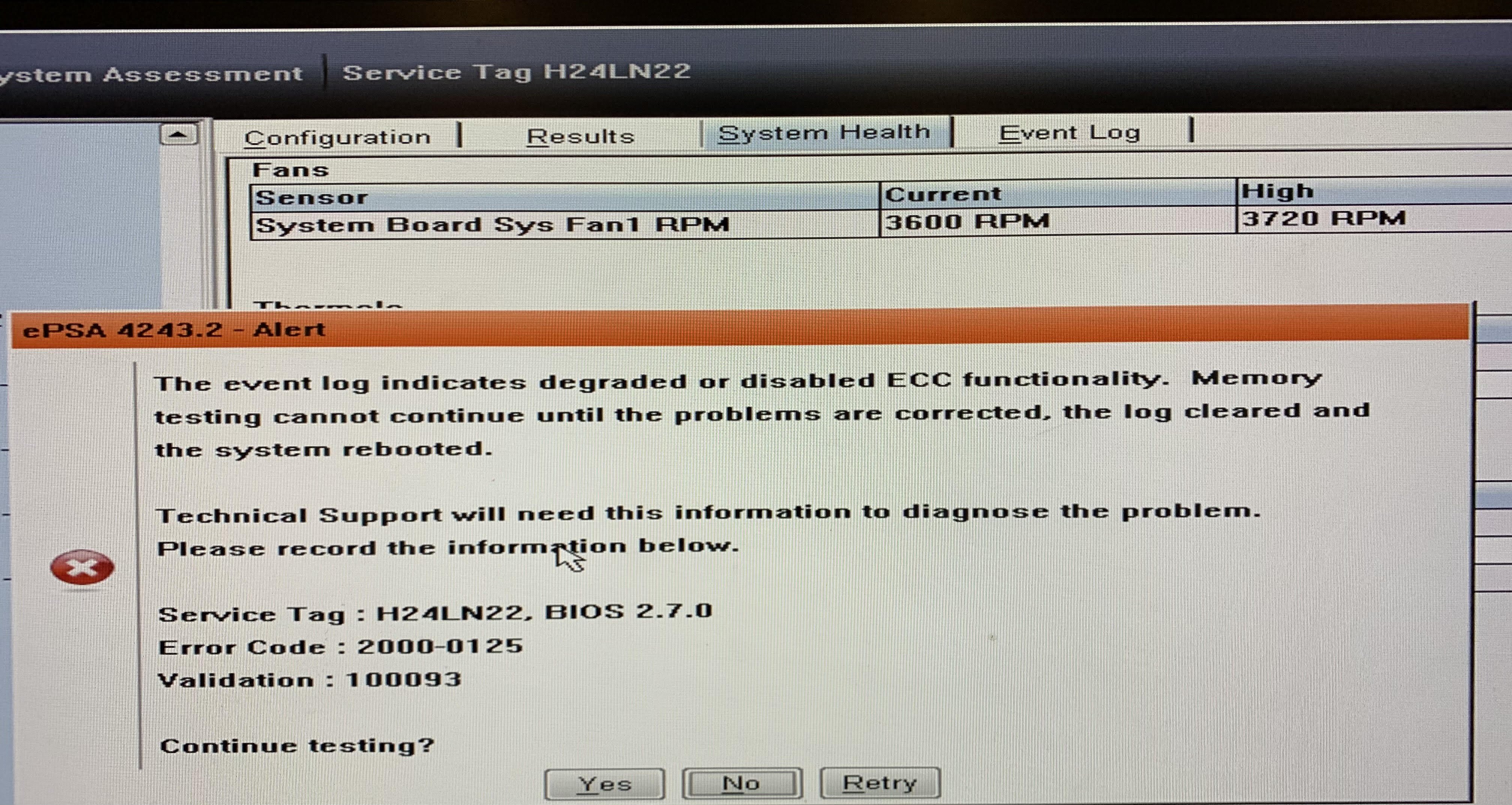

When I ran a system check,
I came across this result.
Is it that the RAM is bad ? Cause there is no ECC setting in the BIOS
Does not seem to be the Server RAM cause I did change to a new RAM and it didnt work. Same error.
