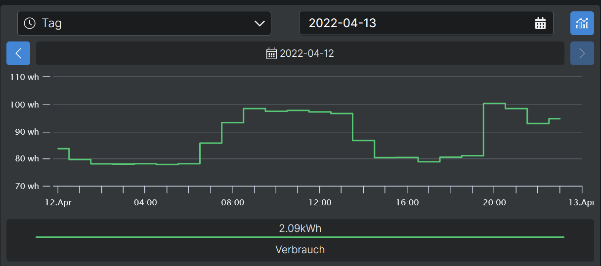

This is my server stats from yesterday (btw, you only get the long term stats from the (free) shelly cloud. The devices also work without cloud, but then you only see the "current" reading and have to sum up for yourself)
