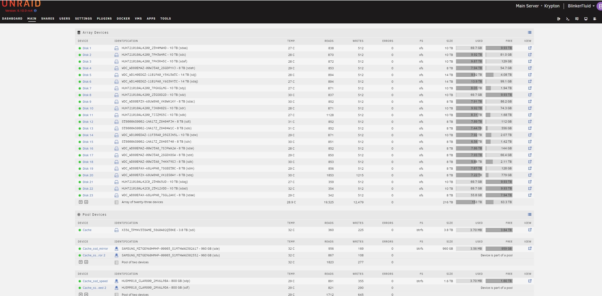

Ok that makes sense just booting into unraid temporarily then booting back instead of trying to do the formatting manually. I have enough empty i can do 5 at a time that way. If i didn't have them in a hgst 4u60 and a bunch of them being sas drives it would be a lot easier
Worked well. Moved data on about 5 drives at a time
