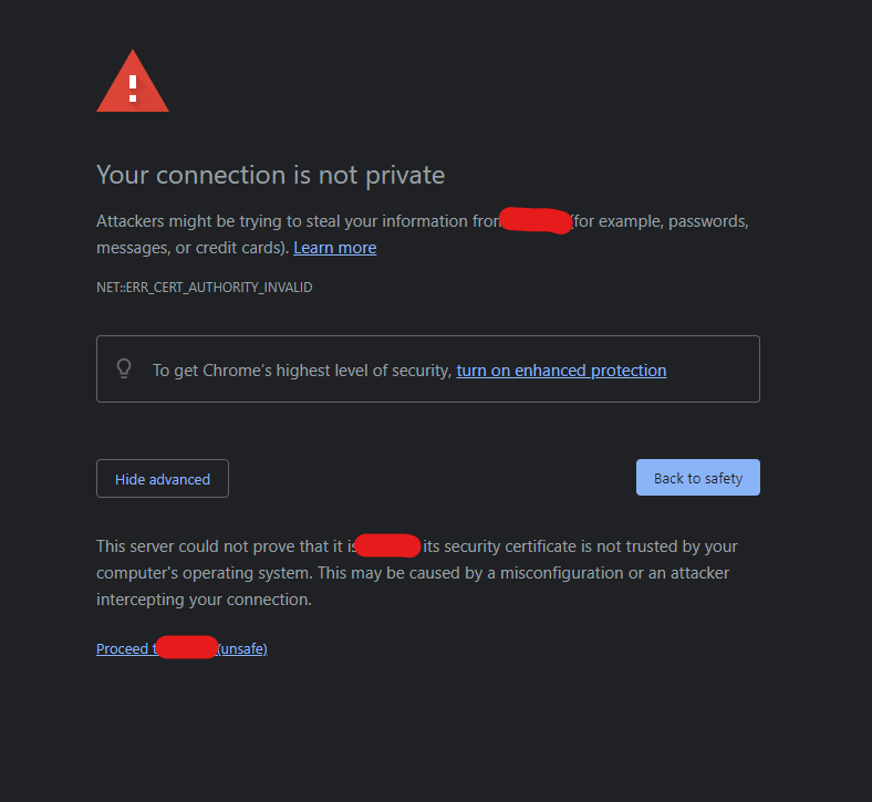

NET::ERR_CERT_AUTHORITY_INVALID
Hello, how can I install my own certificate to remove this (see pic below) when I access it on my local network?
Thanks everyone. :)

I got this error after I clicked "Provision"

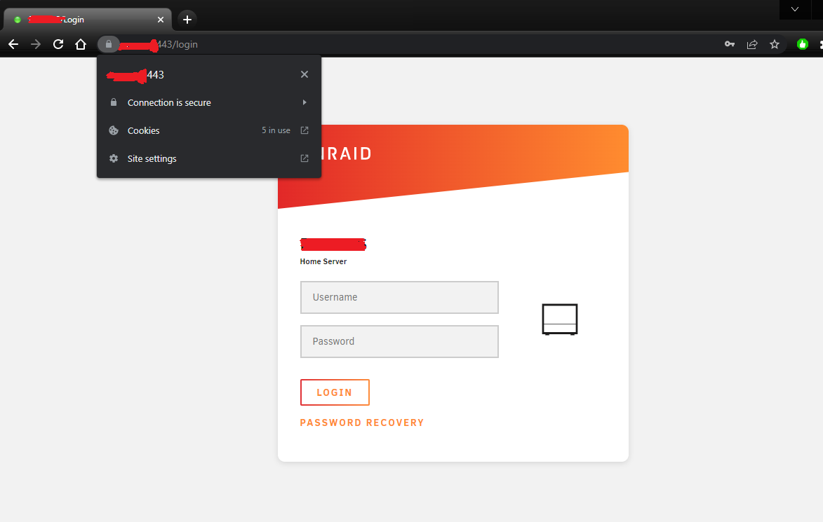

Thanks but no need. I just follow this  https://betterprogramming.pub/how-to-create-trusted-ssl-certificates-for-your-local-development-13fd5aad29c6  and I finally got my lock key in local domain. No more invalid certificate warning.
