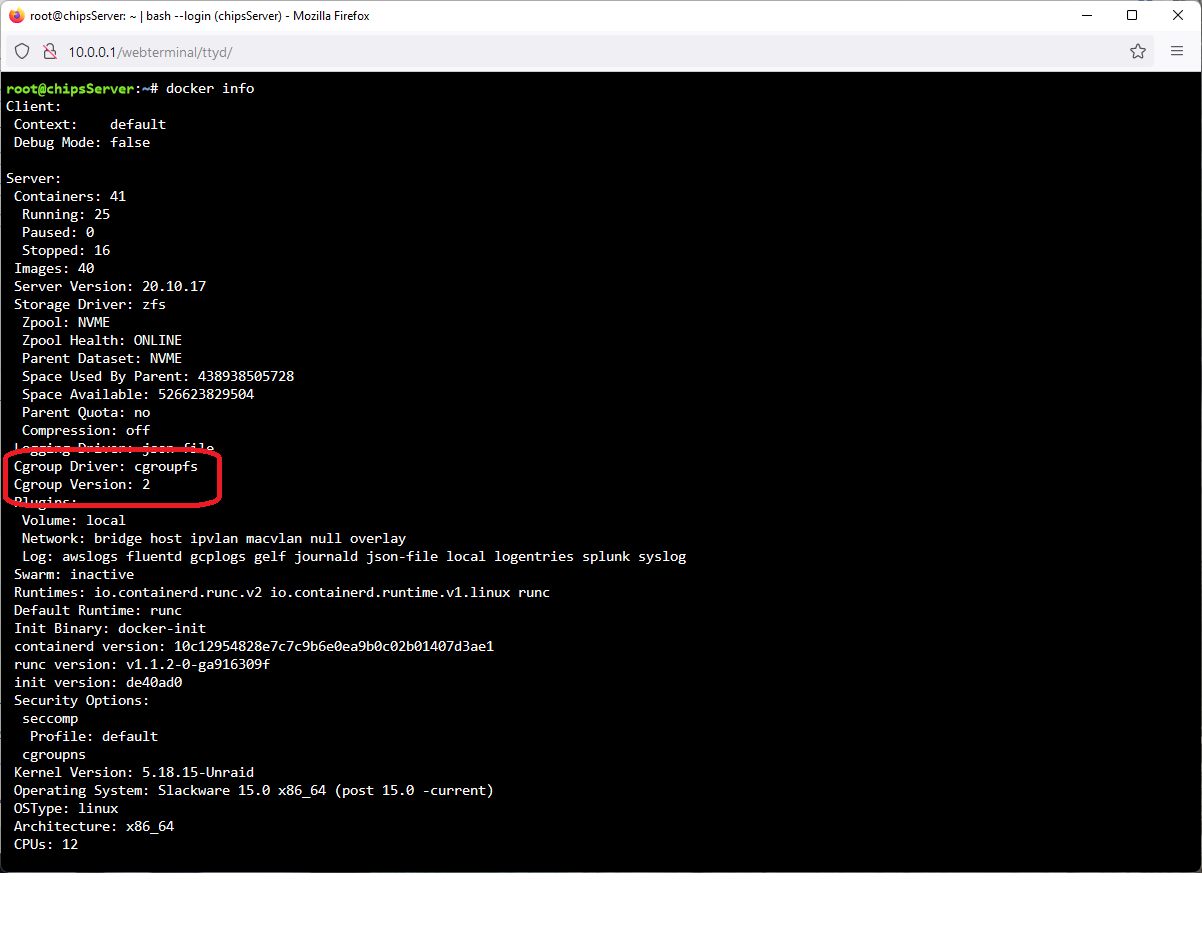

August 1, 20224 yr No, that is not possible on Unraid or better speaking Slackware (at least to my knowledge it's not possible on Slackware and Unraid is based on Slackware). Usually you enable cgoup2 with "systemd.unified_cgroup_hierarchy=1" in the boot parameters but that won't work on Unraid/Slackware because it uses init cgroup2 is at least supported on Unraid/Slackware but you simply can't enable it (to check simply execute: "grep cgroup /proc/filesystems") However you can enable cgroup2 after you've booted Unraid but that will not work reliably because you can only mount the controllers in one hierarchy so there is not really much benefit from that, the stats also wont work and even worse the stats from the Docker page won't work either after doing this: Stop the Docker service Execute "mount -t cgroup2 none /sys/fs/cgroup" Start the Docker service again Run "docker info | grep -i cgroup" and you should see that it now uses v2 Also note that Docker needs to be at least on version 20.10+ for this but I would strongly recommend you to not try this on your main server! However if you really want to try I got a build where cgroup v2 is working but I haven't tested it extensively and can't tell if something isn't working... Fell free to contact me if someone got interested.

April 29, 20233 yr My `docker info` shows I'm running cgroup 1. Also my `docker stats` has the 0% everything cpu. I've been trying to figure this out for a while but gave up as I would like to see cpu usage of containers. I believe this could be related, and it's a starting point to debug potential issues other's are having with this container as well here: I see in Unraids release notes about enabling cgroup 2 with a "syslinux append line." Can someone describe this procedure in more detail. I'm not as familiar with what exactly that means. Quote ## Version 6.11.0 2022-09-23 ### Improvements ... - Preliminary support for cgroup2. Pass 'unraidcgroup2' on syslinux append line to activate. Found: https://unraid-dl.sfo2.cdn.digitaloceanspaces.com/stable/unRAIDServer-6.11.1-x86_64.txt I'm on the latest Unraid version 6.11.5. Thank you.
April 30, 20233 yr 11 hours ago, gvkhna said: Can someone describe this procedure in more detail. I'm not as familiar with what exactly that means. It‘s also described here:
