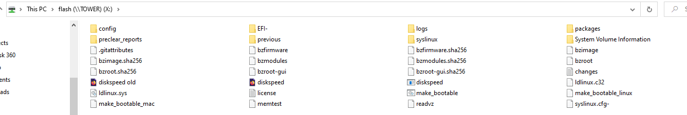

I am running out of space on my 2GB flash drive, and don't know what to prune
Or am I better off migrating to a larger flash drive instead, as I have had this one for some years?
I would be grateful for any advice, please see attached diagnostic file

My 4GB Flash drive has 656MB written. So running out even on a 2GB dosent sound right.
Somthing must be writing into that drive.
Maybe make a fresh unraind install on anthoer flash drive and the compere the two?

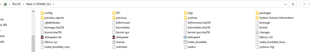

This is what I see in Windows
image.png.3d6216bb7a021bded37e4756bf54bebd.pngimage.png.b6bb93aedb9379da646255f47ed3b935.png

That's what I was thinking.
And certainly using Windows I can't account for the space used, I appreciate that there maybe unseen non Windows info too.
Go your webgui and under Main then flash then click on the view icon on the right it will tell you what is chewing up your space.
What is in the logs folder on flash? Do you have syslog server mirroring to flash? You should only use that sparingly.
