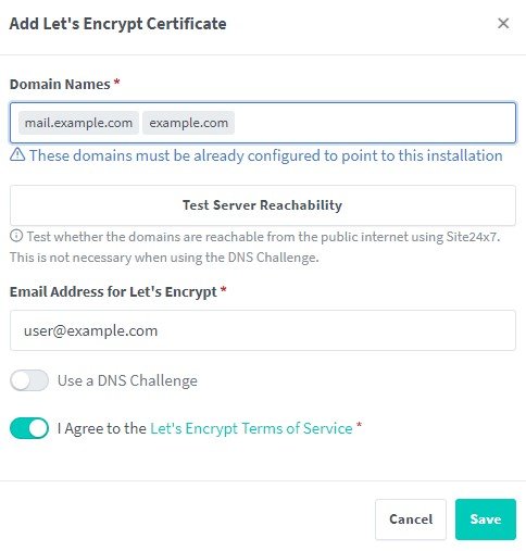

As I see it, you can get the certificates through the NginxProxyManager via HTTP or DNS Challenge.
With HTTP Challenge LE (Letsencrypt) makes the request exclusively over port 80.
Therefore it is important that your router listens on port 80 and then forwards the port you configured for the application to the proxy.
LE -> HTTP 80 (TCP) -> 80:Router:11180 -> HTTP 11180 (TCP) -> NginxProxy (Custom or Unraid IP).
As long as the web port is not the same as one of the mail server ports or the Unraid webinterface you can choose whatever you want.
DNS: Have no experience in that one. Maybe this info will help you.
If you have further questions about the NginxProxyManager, please use the appropriate forum.
Edited by Kulisch

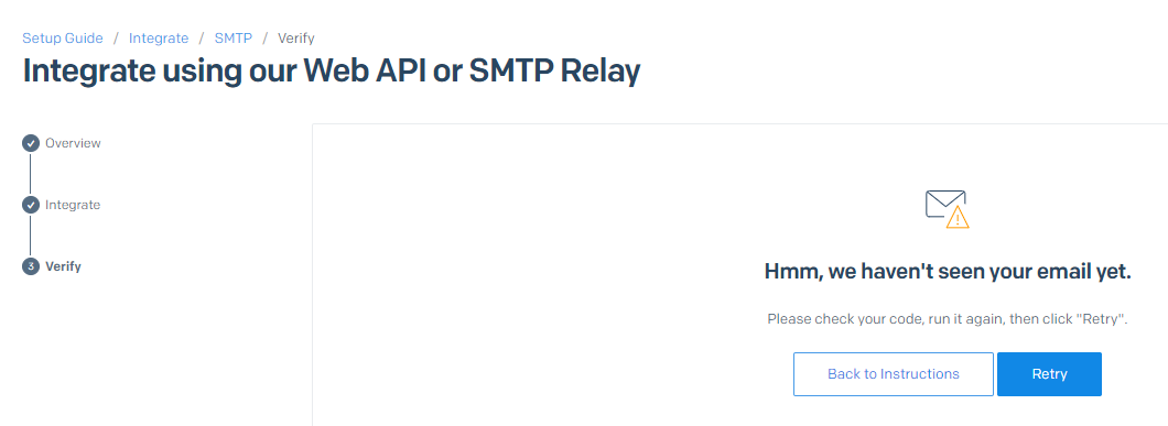

Hello.
I'm trying to use sendgrid as a relay for outbound emails and I can't get this to work in any way. I'm doing this because even though my ISP did unblock port 25 for me upon my request, i immediately was blocked by google with the following message:
smtp postfix/smtp[4920]: DFF6230000000742177: to=<example@gmail.com>, relay=gmail-smtp-in.l.google.com[142.250.27.27]:25, delay=1.1, delays=0.01/0/0.79/0.26, dsn=5.7.1, status=bounced (host gmail-smtp-in.l.google.com[142.250.27.27] said: 550-5.7.1 [188.24.XX.XX      12] Our system has detected that this message is 550-5.7.1 likely unsolicited mail. To reduce the amount of spam sent to Gmail, 550-5.7.1 this message has been blocked. Please visit 550-5.7.1  https://support.google.com/mail/?p=UnsolicitedMessageError 550 5.7.1  for more information. h13-20020a1709063c0d00b006ff19100b37si8253899ejg.616 - gsmtp (in reply to end of DATA command))
I've configured my DNS according to sendgrid's setup guide and created an API key for the sendgrid SMTP relay. Once that was done I changed my container's configuration as follows:
In advanced view in extra parameters: --hostname smtp.sendgrid.net --restart always --cap-add=NET_ADMIN --cap-add=SYS_PTRACE
Based on the documentation from here https://docker-mailserver.github.io/docker-mailserver/edge/config/advanced/mail-forwarding/relay-hosts/#sender-dependent-relay-host= I ran the following command:
setup.sh relay add-auth mydomain.net apiuser apikey
Which created a postfix-sasl-password.cf file with the correct info from the above command.
Then i ran this next command:
setup.sh relay add-domain mydomain.net smtp.sendgrid.net 465
Which created a postfix-relaymap.cf file with the correct info from the above command.
I then restarted the container and sent a test email to a gmail address (sendgrid wants to verify that the configuration is correct by sending an email from the server with the new configuration).
I once again got the same error that I was getting before saying that my email is most likely unsolicited and sendgrid says that they did not pick up my test email yet:
Since the email never goes anywhere near sendgrid I am assuming i misconfigured something so can you please help me identify what i've done wrong in this whole process?
Let me know if you need any further details about my configuration.

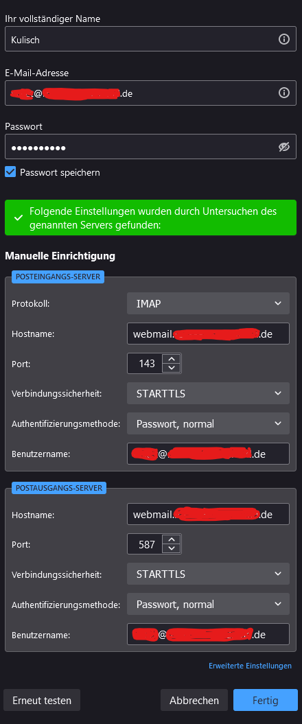

Hi, I seem to be struggling with getting some parts right. I use Cloudflare as my DNS provider, where I already have my MX and TXT records setup and have the .pem and .key locations setup in template for manual. I have forwarded all the ports used by the docker at the moment for testing purposes onto the IP of the unraid server. Thunderbird does recognize these records, as it autofills the configuration with IMAP.
However after this part it's when things starting falling apart - when trying to login, I get a message saying "Unable to log in at server. Probably wrong configuration, username or password." I have checked the username and password, which were correct. As there is not a specific error message, I am unsure what would be misconfigured.
Would anybody happen to know what can be causing this issue and possibly the fix?

Before you start, I hope you have Fail2Ban deactivated in the environment variables to make sure you dont get banned after some "failed" login attempts.
The question is how you login. Do you use the username (<- wrong) and password or [email protected] (<- right) with password you set up.
You can create a test account and delete it. Try something like [email protected] with password 123456. If that works just check the differences between your account name and password complexity (special characters, numeric- alpha numeric and whatsoever).

Thanks for the heads-up on the F2B, didn't decide to turn it off yet. Not sure if I may have gotten banned as the logs are not showing any alerts, what is the default duration for ban, or where would be the bans located, so I can clear them out?
I have used [email protected] for the login in Thunderbird, which was already created prior in the console of the docker by going to the bin folder and running "setup email add [email protected] password". I did however use special characters during the setup. I will try later today again with a second account with basic password.
Thank you.
Thank you.
To correct myself on the first part. Seems like F2B was disabled, as that's what is default to the template.
Using the test account, I was able to connect to the account now in Thunderbird and same for the original mail account when I updated the password to something basic.
Now I have a new problem, which seems quite stupid. In Thunderbird when sending the first mail I get a warning "Sending of the message failed. Peer's Certificate issuer is not recognized. The configuration related to mail.domain.com must be corrected". As mentioned in my previous comment, I am using manual certificates provided by Cloudflare.
I have a MX record created with name domain.com to point to mail.domain.com. Sending mails between the two local accounts doesn't do anything and trying to send a mail from a different SMTP server, such as Gmail yields error that "mail.domain.com could not be found". I have also tried adding e-mail routing in Cloudflare, which I don't think should be necessary, but no change.

Obtaining (Letsencrypt) certs:

I guess you mean by npm the nginx proxy manager.
If yes, I refer to the earlier posts here in the topic where the nginx proxy manager is used to obtain certificates. I hope you don't make the same mistake and forward all the traffic for SMTP, IMAP and so on to the proxy. The ports must be forwarded to the mail server directly.
i don't use the Nginx Proxy Manager, so I can't give you a detailed instruction how to get the certs and configure it. Im using Swag to obtain Letsencrypt certs.
Please read the previous posts here and maybe you find a solution.
