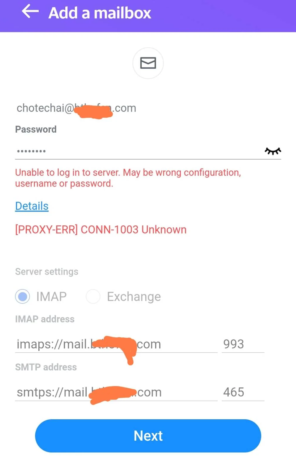

Thanks for the docker.
I've installed it. So far I can send/receive mails between mailserver users, received mails sent from yahoo, gmail, and outlook. Apparrently, sending mails out to those big name mail boxes get blocked as expected. I'll deal with that later.
So far I've tested it using outlook email client on my Windows 11.
However, I tried to add my own mailbox using gmail app on my android phone, and mail app on my ipad. It has not been succeeded. I did open all ports on my pfSense firewall (25, 587, 465, 143, 933). I'm not sure what I did wrong.
These are the log entries: I believe when setting up on email app, I entered the right user/password and mail.domain.com.
Nov  6 17:26:34 mail dovecot: imap-login: Disconnected: Connection closed (no auth attempts in 0 secs): user=<>, rip=192.168.x.yyy, lip=192.168.x.xxx, session=<EpTOSXkJF0TAqAIB>
Nov  6 17:31:39 mail dovecot: imap-login: Disconnected: Connection closed (no auth attempts in 0 secs): user=<>, rip=192.168.x.yyy, lip=192.168.x.xxx, session=<JcYGXHkJDAbAqAIB>
Nov  6 17:34:23 mail dovecot: imap-login: Disconnected: Connection closed (no auth attempts in 0 secs): user=<>, rip=192.168.x.yyy, lip=192.168.x.xxx, session=<Xi3IZXkJkBvAqAIB>

What are you using for Login?
Username, Password (special Characters?), Mail Adress, Domain, SSL/TLS, Port? (please censor sensitive data)
Is the information you entered in iOS the same as in Outlook?
Did you tried Thunderbird?
As soon as I implement letsencrypt certificate, all email clients accept my it....thanks.

I run your docker + snappymail without problem. I've added my yahoo, gmail, self-hosted mail accounts to my snappymail without any issues.
However, snappymail mail loading is very slow for my yahoo, outlook, and gmail accounts when compared to yahoo webmail. I therefore want to add my self-hosted mail accounts (docker-mailserver) to the yahoo webmail so that I can use all my mails at one place on desktop browser.
To add a new non-gmail-yahoo-outlook account to yahoo webmail, I have to use Yahoo mail app on either Android or iOS. So far I've not be able to add my self-hosting account. I'm not sure I have to set something more on my docker-mailserver.
When adding a new (self-hosting) mailbox with Yahoo mail app, there are 2 steps:
step-1: specify my email address ([email protected]), my mailserver imap and smtp server
after entering, my mail server log indicated that it is successful
Nov 29 11:19:41 mail postfix/submissions/smtpd[2523]: connect from sync400374.mail.bf2.yahoo.com[74.6.113.26]
Nov 29 11:19:42 mail postfix/submissions/smtpd[2523]: Anonymous TLS connection established from sync400374.mail.bf2.yahoo.com[74.6.113.26]: TLSv1.3 with cipher TLS_AES_256_GCM_SHA384 (256/256 bits) key-exchange X25519 server-signature ECDSA (P-256) server-digest SHA256
Nov 29 11:19:43 mail postfix/submissions/smtpd[2523]: disconnect from sync400374.mail.bf2.yahoo.com[74.6.113.26] ehlo=1 quit=1 commands=2
Nov 29 11:19:43 mail dovecot: imap-login: Disconnected: Connection closed (no auth attempts in 3 secs): user=<>, rip=74.6.113.153, lip=192.168.2.202, TLS, session=<ogA22EILECxKBnGZ>
step-2: then Yahoo mail app asked for my email password, this step is not successful:
log message from my mailserver:
Nov 29 11:20:04 mail dovecot: imap-login: Disconnected: Connection closed: SSL_accept() failed: error:1417A0C1:SSL routines:tls_post_process_client_hello:no shared cipher (no auth attempts in 0 secs): user=<>, rip=67.195.177.201, lip=192.168.2.202, TLS handshaking: SSL_accept() failed: error:1417A0C1:SSL routines:tls_post_process_client_hello:no shared cipher, session=<2LN32UILQolDw7HJ>
Nov 29 11:20:05 mail postfix/submissions/smtpd[2523]: connect from dip192.lsn.bf1.yahoo.com[67.195.177.201]
Nov 29 11:20:05 mail postfix/submissions/smtpd[2523]: SSL_accept error from dip192.lsn.bf1.yahoo.com[67.195.177.201]: -1
Nov 29 11:20:05 mail postfix/submissions/smtpd[2523]: warning: TLS library problem: error:1417A0C1:SSL routines:tls_post_process_client_hello:no shared cipher:../ssl/statem/statem_srvr.c:2283:
Nov 29 11:20:05 mail postfix/submissions/smtpd[2523]: lost connection after CONNECT from dip192.lsn.bf1.yahoo.com[67.195.177.201]
Nov 29 11:20:05 mail postfix/submissions/smtpd[2523]: disconnect from dip192.lsn.bf1.yahoo.com[67.195.177.201] commands=0/0
Nov 29 11:20:06 mail postfix/submissions/smtpd[2523]: connect from dip220.lsn.bf1.yahoo.com[67.195.177.229]
Nov 29 11:20:06 mail postfix/submissions/smtpd[2523]: SSL_accept error from dip220.lsn.bf1.yahoo.com[67.195.177.229]: -1
Nov 29 11:20:06 mail postfix/submissions/smtpd[2523]: warning: TLS library problem: error:1417A0C1:SSL routines:tls_post_process_client_hello:no shared cipher:../ssl/statem/statem_srvr.c:2283:
Nov 29 11:20:06 mail postfix/submissions/smtpd[2523]: lost connection after CONNECT from dip220.lsn.bf1.yahoo.com[67.195.177.229]
Nov 29 11:20:06 mail postfix/submissions/smtpd[2523]: disconnect from dip220.lsn.bf1.yahoo.com[67.195.177.229] commands=0/0
on my phone
I've tried both TLS/SSL and STARTTLS ports (143,993, 465, 587) without success, all ports are opened on my firewall.
Notes: I can do the same with Gmail app on my Android phone, and mail app on iOS without problem.
I consolidate all my mailboxes on Gmail app and use it to check/compose mails on my mobile phone; but Gmail webmail for desktop browser won't accept non-Gmail accounts. So if I want to use all my mails in one place, on dekstop: Yahoo webmail and on mobile devices: Gmail app or iOS mail.
Edited by bthoven
additional information. Usually when I add, for example, a gmail account, it will ask for imap, smtp server, and my account email+password on the same UI, but with Yahoo mail app, there are two separated steps as shown in my previous post. This could be the cause of the problem. If you notice the last line of the log in step 1 above, error ...no auth attempt in 3 secs...., that was because step-1 didn't ask for imap password!; and at step 2 which Yahoo mail just asked for the account password, you can see from the log file, it didn't try to login to the imap server again.
Edited by bthoven
