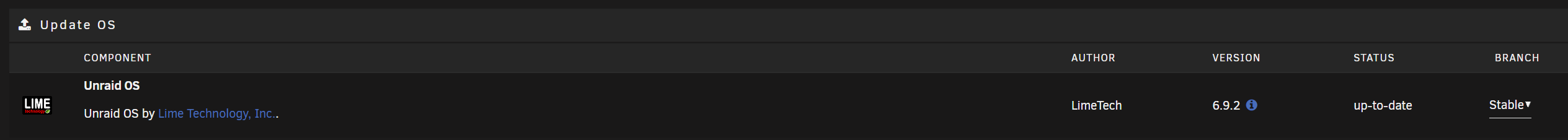

Thank you for the reply, I was looking for a way to upgrade to RC6 but I could not see it (currently running the trial version so may be why)
  • DeekB changed the title to 802.3ad Bonding - Private macs being generated by Docker.
It should not be an issue.
Go to Tools, Update and set the branch to Next.

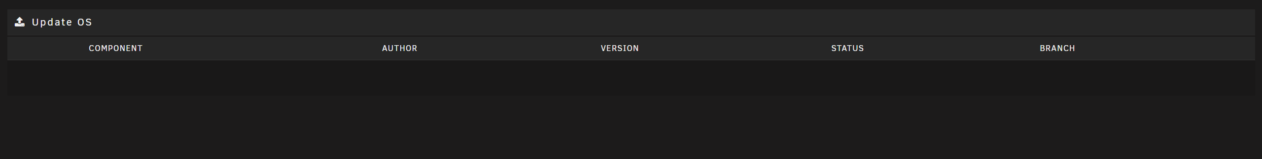

Thanks, I did try that yesterday but nothing was listed under the next branch for me.
Current branch:
When I select next branch it is showing blank.
Edited by DeekB

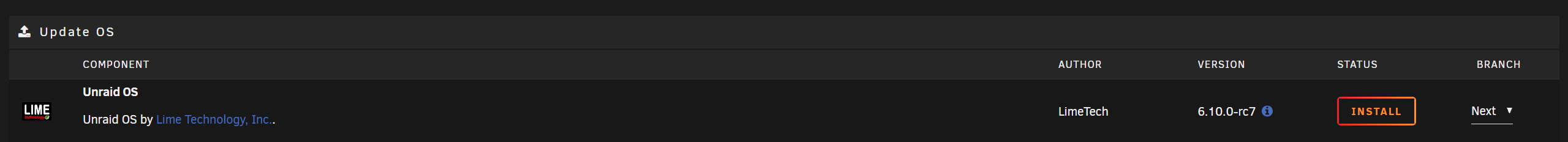

Seems I was just impatient yesterday as it just takes a minute or 2 to load.
image.thumb.png.a0444a65eaebdb93cac15eb6b05068c2.pngimage.thumb.png.97ea1c0eaecf459f7d1ee38a684c5a0a.png
Thanks everyone, now running the latest version!

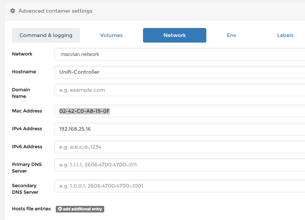

I was using portainer previously where you can set IP's and macs like so
image.thumb.png.4505ab427bcfe33f9bea7c8a6d6ae2ee.pngimage.thumb.png.fd7dbfe2e264906e23326f57991d735e.png
I see there is a portainer community app so just about to give it a try.

 Sorry for the delay in reply I spent a bit more time trying to understand what is going on here and I am pretty sure I have a good grasp of it now but not sure how to prevent it or change the behaviour.
The macvlan.network was configuration for one of my containers in portainer as part of the mac vlan driver, what I was trying to demonstrate with above is that using the mac vlan driver you can specify what IP address to give your container (Similar to what we have in unraid) this means any time you deploy your container it will always have the same static mac and IP that you have define as per my screenshot above (I guess the same functionality probably exists here in unraid as it is using the macvlan driver I guess) but its probably not opened to the UI for us to set that for each container but I dont see this as being a containe problem but an actual docker networking problem which I will try my best to explain below.

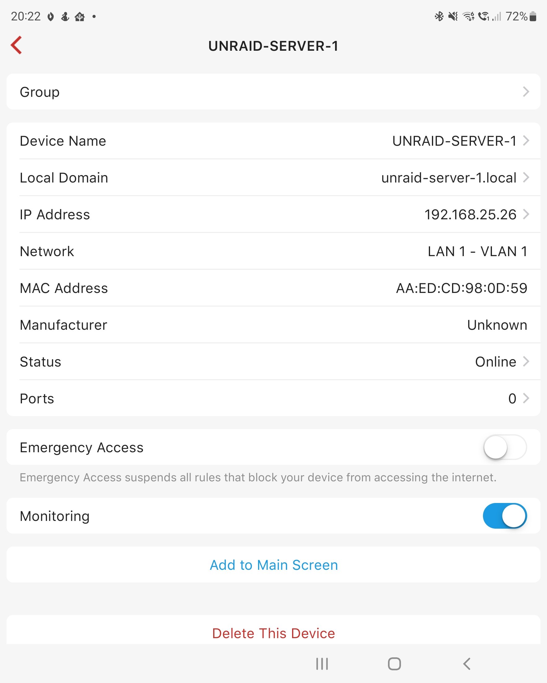

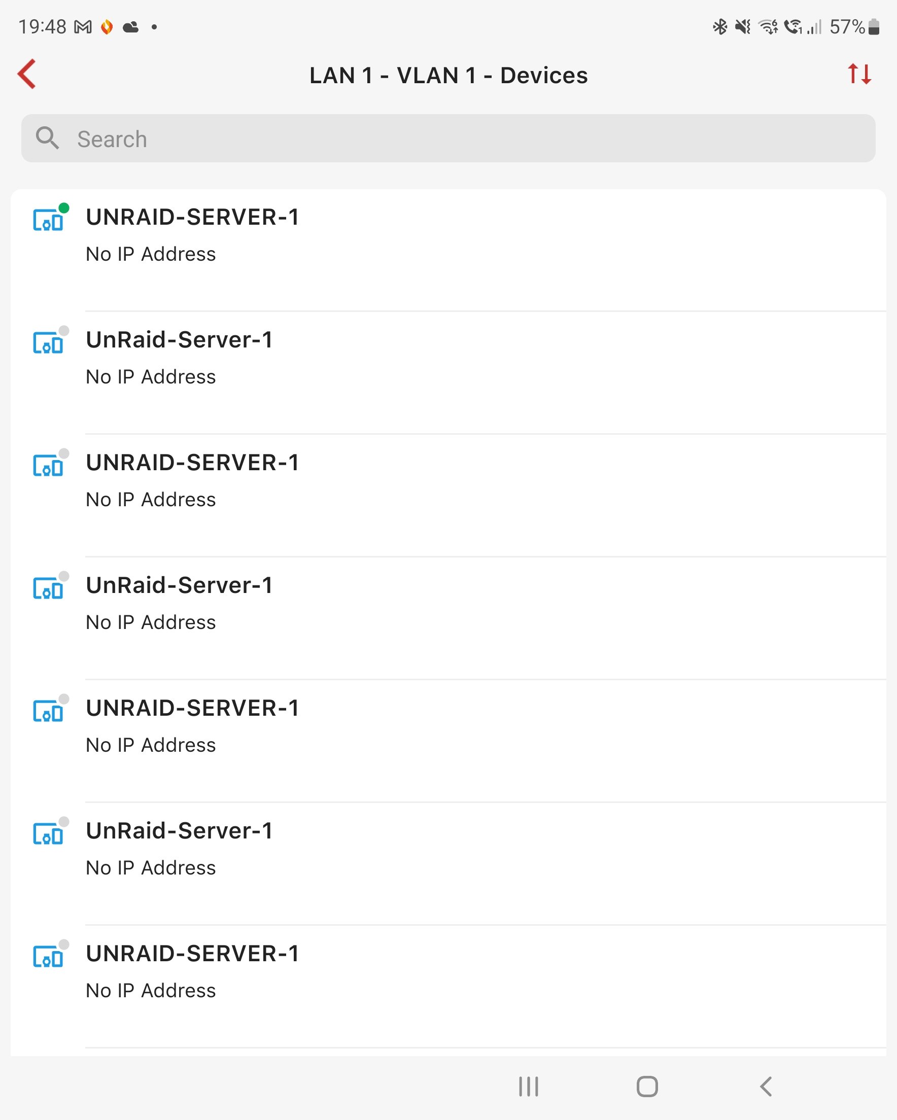

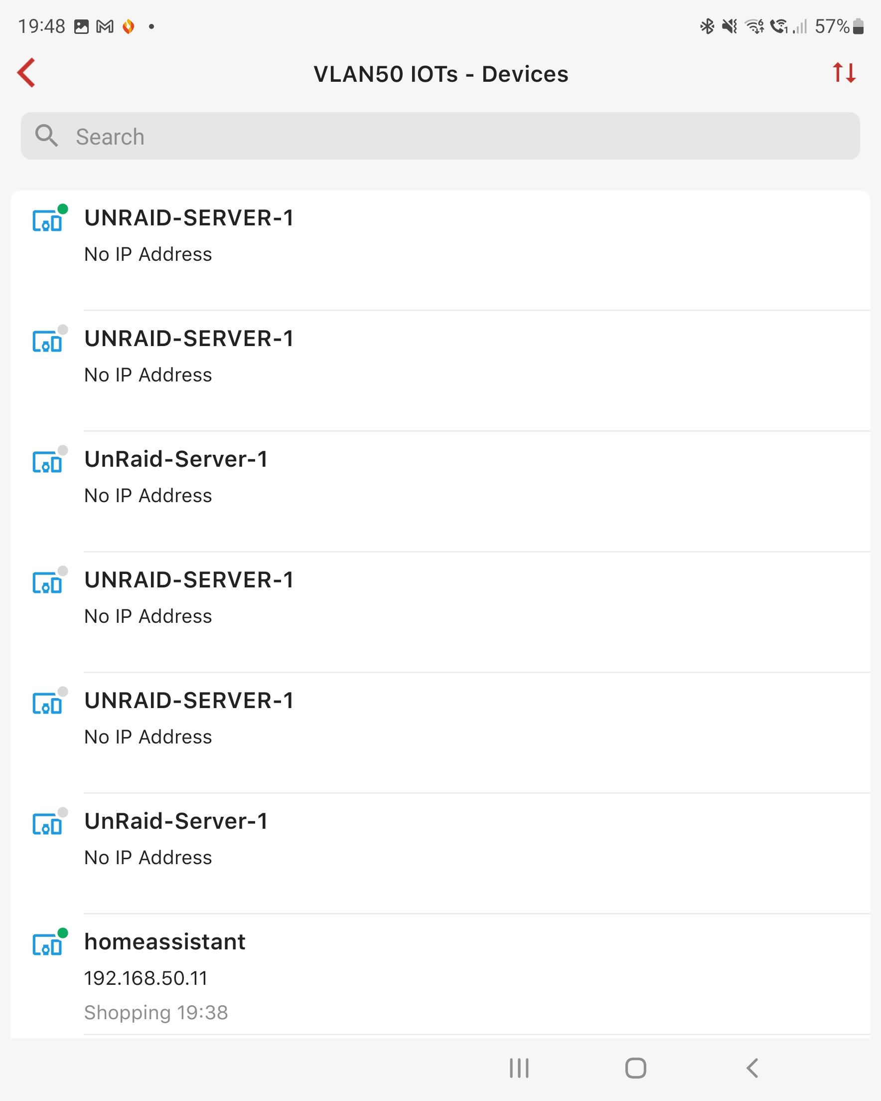

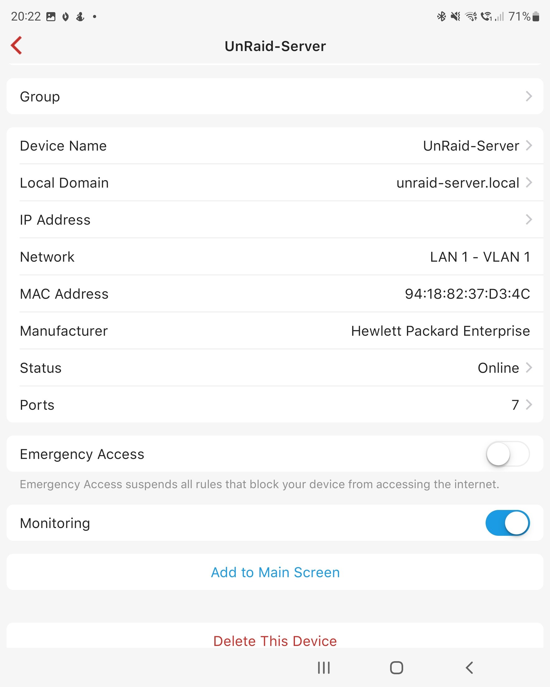

The problem I was and I am still having with the private mac addresses, if I start & enable docker it will bind to whatever networks you have told it to, when that happens it is then giving me a private mac, after each restart of docker this mac changes which is causing me lots of issue on my network as I have a fair bit of security set up there which I have had to disable to allow things to function which is not really ideal for me, not to mention every time I get a private mac it shows as a new device in my router as its tracking devices via macs so I end up with a new device on each of my networks that I am bridging into docker.
To make thing worse the bonding I had set up didnt seem to be working correctly which was resulting in the network connection being dropped every so often and when that was happening I would get a new private mac registered on the network which tells me its probably every time docker needs to reconnect it is somehow renewing with a different mac,  I removed the bonding so that I now have 1 network assigned to eth0 and another network assigned to eth2 (Both on different VLANS), removed all my docker containers and delete the docker v disk, I then started up docker to be faced with the same issue (A new device being registered on my network under the same hostname but with a new mac) so its down to docker for sure but not sure what can be done to prevent this, not sure why this is happening either as it never happened in my previous docker instance I was running on ubuntu server, I guess there must be a way to make this mac static, that would solve my problems but I cannot see an easy way to change that in the UI.
Hoping someone with a bit more unraid experience can help me out.
Here are some pictures of the issue I am facing in my router due to the private macs:
Screenshot_20220508-202205_Firewalla.thumb.jpg.08a079f393fa0e43537c0a08c2b2e833.jpgScreenshot_20220508-202224_Firewalla.thumb.jpg.00222bcba955c8e067f5d430980caf9d.jpgScreenshot_20220510-194807_Firewalla.thumb.jpg.fd94d763310e613008611ee7122911dc.jpgScreenshot_20220510-194821_Firewalla.thumb.jpg.7cf25968de0a2f0f84d77f9a61236890.jpg

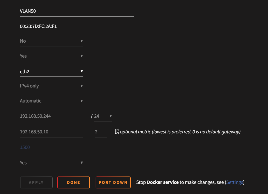

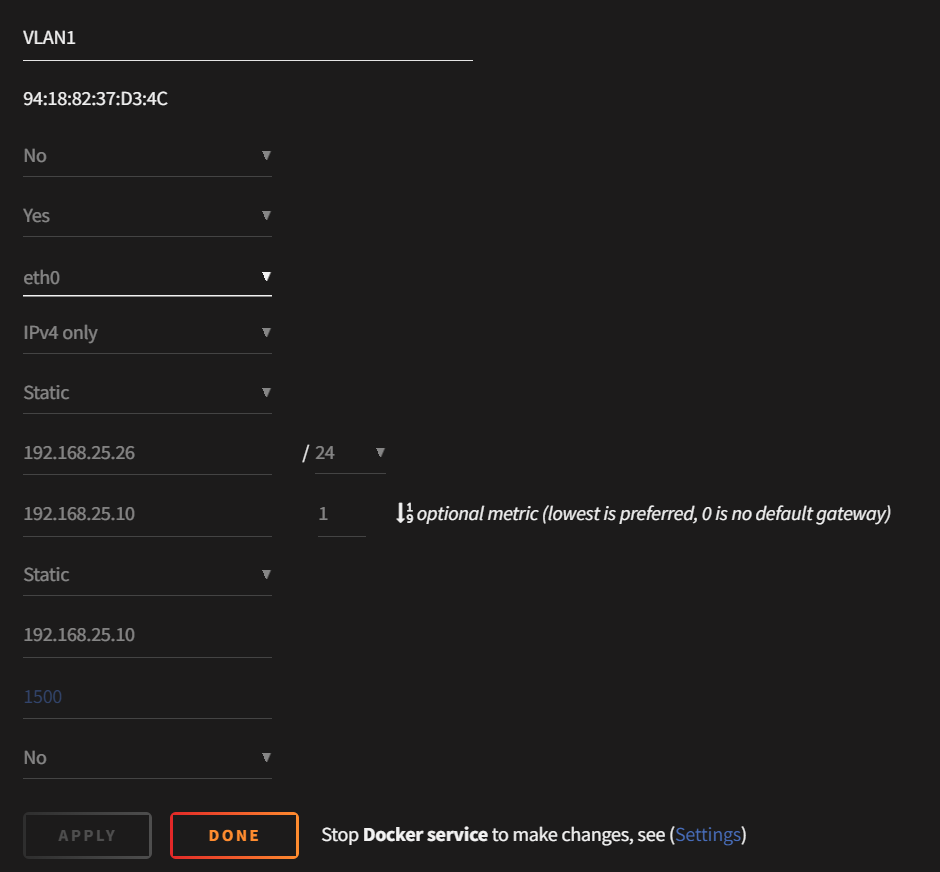

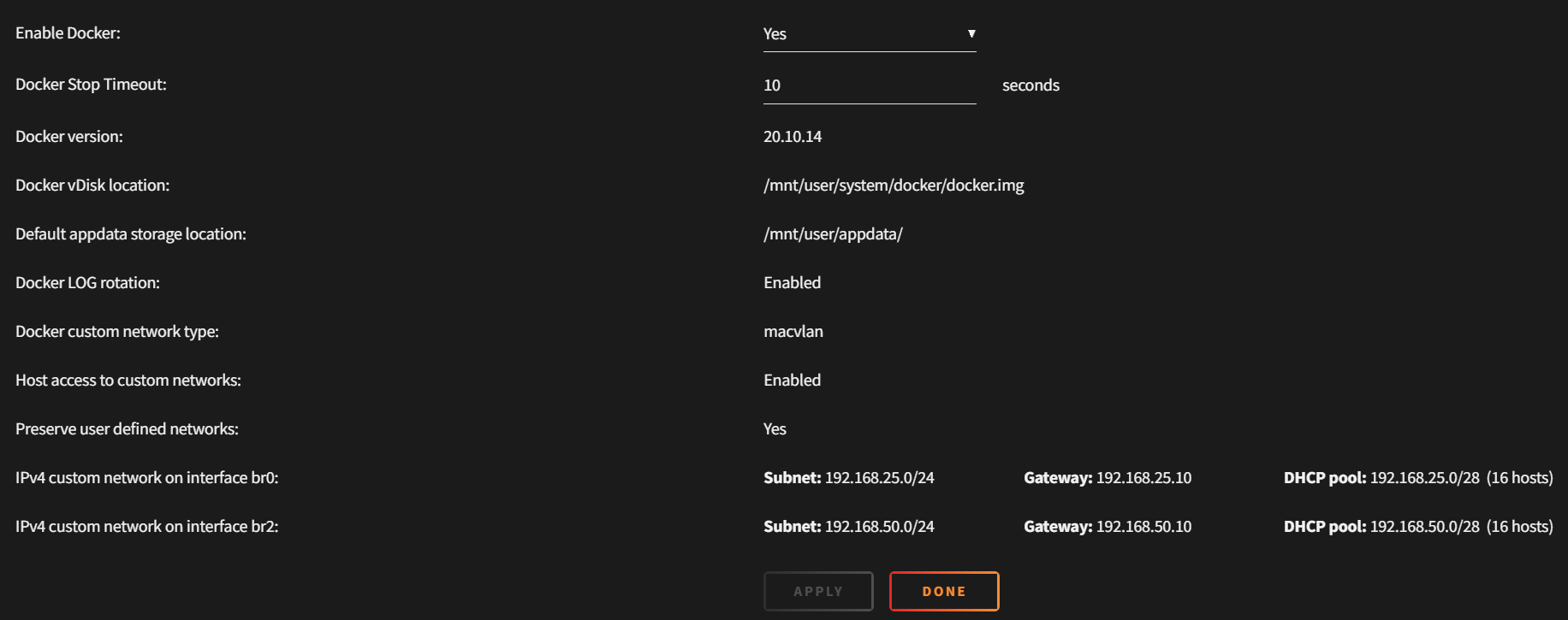

Here are some screenshots of my network and docker network config.
Vlan 1 NIC (No bonding)
Vlan 50 Nic (No Bonding)
image.thumb.png.c12da6df97825eb241a37cccf360e429.pngimage.thumb.png.07c98c32e45340bc70e1c4d194a75ad1.png

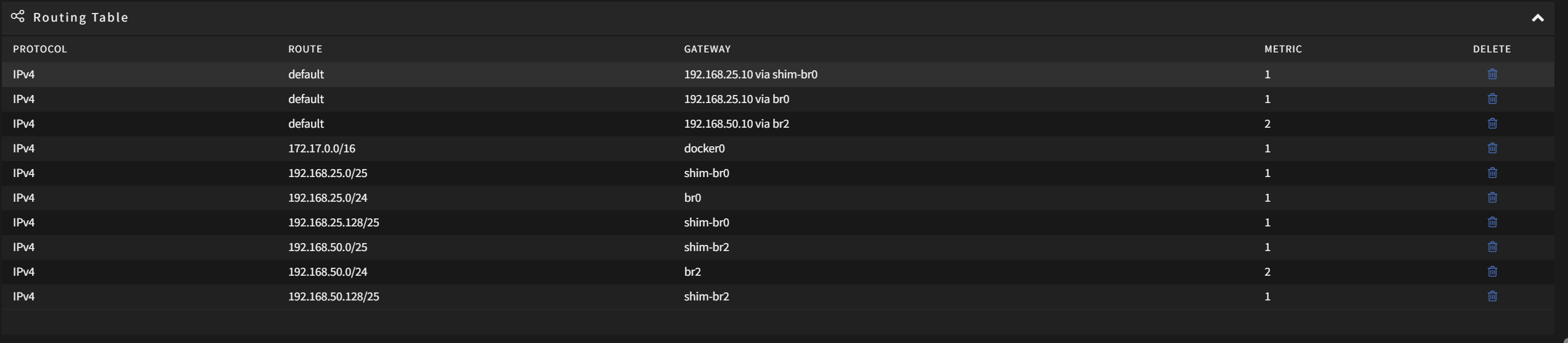

routing table
image.thumb.png.af52ffa6776b1ae8fe0a877a830cab78.pngimage.thumb.png.f566aeac2f48757f430cdb27daa88af4.png
Docker br settings:
image.thumb.png.c24c5ff34ed62cf00d7a5f22bd64ed6a.pngimage.thumb.png.379c9afe4ed62df60b040f6587c69303.png

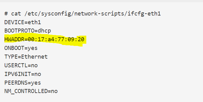

I was reading this and wondering if this is possible with unraid
https://access.redhat.com/solutions/70215
Add MACADDR= directive and specify the required MAC address to the /etc/sysconfig/network-scripts/ifcfg-ethX network configuration.
Like so:
image.png.9bbe6f1c65338eb7fa6d316170d2cc57.pngimage.png.072f0cc449eaa2996d7fb3804a219e9a.png
but guessing the file location may be different in UnRaid
Edited by DeekB
