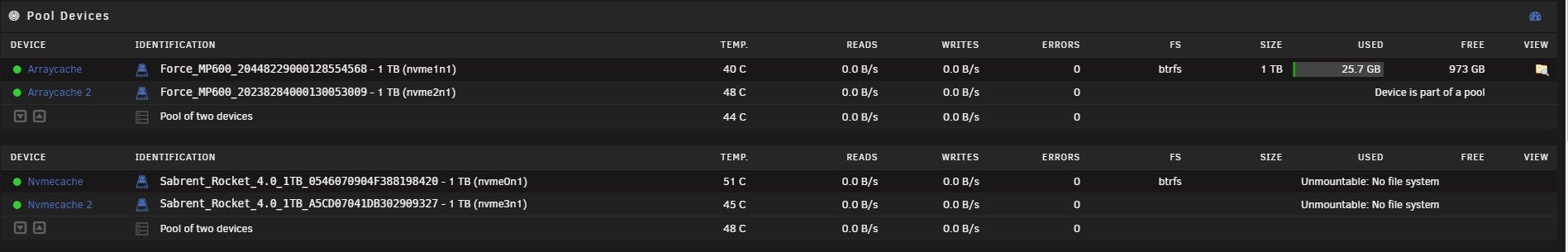

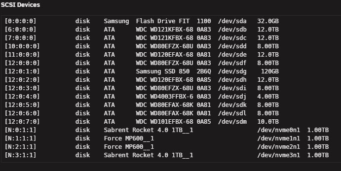

I have two Cache Pools. One called Arraycache and the other called nvmecache. They both use NVME drives.
They are supposed to be Raid1. They have identical drives in each cache pool.

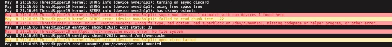

682925509_Screenshot2022-05-08215746.thumb.jpg.095c8f3b49df0a7963197a678bef3cb8.jpg1553949903_Screenshot2022-05-08215907.thumb.jpg.205dcb5f0af395fd1672ea74a1cf6ce7.jpg
1002974962_Screenshot2022-05-08221148.jpg.b3f63805b2db27ddf40222a0fce3d99d.jpg1796624025_Screenshot2022-05-08221233.jpg.521eb200d9d561751103f75cf250f39a.jpg27815356_Screenshot2022-05-08221252.jpg.f95bc845c0d16e2d294ffce63e022dcf.jpg

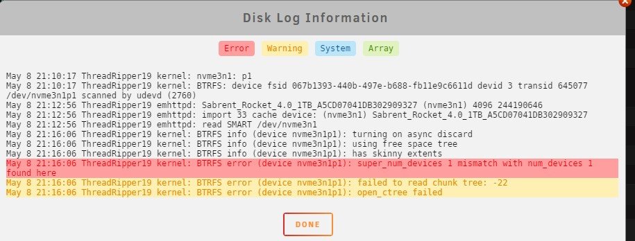

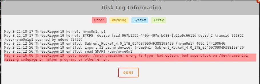

May  8 21:10:17 ThreadRipper19 kernel: BTRFS: device fsid 067b1393-440b-497e-b688-fb11e9c6611d devid 3 transid 645077 /dev/nvme3n1p1 scanned by udevd (2760)
May  8 21:10:17 ThreadRipper19 kernel: BTRFS: device fsid 067b1393-440b-497e-b688-fb11e9c6611d devid 2 transid 291831 /dev/nvme0n1p1 scanned by udevd (2792)
As you can see the transid of one of the devices is way off, it should be the same for all pool members, note the other pool below:
May  8 21:10:17 ThreadRipper19 kernel: BTRFS: device fsid 565f4d7d-1b62-4a67-9414-ac108e2553f3 devid 3 transid 31253 /dev/nvme1n1p1 scanned by udevd (2741)
May  8 21:10:17 ThreadRipper19 kernel: BTRFS: device fsid 565f4d7d-1b62-4a67-9414-ac108e2553f3 devid 2 transid 31253 /dev/nvme2n1p1 scanned by udevd (2727)
The difference is so large that it couldn't happen if a device lost a few writes, so likely some corruption happened here, also note that Ryzen with overclocked RAM like you have is known to in some cases corrupt data, so suggest fixing that.
You can first try restoring the superblock from backup to see if it helps, do it both both pool devices:
btrfs-select-super -s 1 /dev/nvme3n1p1
btrfs-select-super -s 1 /dev/nvme0n1p1
Then reboot and post new diags.

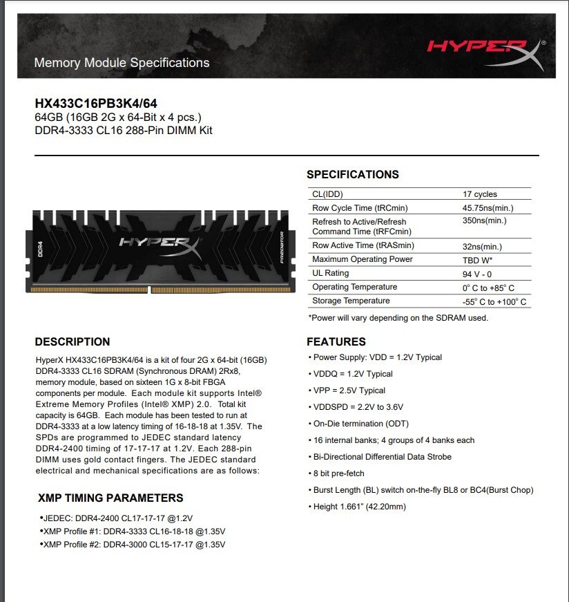

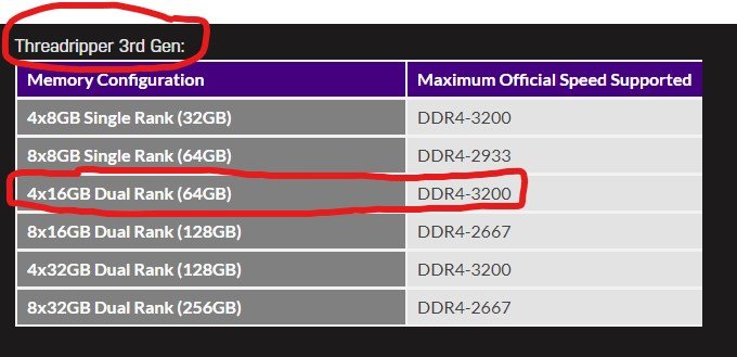

I didn't even think to turnoff the memory overclock. Thanks for the FAQ link to that.
Here's the memory I'm using:
and according to the FAQ:192427089_Screenshot2022-05-09101501.jpg.9e44ce66da2448e652d78938b9200997.jpg
I should only go as high as DDR4-3200.
Wondering if I should just turn off D.O.C.P and let it run at its base speed of 2400 at 1.2V
or
manually set the memory to 3200 at 1.35V?
I turned off Global C-State, but couldn't find anything in my ASUS ROG Zenith II Extreme Alpha bios for the "Power Supply Idle Control".
I also turned off ErP Ready in my bios.
I'll reboot with memory set to the default of DDR4-2400 and try restoring the superblocks then send you new diagnostics.
Thanks

The nvmecache pool mounted and I can see my data, unfortunately the data isn't all there.
The music share isn't that big of a deal. I can always re-rip that stuff, but I don't know about the appdata or system shares.
Just noticed that I won't be able to restore my appdata because I had 'Delete backups if they are this many days old:' set to 15.
I never noticed that there's no option in Backup/Restore Appdata utility to 'Keep' a certain number of backups. Seems really silly to not have an option to keep a certain amount of backups.
How will that affect my Plex docker?
What about my system share and the dockers in it?
That's not unexpected, one of the devices had a bogus large transid, any data that was saved with a transid larger than the actual one would be lost.
