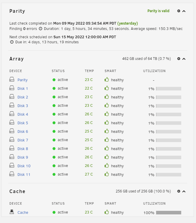

Cache Drive reached 100% never moves data to array.
I have a 256GB nvme cache drive that reaches 100% and never moves the data to the array. What are the common reasons for this? steps to troubleshoot? cheers.

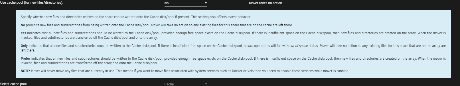

Read the cache : prefer section of the help, see if that explains things better. If it doesn't, please ask for clarification.

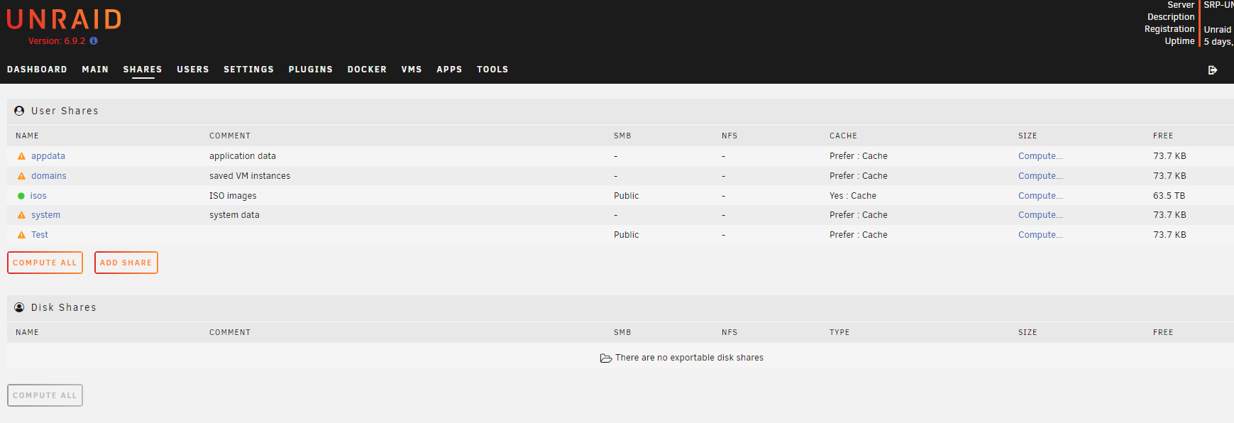

The only share you have set to move files to the array automatically is the ‘isos’ one (use Cache=Yes) and it already has all of its files on the array.  All the others are set to Use Cache=Prefer which indicates you want those files kept on the cache pool if at all possible.
You have also not set a Minimum Free Space value for the pool, so that when the free space falls below this value Unraid starts writing new files for shares with either a Yes or Prefer for Use Cache setting directly to the array bypassing the cache pool.   Not having that set allowed the cache pool to completely fill up.
