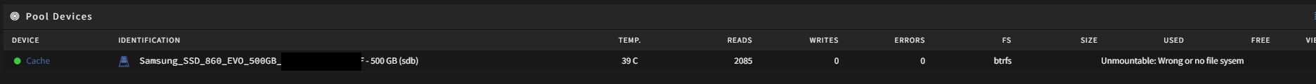

these are  error that I have in log of cache disk:
ay 18 06:32:50 Tower kernel: BTRFS error (device sdb1): devid 2 uuid b7a2b6e5-effb-48f3-8fbe-34b212a45d2c is missing
May 18 06:32:50 Tower kernel: BTRFS error (device sdb1): failed to read the system array: -2
May 18 06:32:50 Tower kernel: BTRFS error (device sdb1): open_ctree failed
May 18 06:32:50 Tower root: mount: /mnt/cache: wrong fs type, bad option, bad superblock on /dev/sdb1, missing codepage or helper program, or other error.
Do you think that I lost all cache data ?

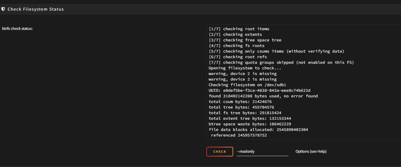

Now it won't work since the pool is not mounting, I asked before rebooting, but it doesn't matter now.
Stop the array, unassign al pool devices, start array, stop array, run
btrfs-select-super -s 1 /dev/nvme0n1p1
Reboot and post new diags before array start.
Now start the array with both cache devices unassigned, then stop the array, assign both devices to the same pool, start the array and post new diags, if it mounts there's a chance the fs will go read only again, if that happens we can try to mount manually with skip_balance.
It works :-)))) I'm so happy thanks a lot .
