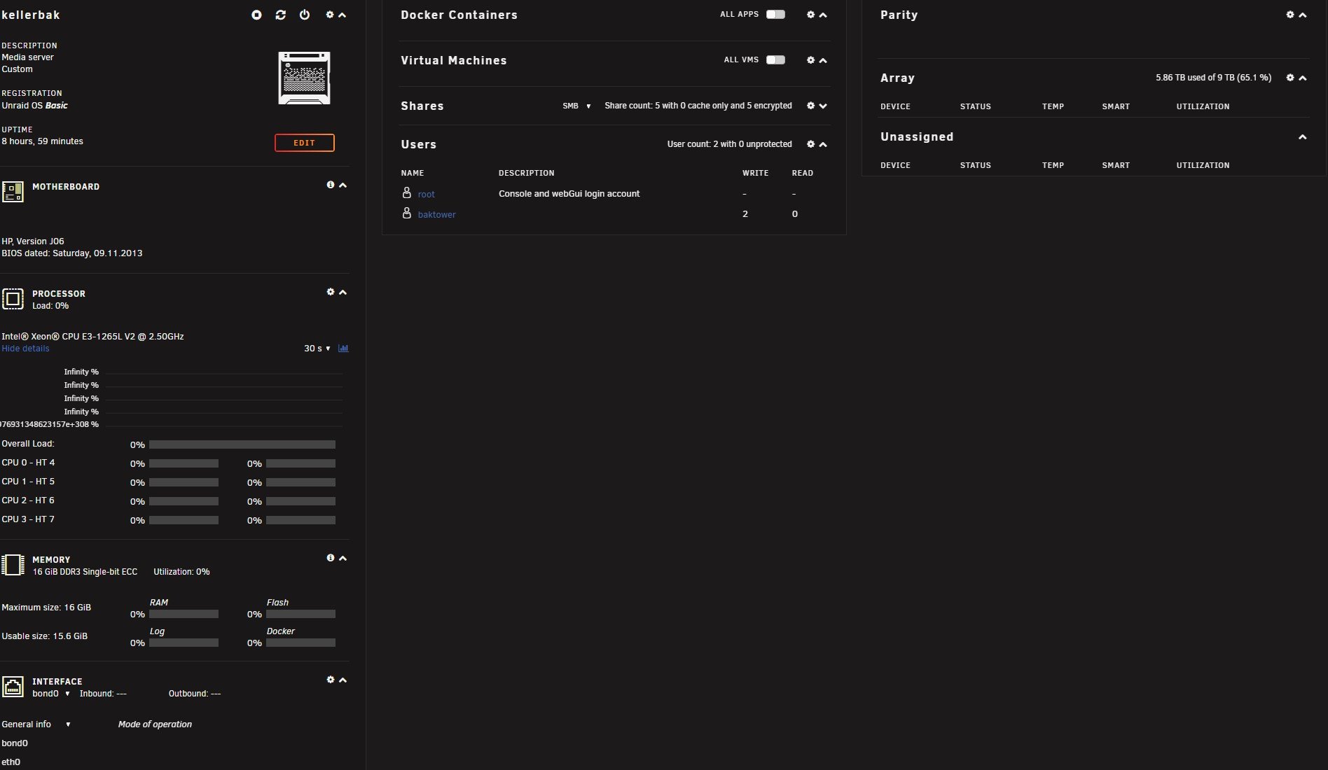

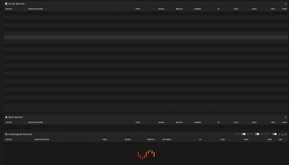

I switched my backup server to 6.10 which seemed to have worked okay until I started the upgrade of the certificate.  Now my whole array and all drives are missing.
1082280555_Screenshot2022-05-18082440.thumb.jpg.08a872395bde00dec71ab33abc0d7e9e.jpg1214860377_Screenshot2022-05-18082507.thumb.jpg.a13d0f5b3b414c8fdfbb86a339777555.jpg

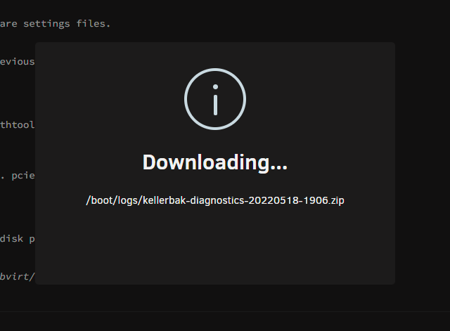

It just opens a window where a lot of text scrolls by and then it reads like this

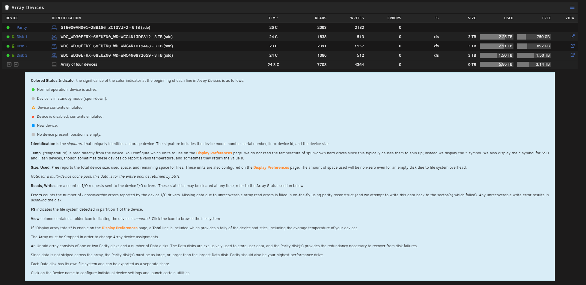

After restarting another time, things look a lot better. I was able to start the array and everything seems okay except there are blue text boxes everywhere and my VMs are gone.  Could attached the diagnostics file this time
kellerbak-diagnostics-20220518-1128.zip
Blue text is because you turn on the help, VMs might me missing if the Kingston SSD was your cache device, it's not assigned.
The SSD was not the cache.  It assigned it to the VM.  Dunno why the VMs gone but it should be easy to recreate it unless you know a better way to restore the settings.

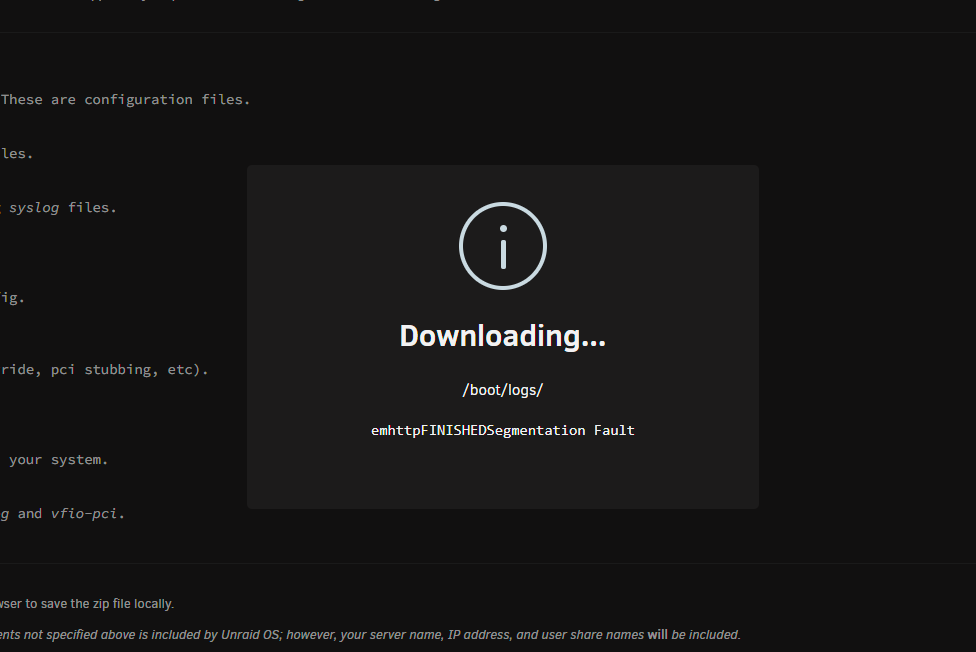

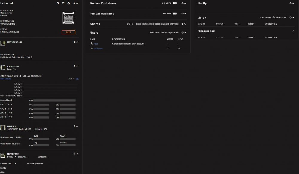

Now it's stuck again on this screen -.-
image.png.b6306a278be8a3c680e50dbdc1cb6e2b.pngimage.png.a98826233bb86492aab8b81f8d838790.png
Try typing "diagnostics" in the console, if that also fails copy the syslog to the flash drive:
cp /var/log/syslog /boot/syslog.txt
then attach here.
OK, here it is
awk: cmd. line:1: (FILENAME=/kellerbak-diagnostics-20220518-1941/logs/syslog.txt FNR=35) warning: Invalid multibyte data detected. There may be a mismatch between your data and your locale
syslog.txt

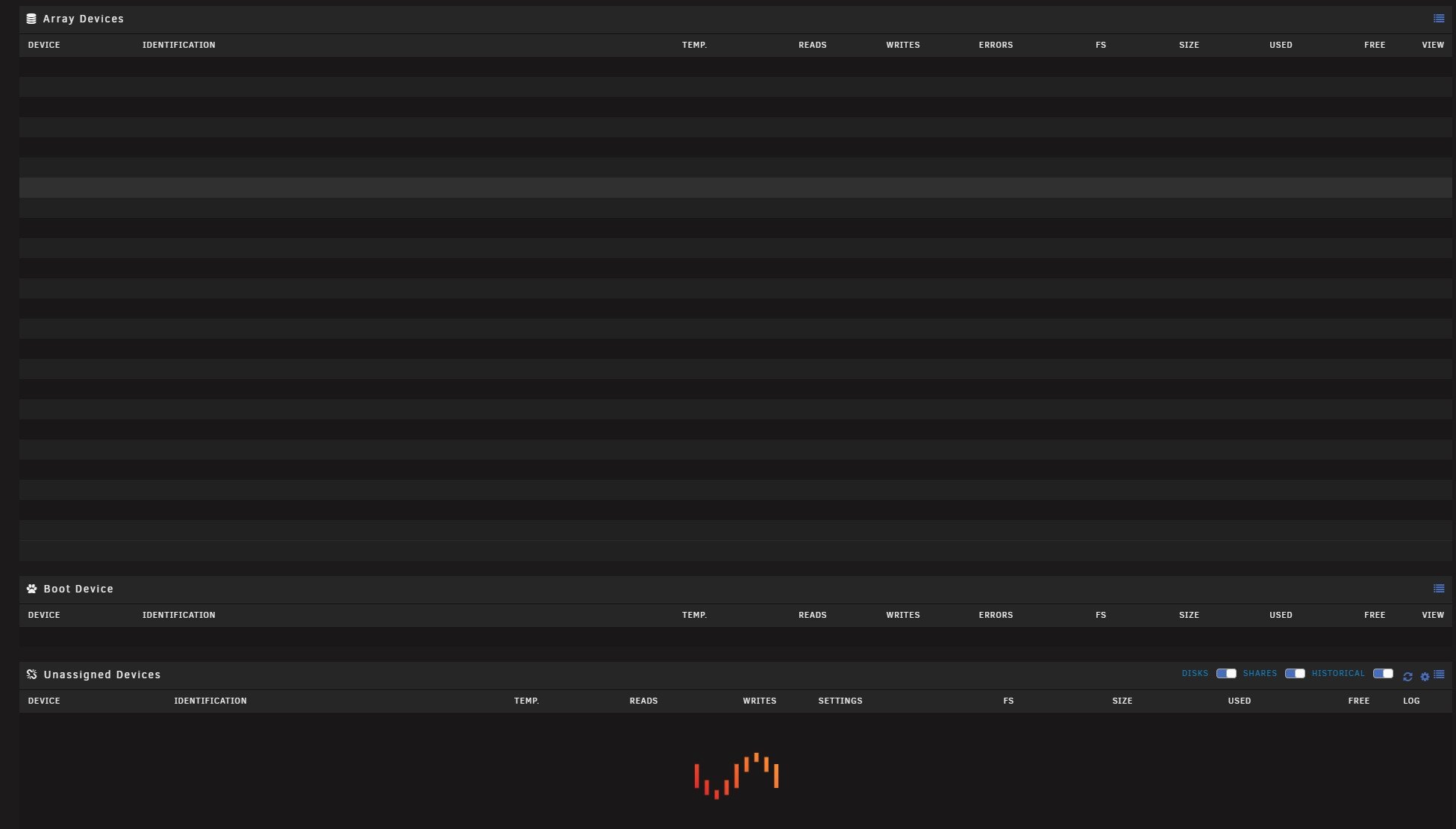

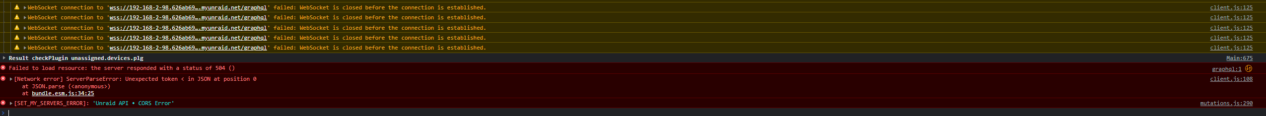

Also getting this error output in UI (the list of disks is empty but then suddenly the drives appear)
Edit: The errors appear in the browser console
Edited by Arragon
You are having some strange issues, first try booting in safe mode, if that doesn't help I would consider re-creating the flash drive and start with minimal config or re-configure the server.
Are you sure?  It seems like everything is working now.  The UI glitch is a bit strange but after a while the drives etc appear.  I was also able to recreate the VM without a problem.
