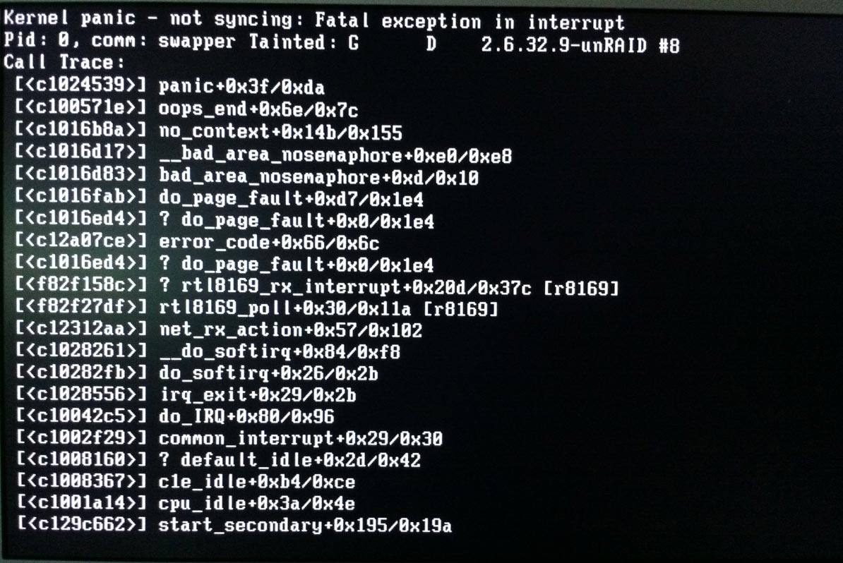

Hi I'm wondering if someone can take a look at this kernel panic message and provide any words of wisdom or even vague ideas. I seem to be able to make copies from my Mac Finder windows to the Unraid server with no problems, but whenever I use the backup program Such as carbon copy cloner or data backup the Unraid server freezes and I have to reboot.
It might be worth noting that I have recently downgraded from version 5.0.6 Beta back to 4.7. I am wondering if I should just do a complete  clean reinstall of 4.7–––but I'm concerned that I would lose all my shares in the process. Is there a way to reinstate existing shares after doing a clean install of Unraid?
I've attached a JPEG as I cannot capture syslog after the system is crashed.

What is the hardware you are using? Which mobo and are you using the onboard nic? Some of the messages seem to indicate RTL8169 - most likely your onboard nic. Some of us have had same issues with Realtek and transfering large amount of data. System freeze. Put in a external NIC card (like an Intel chipset), disable onboard and all is well.  Could be the reason...

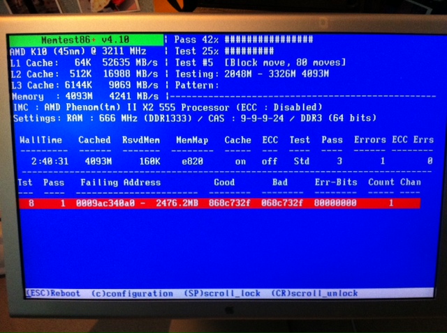

there should never be errors in memtest.  Pull a stick and run memtest again one stick at a time.  When one of, or both, sticks fail replace them.
I tested one stick of RAM at a time, sure enough the first one was bad. I am running a pretty big back up now and so far so good.  I also ordered a new Intel-based NIC card should be here tomorrow and will try that and report back as well.  Thanks for all your help I really appreciate it. Should've posted to the board much sooner.
Every backup I've run since replacing the RAM has been flawless. Thanks for the suggestions–as obvious and simple as they might've been to you they were pretty important to me, I do appreciate it.
