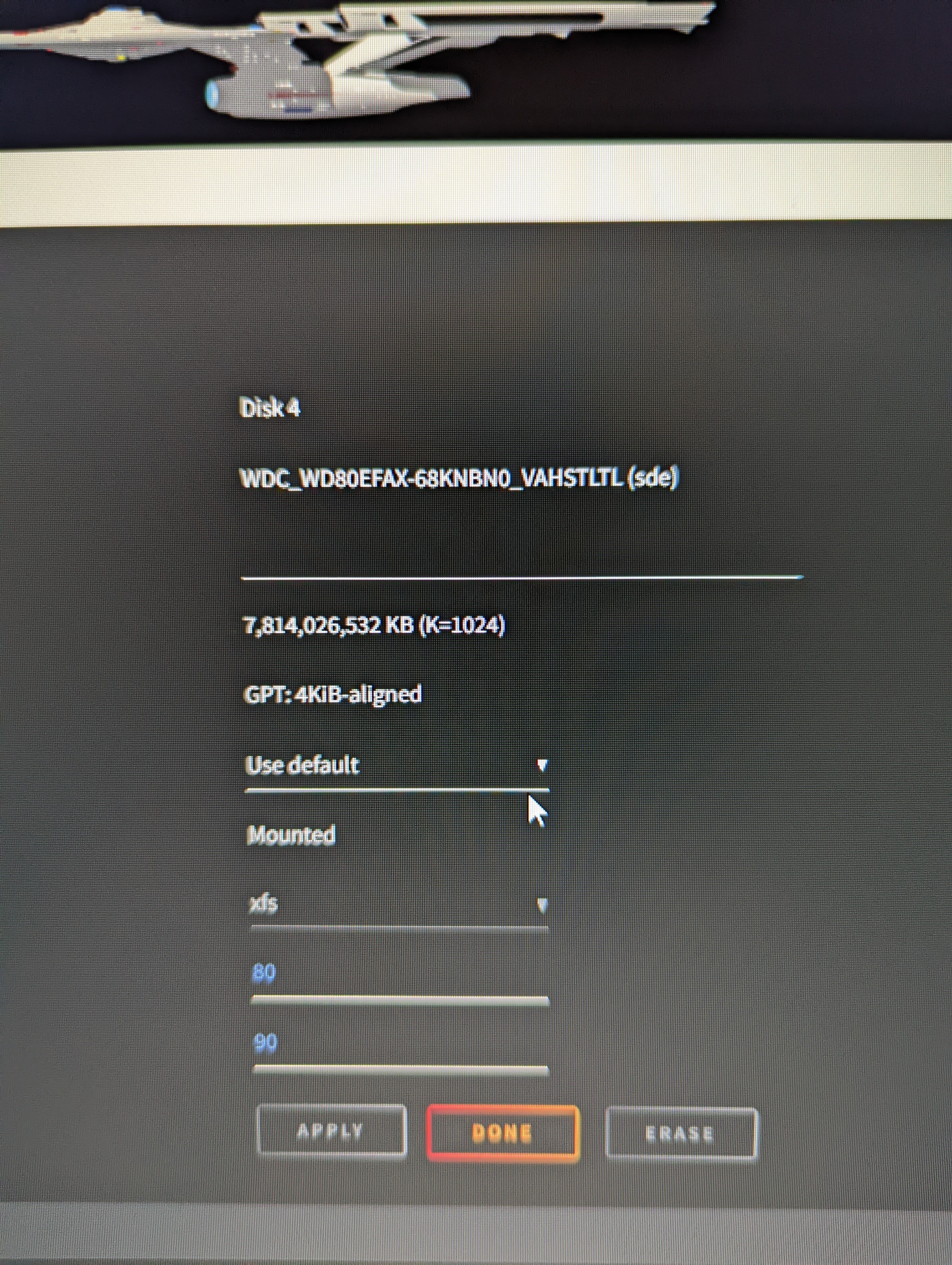

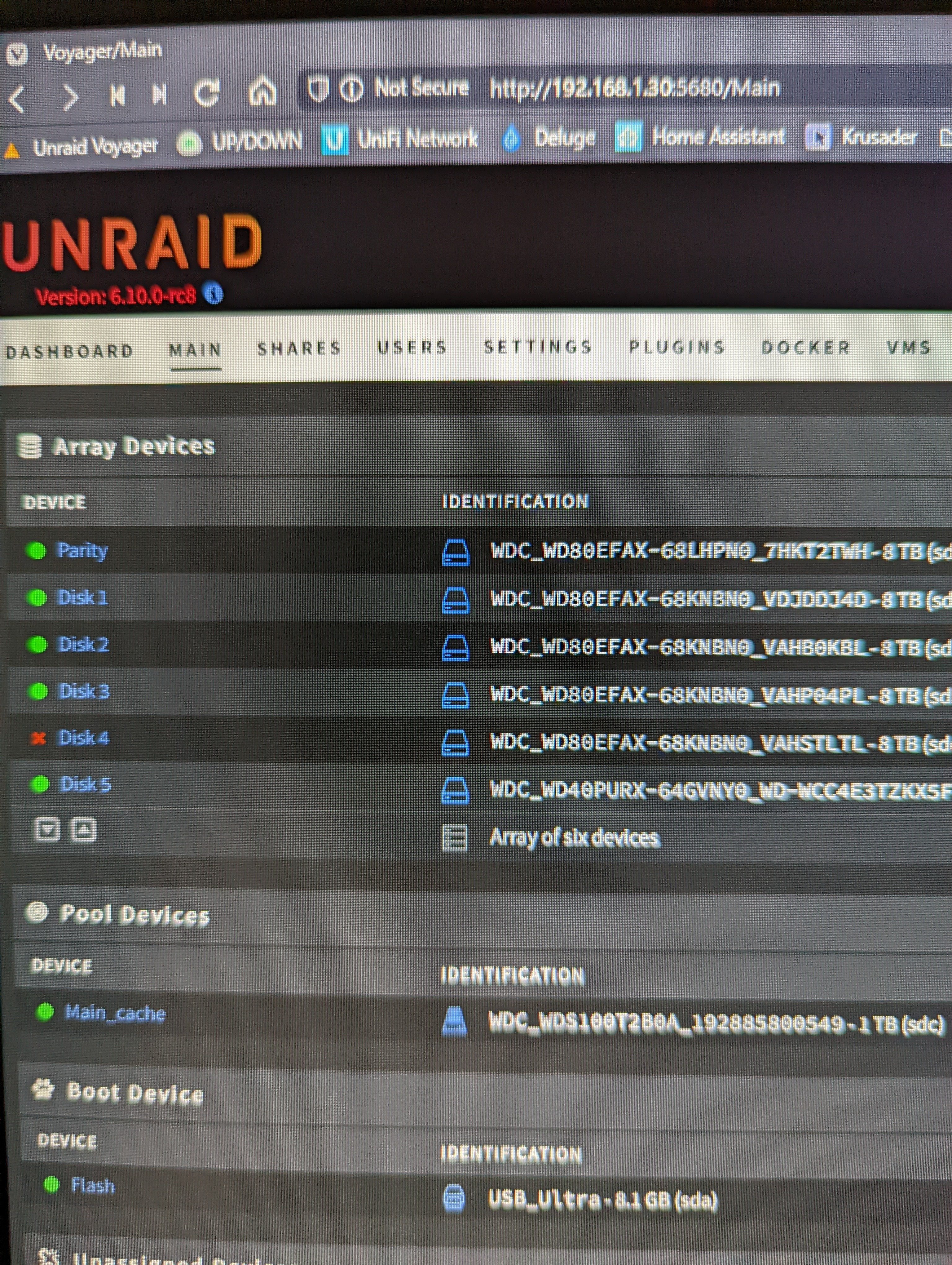

I've run the -L and restarted. My Disk4 no longer shows that unmountable error when I go to the disk settings but on my list of array drives it still has an "X" and when I hover it says "device is disabled, contents emulated"
