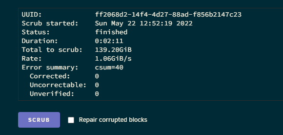

You now should also run a correcting scrub on the pool.

Click on cache on the main page then scroll down until the scrub section.

FWIW, I ran the scrub and this is what shows
Edit: Ran repair right after and all corrupted files are plex phototranscoder files.   So no big deal with those.
