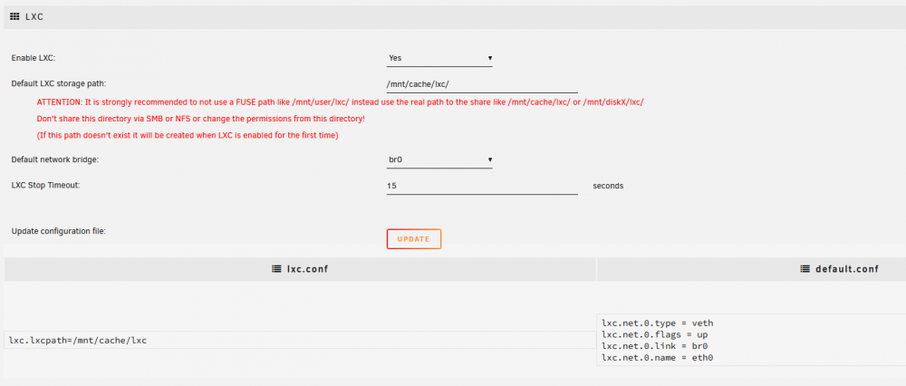

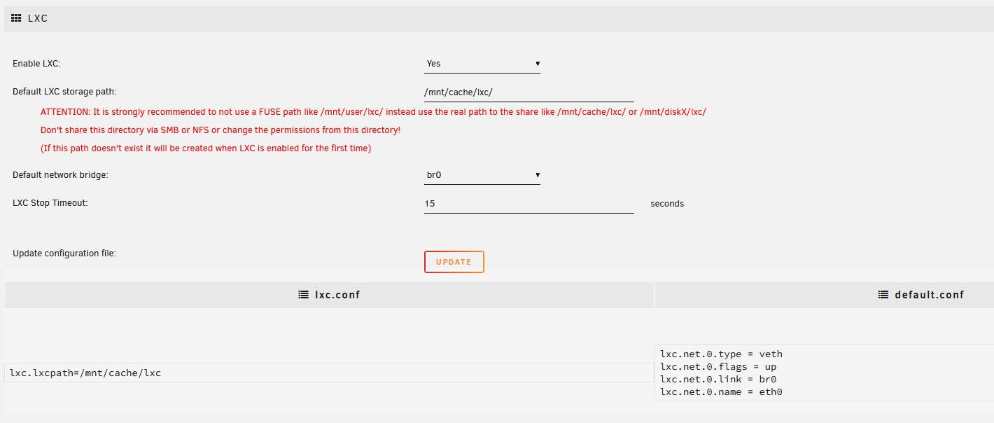

13 minutes ago, Peelson said:
not yet
What path have you choosen for LXC?
Please keep in mind that I never recommend that you don‘t use the FUSE path /mnt/user/… always use the real path like /mnt/cache/… or /mnt/diskX/… (like described on the plugin configuration page).
I‘m sure I used /mnt/cache/...
