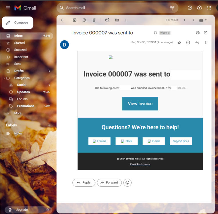

mailing and logo is not working on this container

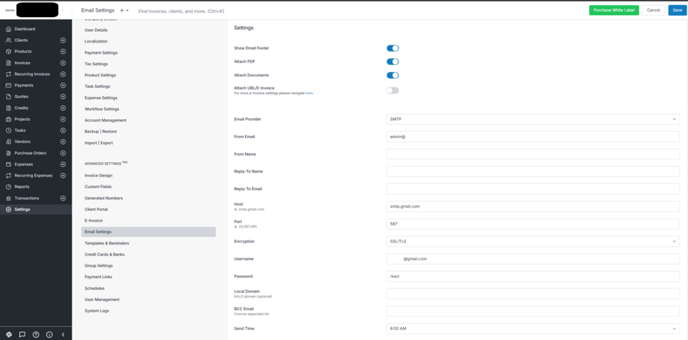

I finally got invoiceninja-v5 to work with domain name via swag.  Now PDFs are finally working. It's working with desktop app as well.  The only part that I'm not sure yet if it's working or not is the email, but I don't need to email so it's not a problem for me.  See nginx config I used below.  Also attached is the screenshot of container settings.
I'm not sure about the MAIL_MAILER variable, so that could be my email issue.  I did change the default "Storage" label to "App Storage" and changed the default "Logo" label to "Public Storage" and used a path to a share instead of the path inside of appdata because I realized that this is the path that files, backups and pdfs are being saved/stored.
Hope this helps anyone who may still be having issues with invoice ninja.
