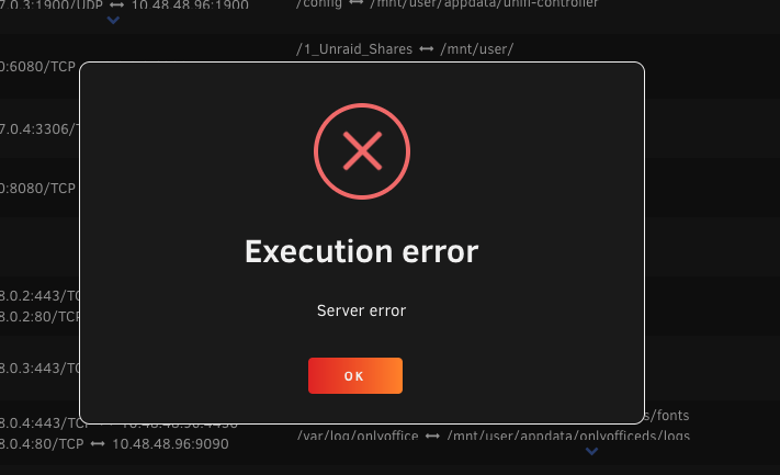

Hello @Mihai,  After I updated Unraid to version 6.12.3 I realized the invoiceninja is not starting.  I get an "execution error" "server error" whenever I try to start the container. If I try to pull the container again, I get the following error:
docker: Error response from daemon: driver failed programming external connectivity on endpoint invoiceninja-v5 (e23929c8306f014445db778e1d5f00d6064fad93a957c18c6d6b0f2bf4e86424): Error starting userland proxy: listen tcp4 0.0.0.0:8443: bind: address already in use.
Please help
