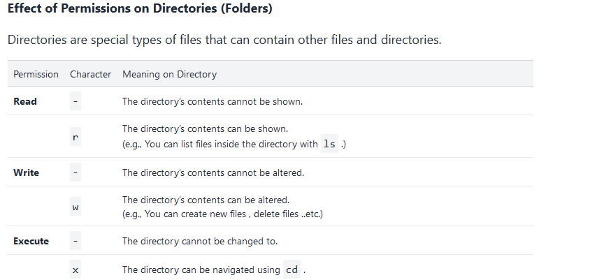

All of the files that are missing from the SMB listing on on disks 12 and 13.    You need to go down the path from the root of both of these drives  to the 'Decrypted  3DS Games" directory layer-by-layer and look at the Owner, Group and permissions for each directory in the path for both drives.
Theses should be as shown in this screen capture:
These are the permissions, the Owner and Group attributes that you should see for each directory as you move down each layer.
