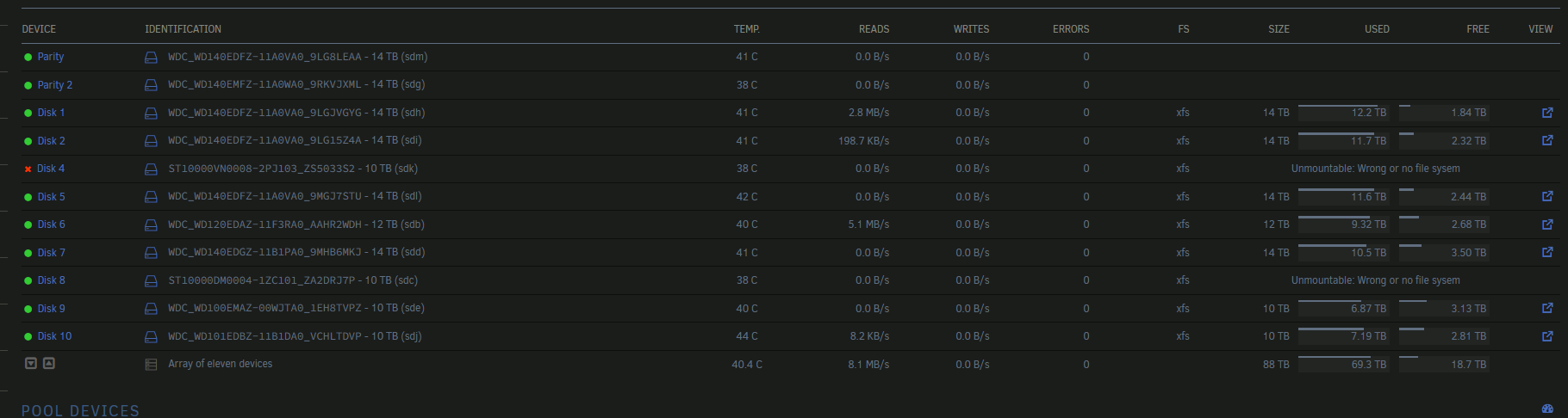

Hello,
Today I received a message that disk 4 had errors on it. I looked at the smart report and it had a bunch of UDMA CRC errors, so I thought it was just a bad connection and was no big deal. I tooked the array down, to take it out, but it got stucked, so I did a normal reboot (with the GUI). When it came back online it now shows that another disk has an unmontable file system, and the errors of the first one disappeared.
As you can see both drives are Seagate drives. All the other drives are connected to a HBA card, but those two where having problems with it so I connected them directly with sata cables.
What's the best approach I can take dealing with this situation? Do I try changing the cables, the port and just start rebuilding? I cannot understand why another drive went unmontable.

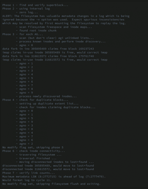

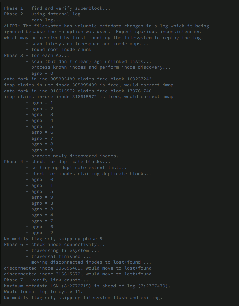

Ran a test run of xfs_repair on disk8 the results are as follows:
Do I now run the check without the "-n" option, should I add any additional option?
Yes, and only if it asks for it use the -L option.

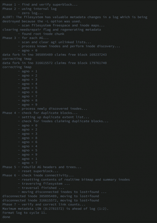

Ok, just did (had to add the -L option) and this is the result. The disk still shows as unmontable

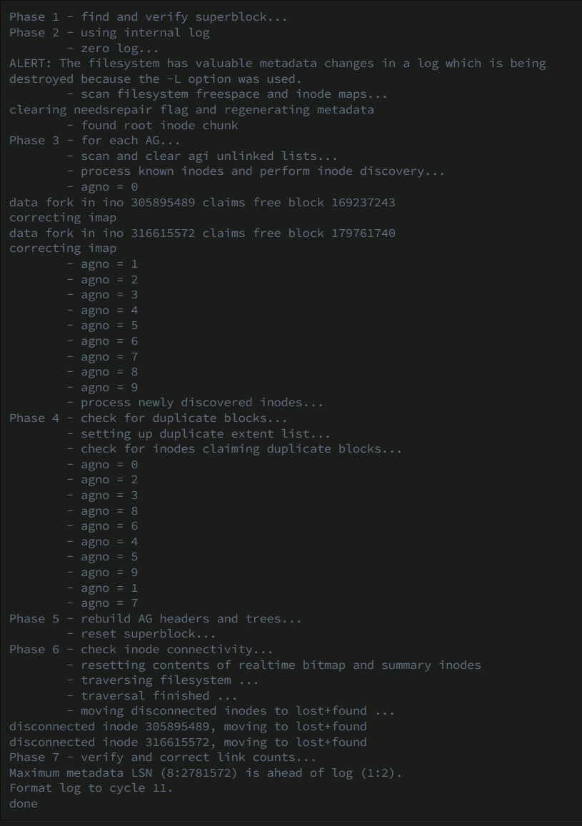

The repair is done (it took a long time!) I uploaded the results in a file below, but it looks that a lot of things happened.
Don't know if it would be wise to just start the array with this drives. What do you think?

Not looking great, but just start the array as is in normal mode and check the contents of the emulated disk4, look for a lost+found folder and see if there are many things there.
Disk4 just have the lost+found folder which has 990 files on it:
