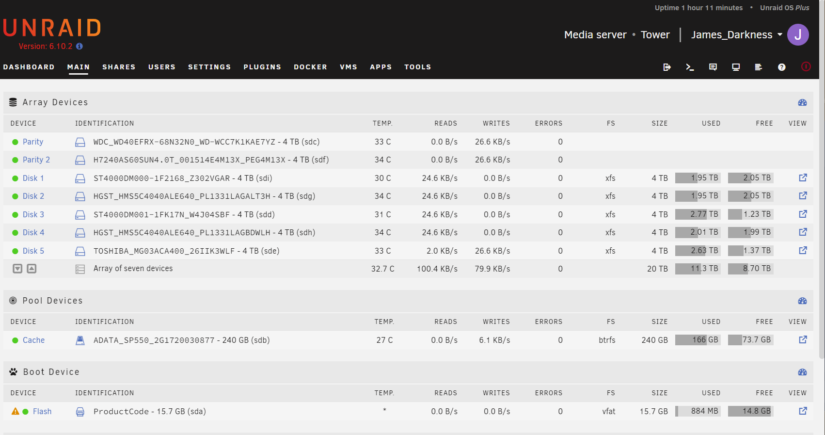

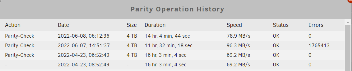

Parity error (I think)
so after i moved my server my usb flash drive failed on me along with a sata cable for my
Parity drive two. after getting another flash drive i booted the server up with only one
Parity drive. after that flash drive failed shortly after I'm on my 3rd usb flash drive and i also got a new sata cable. but my drives are gray instead of green so i did a Parity Check with the "Write corrections to parity" check box off it found errors so i ran it again with Write corrections to parity on but it found no errors.

1 hour ago, James_Darkness said:
did a Parity Check with the "Write corrections to parity" it found errors
So you had it correct parity errors?
Then there were no parity errors because they had already been corrected on that previous check?

I think the most likely explanation is you had parity errors for some reason, you corrected those, and now parity is correct.
One thing that can cause inconsistent parity checks is bad RAM, but it looks like your parity checks are consistent now.

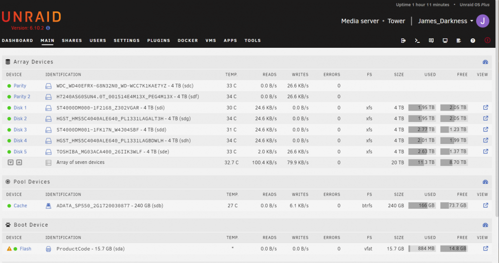

I know why I had parity errors I was using only one of my two parity drives. my parity drive two sata cable broke so for a few days i ran it with only one drive and put in the new cable a few days later. but all my drives are gray instead of green right after that. should I or can I force a rebuild of my second parity drive to fix this issue
Your description of what you did with parity2 is lacking enough details to know what happened.
If you ran without parity2 and without doing New Config to remove parity2 from the array, then parity2 would have become disabled when it couldn't be written. If you did remove parity2 with New Config, then it wouldn't have become disabled since nothing was assigned as parity2. Either way, if you reassigned parity2, it would have been rebuilt when you started the array.
If you aren't still getting sync errors then parity2 must have been rebuilt when you reassigned it, or corrected when you did a correcting parity check.

In the parity history screenshot in the first post, when did this flash drive reset occur?
4 hours ago, trurl said:
So you reset your configuration to what it was on that backup then Unraid doesn't remember anything that happened after that backup was taken.
This is the 3rd USB actrul but the time line is. on my second USB I run it with one parity drive instead of two. 3 days later when that flash drive also brakes I run it with the same old backup of the flash drive that I used to make the second flash drive 3 days ago. to make my new 3rd USB that I'm using now. I also plug in the second parity Drive in

But why is everything gray then?
What do you mean? What exactly is gray? Screenshot? Your earlier screenshots had all drives green.

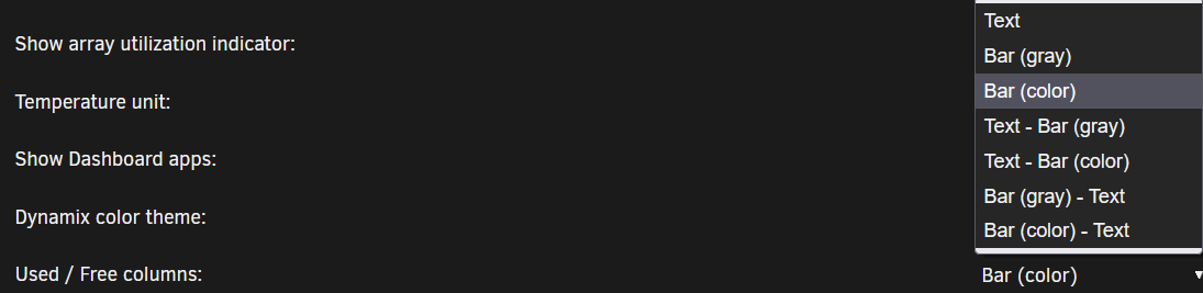

None of my screens shots show green? To be more precise and exact I'm talking about how much storage is being used or free is colored gray instead of green
That's a setting I think : Settings / Display Settings / Used/Free columns
o, I'm sorry. I thought I meant something went wrong. id didn't change that setting. must be a new default
