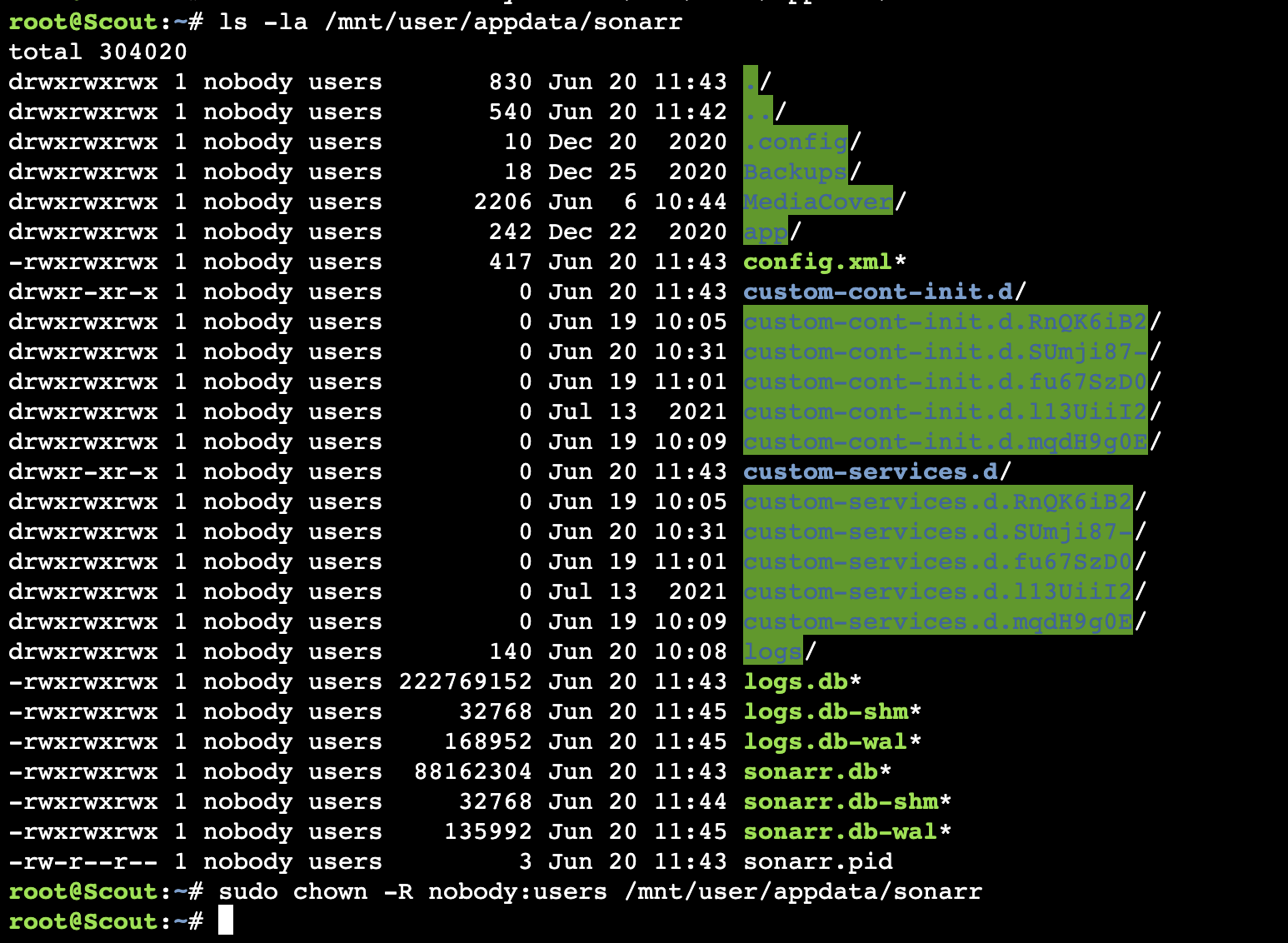

When I run the suggested command
ls -la /mnt/user/appdata/<container>
I get the following: 1693182483_ScreenShot2022-06-20at11_46_13AM.thumb.png.c9b5f893c124e1ccd541dfc75e919c30.png
But that doesn't seem to change anything on the Sonarr side.

On 6/19/2022 at 11:09 AM, drogg said:
New Permissions on the appdata folders
FYI, never do this - it's why docker safe new permissions exists to stop people from doing this.
