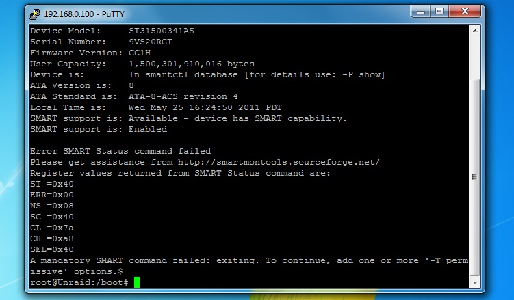

Ok so the replacement drive finished rebuilding and it works great. Just wondering I'm trying to preclear the failed drive to see if it fixes it but I keep getting an error. The error says a mandatory smart command failed I have attached a picture below. Does this mean the drive is officially no good or whats going on. Thanks

Can you get a "smartctl" report on the drive?
does it respond to an "hdparm" command?
smartctl -a /dev/sdX
hdparm -I /dev/sdX
can you get it to show you the partitioning using fdisk?
fdisk -l dev/sdX
can you read it using "dd"
dd if=dev/sdX count=1 | od -c
If they all fail, the disk has probably seen its better days.
Joe L.

Do you want me to enter all those in command prompt and Im currently pre clearing 2 other drives this wont effect them at all correct.
ok it fails the tests so the drive is no good. Can I pull the drive while the system is on or do I have to wait until its off. I currently have 2 pre-clears running so that will be in about 24 hours.
to be safe, wait.    if you do not yet have any drives assigned to the unRAID array, and the array is not started, you can probably unplug.
On the other hand, are you sure it is the drive and not a loose cable (power or SATA), a bad cable (power or SATA), or a bad disk controller port?  All could give the same symptoms.
yes im sure its not a lose cable as its in a different slot than before and it still has the same errors.
that would rule out a bad cable...  Sorry your disk has died, but that is why we have unRAID arrays.
