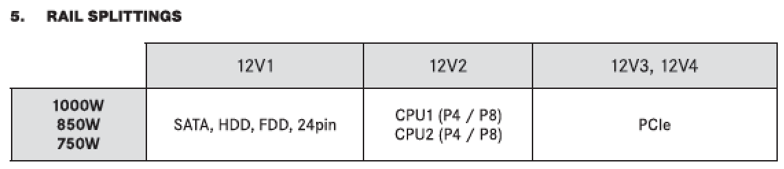

That says it has 4 12V rails. The power is split between those and disks only get 1 of the 4
That was my read as well... So even if I use a seperate cable it will not isolate the one drive from the external bays.
