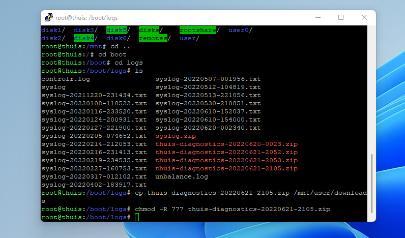

Huh.  OK, if you look on the flash drive you should see a "logs" directory, and the file will be inside it.
i can see them when i ssh in to the machine and go to the boot directory and then logs
the new logs are red and not openable.

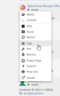

Also none of the log functions work neither,
image.png.0124695904362a935ea8a160dc121ad5.pngimage.png.e12f634c4521d9ec97ce18dc3d411e43.png
They all just show a little popup, blank, and then it closes in 3 seconds.

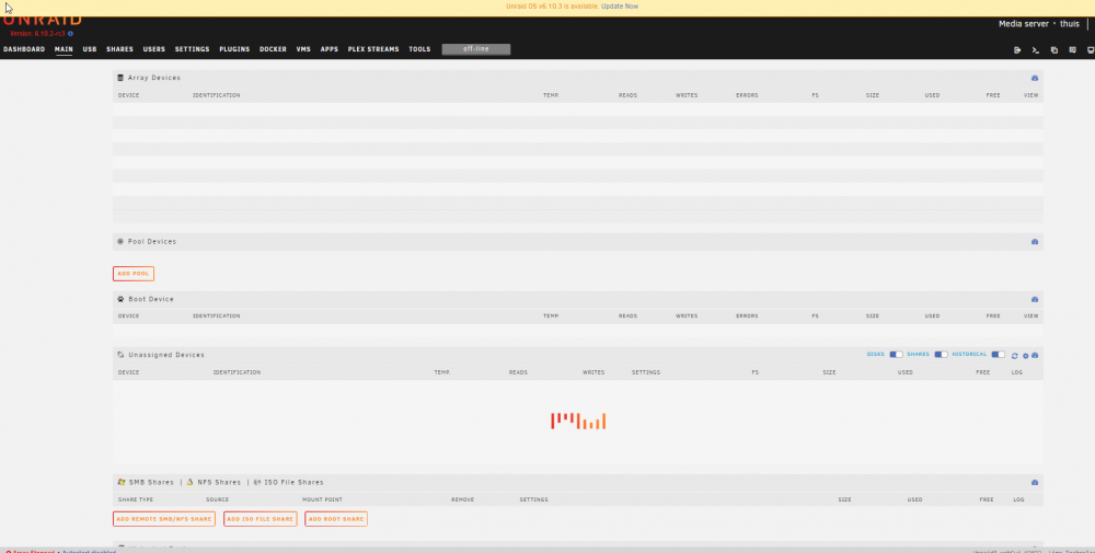

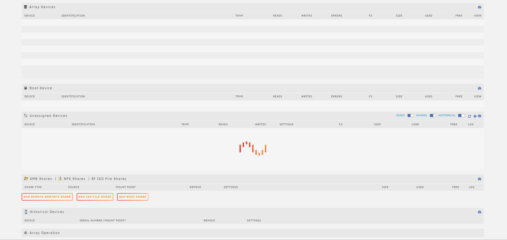

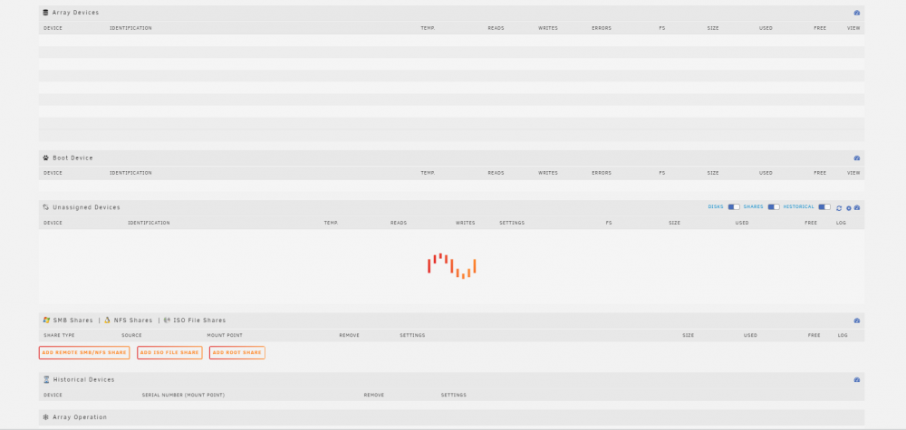

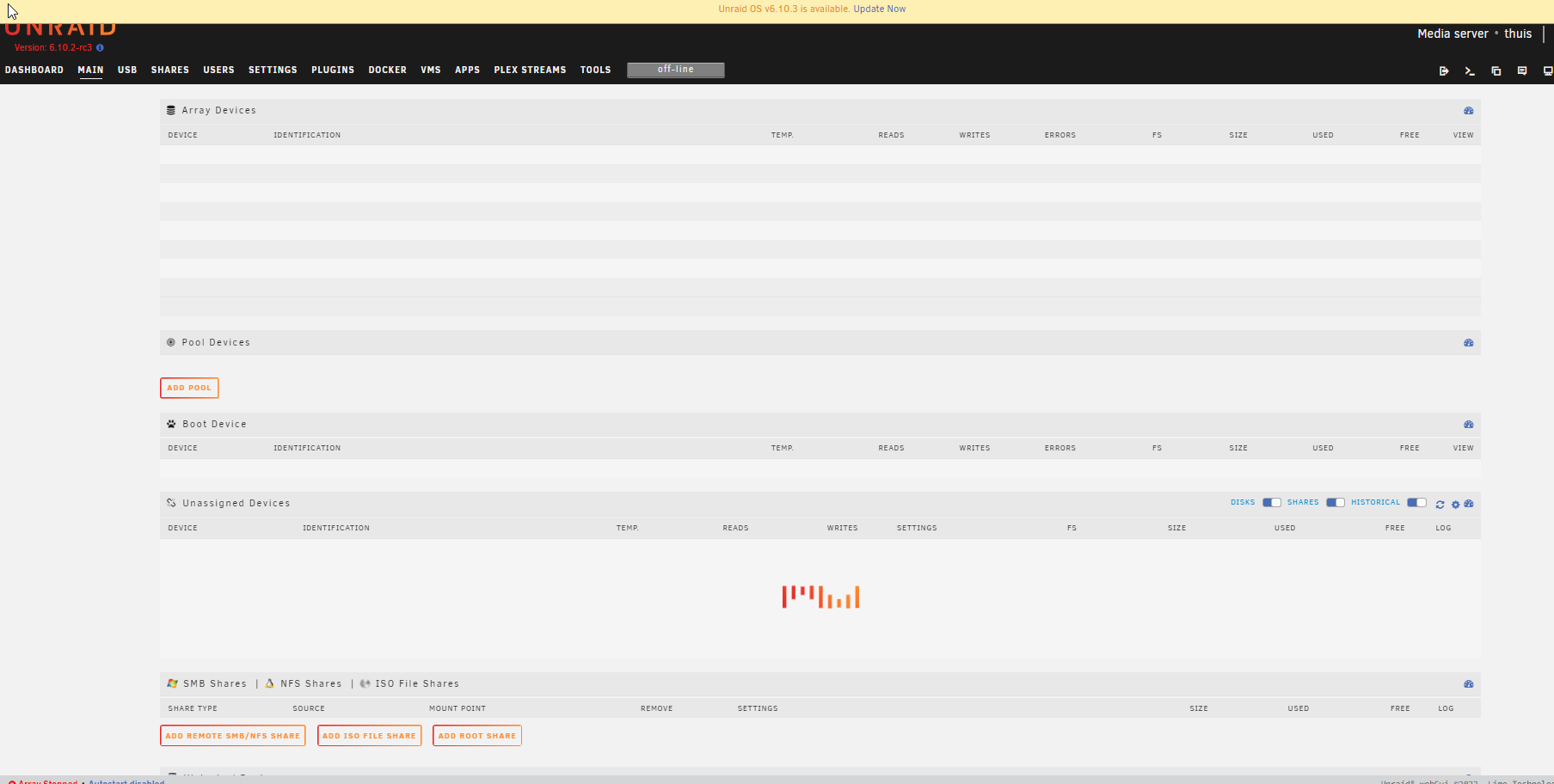

Now my array isn't starting, and i cant see no drive no flash in main tab.
See picture:
so i am kind of lost,
any help is much appriciated.
** I cant download the diagnostic files, as the webgui wont let me, also cannot turn on syslog, stickin the usb flash drive in computer gives back corrupted zip files**
