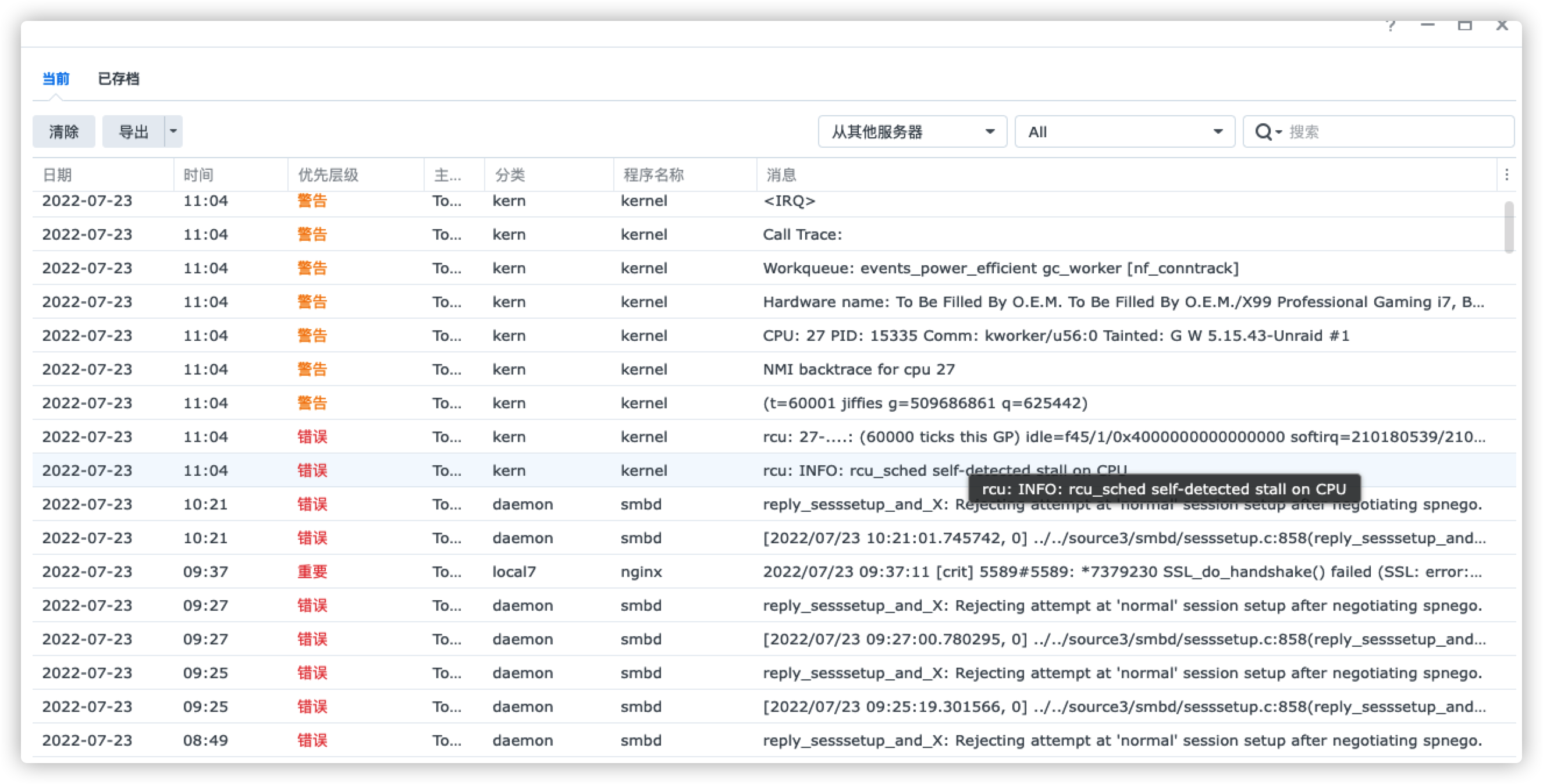

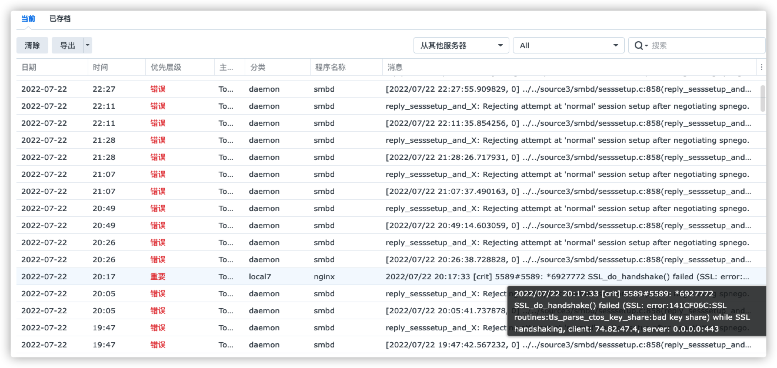

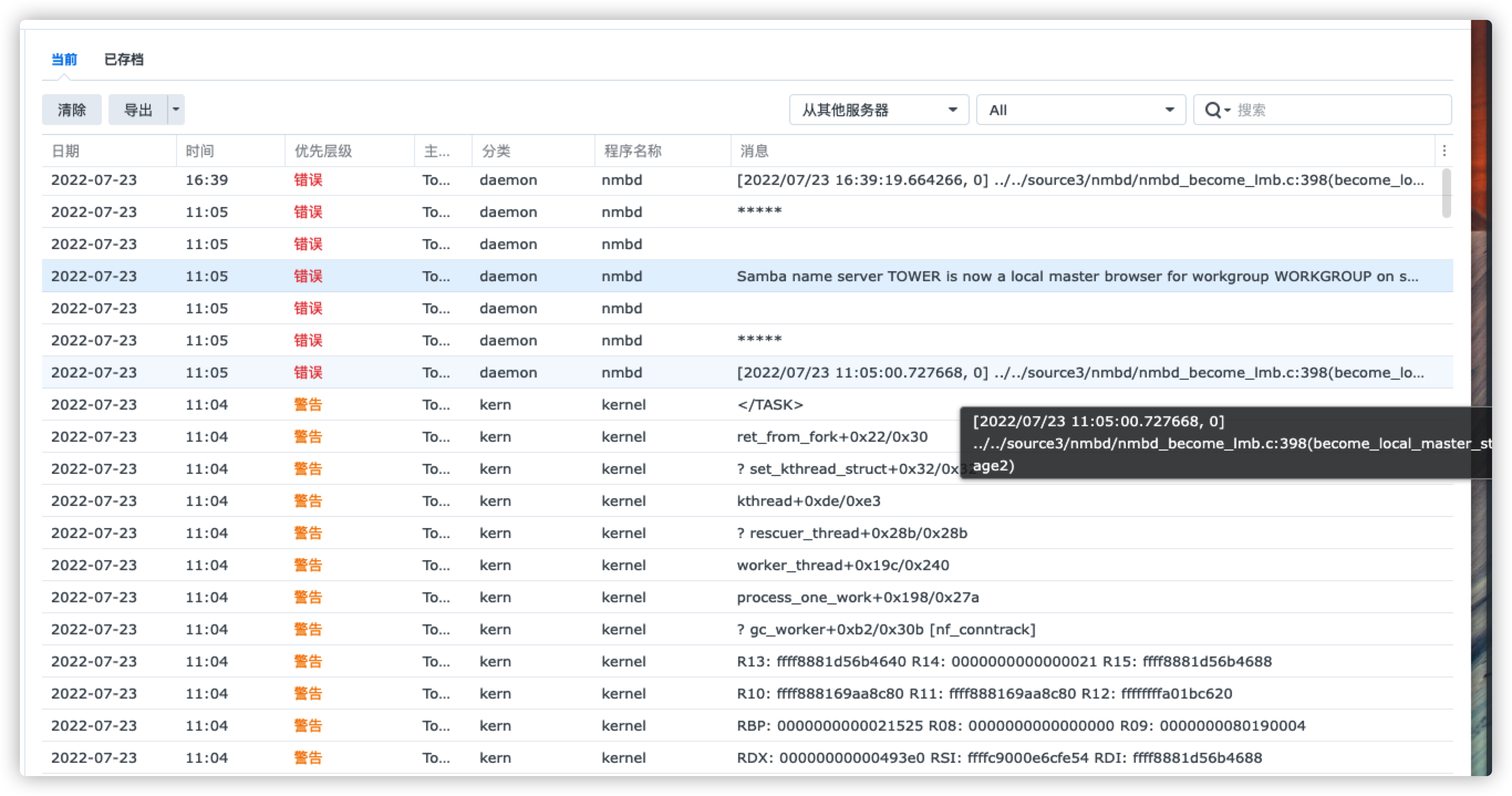

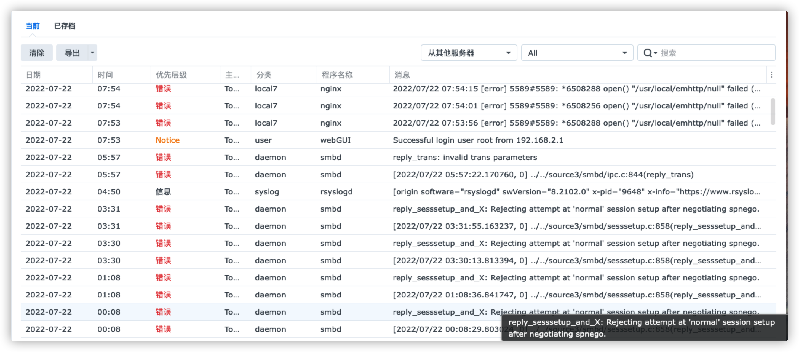

July 23, 20224 yr Author I saved the logs from before the server became inaccessible to Synology. These are screenshots. Can you tell where the problem is? Thanks a lot! It looks like it's been out of whack since 00:00 last night. It dropped completely at 11:00 today. I had to restart the server at 4:30 this afternoon. Edited July 23, 20224 yr by binghunlong

July 31, 20224 yr Community Expert Jul 24 16:15:09 Tower kernel: macvlan_broadcast+0x116/0x144 [macvlan] Jul 24 16:15:09 Tower kernel: macvlan_process_broadcast+0xc7/0x110 [macvlan] Macvlan call traces are usually the result of having dockers with a custom IP address, switching to ipvlan should fix it (Settings -> Docker Settings -> Docker custom network type -> ipvlan (advanced view must be enable, top right)), or see below for more info. P.S. if you haven't yet you should also update to v6.10.3
