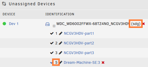

From the UNRAID GUI, identify the sdx of your UniFi drive. This is easy if you have Unassigned Devices installed
If you do not have Unassigned Devices installed, you can enter "fdisk -l" and look for a drive with 4 partitions under type "Linux filesystem" and take note of the last/largest partition.

Based on the "5" from Unassigned Devices and the "sdg" drive ID, (or shown from fdisk), the video partition location is /dev/sdg5
