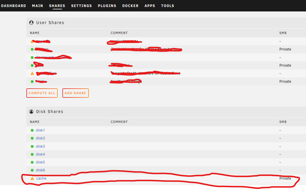

Are you sharing the cache drive?  See below for an example of a Disk Share rather than a User Share:
IF you are, make sure that you are looking at the User Share and not the Disk Share.  The Disk Share of the cache will only show the files that are physically on the cache drive.
EDIT: You have solved this problem.
