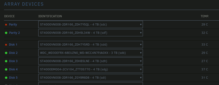

I just noticed that 3 of my disks had errors and that 2 of them were in the "disable" state.
On top of that one of the two disks has the following error: "Unmountable: Wrong or no file system".
I have restarted my server in "safe mode" and I don't know what to do. The last time I had the case of a disk with errors and disable status I had to replace it, but now it's 2 disks at the same time which seems strange.

Looks like disk1 didn't mount, and parity and disk1 are disabled. You must have rebooted after that happened since nothing in syslog to tell how it happened.
Both of those disks look OK. Connection problems are much more common than bad disks. Do any of your disks have SMART warnings on the Dashboard page?

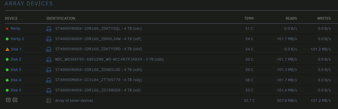

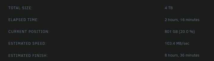

I switched to MAINTENANCE MODE and removed then added disk 1. I then launched the SYNC. The disk is being rebuilt with normal speed.
If the first disk rebuilds properly, I would do the same with the second.
