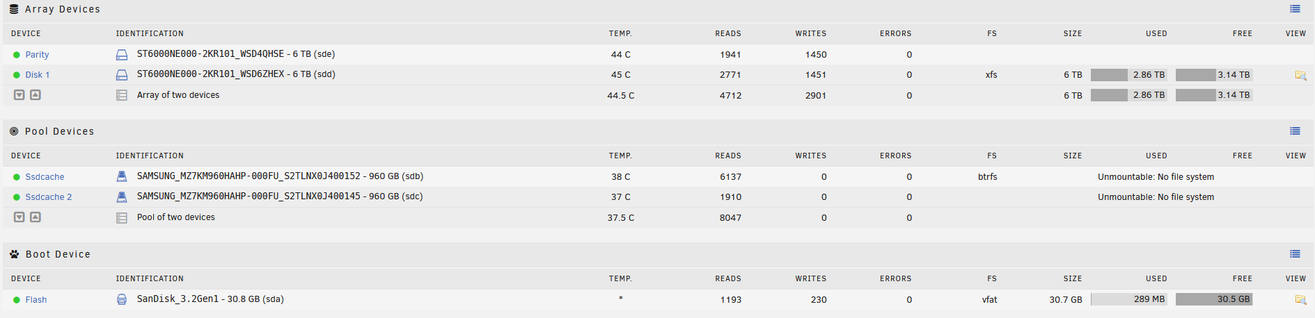

I run Unraid for a couple of months now, the server is often down and powred on via wol when needed. Yesterday I recognized that my VMs couldn't start. The reason: they're on ssdcache only and both SSDs are in state "Unmountable: No file system" 😲
Diagnostics: kunraid-diagnostics-20220706-2215.zip
Array and Pool: 1867123327_2022-07-0622_41_16-kunraid_Main.thumb.png.3cfffd7f340e549ca2c2d692d19dfd59.png

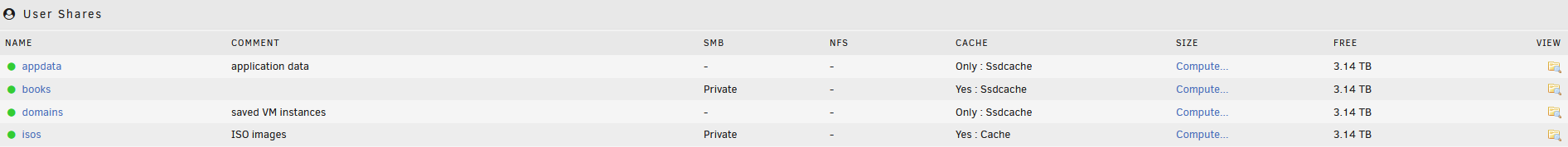

Shares (part):
909352288_2022-07-0622_47_49-kunraid_Shares.thumb.png.b24f7c6060d851ddca675a13338dc882.png
Any hint where to start to get this fixed?

Jul  6 21:38:14 kunraid kernel: BTRFS: device fsid 0ecc5969-4afc-4b9a-a299-3fab30cf63d9 devid 1 transid 153079 /dev/sdb1 scanned by udevd (1244)
Jul  6 21:38:14 kunraid kernel: BTRFS: device fsid 0ecc5969-4afc-4b9a-a299-3fab30cf63d9 devid 2 transid 147224 /dev/sdc1 scanned by udevd (1234)
devid 2 is on an older generation than devid 1, this can sometimes fix it:
btrfs-select-super -s 1 /dev/sdc1
If you rebooted since the diags check that ssdcache2 is still sdc, then reboot and if it still doesn't mount post new diags.
