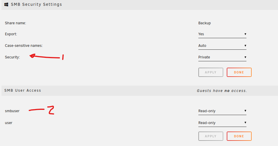

February 6, 20242 yr Community Expert 10 minutes ago, guruhiten said: I was able to log into that share - I still don't have full access to the server like I did (still not sure what changed) but it's a work around if you need to access certain shares. CRAP! I forgot one thing! Go to SHARES Then Click on each share tyou want to access with that user (that yoiu setup in the previous post: Scroll down until you find these sections: Step 1 --- Set the Security you want for this share. (You can click on "HELP" icon on the GUI taskbar for help with the settings!) Step 2-- Set the Access for that share for each user. Step 3-- Click "APPLY"
February 7, 20242 yr 1 hour ago, Frank1940 said: CRAP! I forgot one thing! Go to SHARES Then Click on each share tyou want to access with that user (that yoiu setup in the previous post: Scroll down until you find these sections: Step 1 --- Set the Security you want for this share. (You can click on "HELP" icon on the GUI taskbar for help with the settings!) Step 2-- Set the Access for that share for each user. Step 3-- Click "APPLY" Thanks, I had already set that up as Secure. I tried private, but that reverted back to me not being able to access the share.
